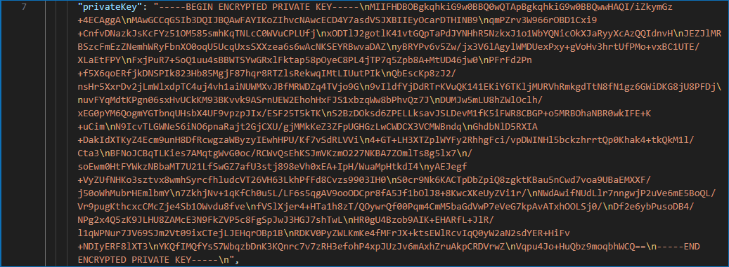

The formatting of the private key in the JSON file is incorrect. Refer to the following example:
private key example
The private key contains multiple \n entries that represent line breaks.
Resolution
Replace the \n entries with carriage returns symbols. Refer to the code block below for an example:
