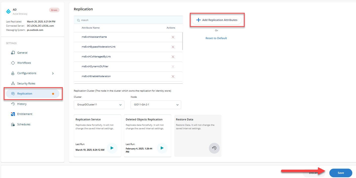

  1. Open the Identity Stores tab in the Netwrix Directory Manager Admin Center and click Edit under the ellipses menu on the appropriate Identity Store card.
  2. On the Replication tab, click Add Replication Attributes and add the required attributes.
    Replication attribute screenshot

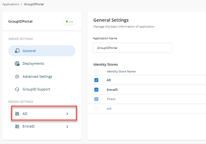

  3. Click Settings. A new page will appear.
    Portal settings screenshot
  4. Select the appropriate Identity Store.
    Identity Store selection screenshot
  5. Under the Properties tab, select Group from the Select Directory Object list.
  6. Select Advanced in the Name list and click the Pencil icon.
    Advanced group design

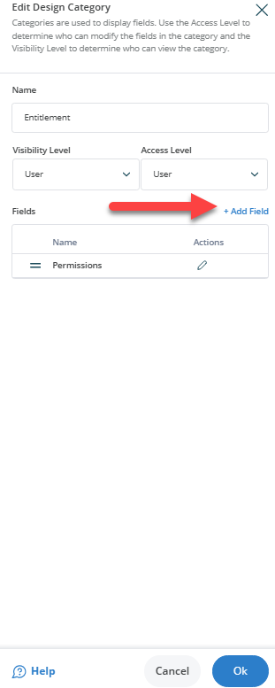

  7. On the Edit Design Category dialog box, click Add Field.
    Add Field screenshot

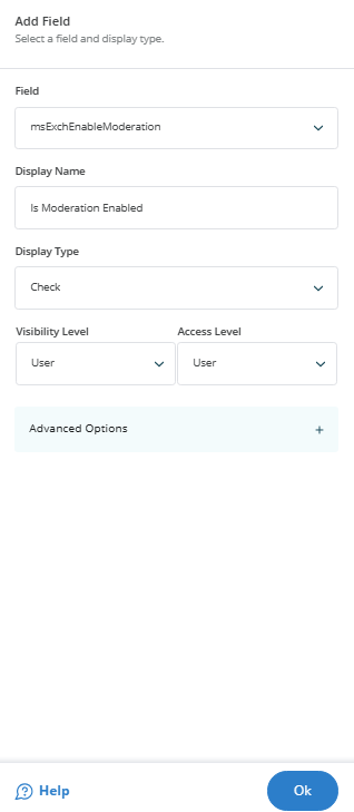

  8. Select mxExchEnableModeration from the Field list, enter the display name as Is Moderation Enabled and set the display type to Check.
  9. Click OK and then click Add Fields again.

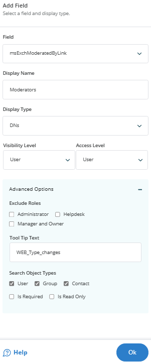

  10. Select mxExchModeratedByLink, enter the display name as Moderators, and set the display type to DNs.
  11. Click OK and then click Add Fields again.

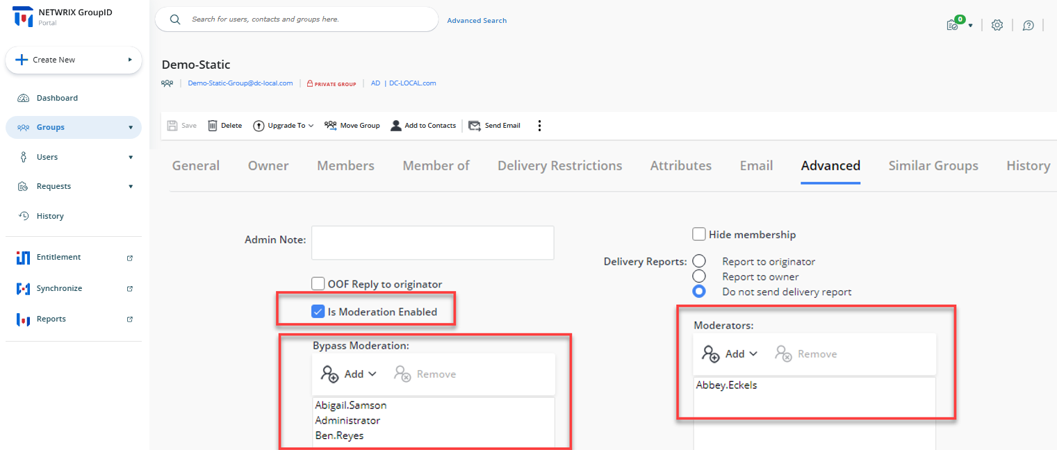

  1. Launch the Netwrix Directory Manager Portal. The new attributes should appear under the Groups tab under Advanced.
Final portal attributes screenshot
