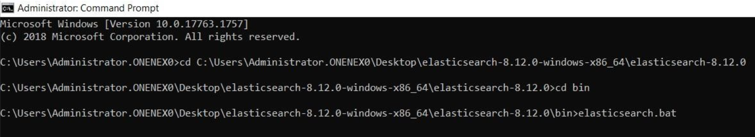

  1. Install Elasticsearch on a separate machine by downloading the latest version from the official website.
  2. Extract the package and open CMD.
  3. Navigate to the bin directory and run elasticsearch.bat.
    Steps 1-3 in CMD
