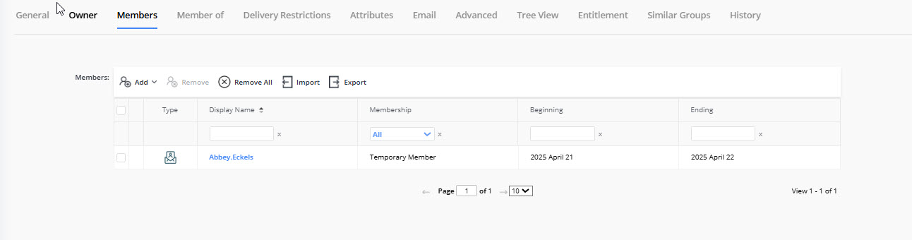

  1. In the Directory Manager Portal, search for the group whose member's membership type you want to change.
  2. Select the group on the Search Results page and click Properties on the toolbar. The Members tab in group properties lists the group members.
  3. To change a member's membership type, click anywhere in the respective row to make it editable. Select Temporary Member from the Membership column then specify the membership period using the Beginning and Ending fields. Other membership options are described in the table above.
Editing membership type and period for a group member in Directory Manager
