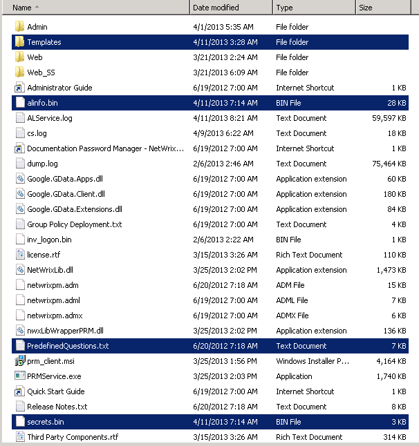

Prior to upgrade backup the following files from the product installation directory (on backend in case of DMZ setup). This is done for emergency and normally these files will not be required later.
  • alinfo.bin
  • secrets.bin
  • Predefined Questions.txt
  • Templates folder
User-added image
