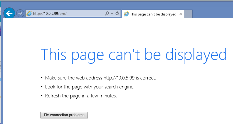

Issue 1: Portals never load — just stay blank in loading state
User-added image
Explanation: Refer to the KB1315

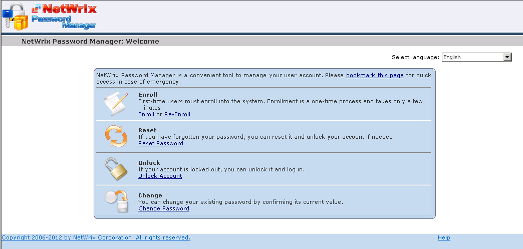

Issue 5: Admin and Helpdesk portals work, but Self-service returns an error or does not load at all
User-added image
Explanation: Refer to the KB1303.

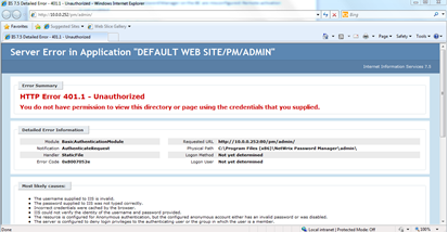

Issue 6: Self-Service portal works fine but you get a 401 - Unauthorized error on Admin and Helpdesk portals
User-added image
Explanation: You need to use accounts that the front-end is aware of and which have appropriate rights on the front-end server. Refer to the KB1368 in case of a non-domain front-end.
