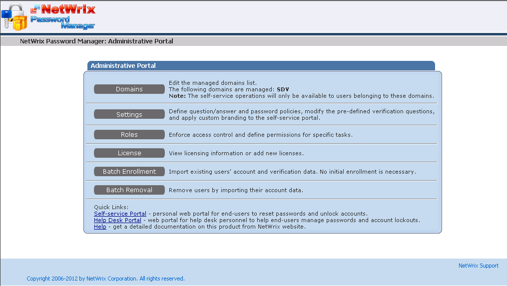

User-added image
However Admin and Helpdesk portals work.
User-added image

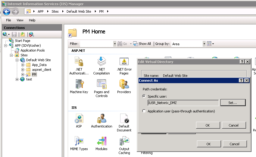

When you log in to the Admin or Helpdesk portal, the portal prompts for credentials and then uses those credentials to communicate with the back-end once authentication is complete. The Self-Service portal uses anonymous authentication and, as a result, uses the account specified in IIS at Connect as:
User-added image
The issue occurs when the account specified for anonymous authentication in Connect as does not have the required permissions on the back-end server.

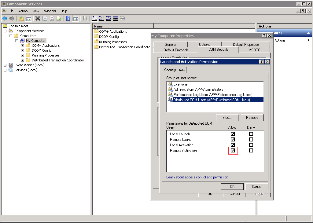

Make sure that COM settings on the back-end server are correct:
  1. Ensure COM Security properties for the My Computer node allow Remote activation.
    User-added image
