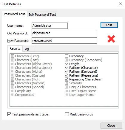

You can quickly test your Password Policy Enforcer configuration by simulating a password change from the Password Policy Enforcer management console.
Password Test
Follow the steps below to test your configuration.
Step 1 – Click the Policies item to display the Policies view.
Step 2 – Click Test Policies in the right pane of the management console.
passwordtest
Step 3 – Select the Password Test tab.
Step 4 – Type a user name in the User name text box, and a password in the Old Password and New Password text boxes.
Step 5 – Click Test, or wait a few seconds if Test passwords as I type is selected.
NOTE: Policy testing simulates a password change, but it does not change the password. As it is only a simulation, you do not have to enter the correct password in the Old Password text box.
The Password Policy Enforcer management console displays a green check mark below the Test button if the new password complies with the Password Policy Enforcer password policy, or a red cross if it does not comply. Detailed test results appear in the results panel.
Step 6 – Click the Results tab to view the test results for each rule. The check boxes show which rules the new password complied with.
RuleStatus of Password Compliance with Rule
testing_the_password_policy_1Rule disabled or not tested.
testing_the_password_policy_2Rule enabled, password complies with rule
testing_the_password_policy_3Rule enabled, password does not comply with rule.
managing_policies_12
Step 7 – Click the Log tab to view Password Policy Enforcer's internal event log. The event log can help you to understand why Password Policy Enforcer accepted or rejected a password. For example, you can use the event log to see which:
  • Computer the configuration was read from.
  • Policy was assigned to the user, and why.
  • Dictionary word or keyboard pattern matched with the password.
  • Errors or warnings occurred during testing.

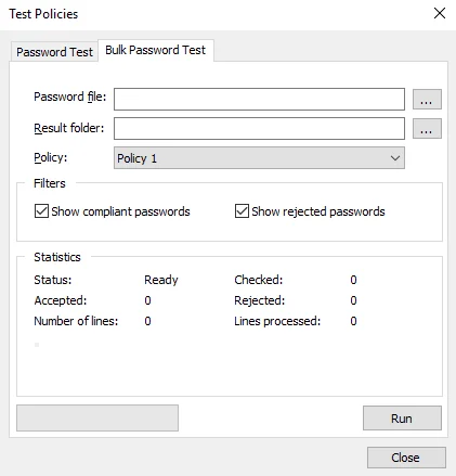

Bulk Password Test
Bulk Password Test feature allows to check a large number of passwords against a selected policy and a get a report of the accepted and rejected passwords.
bulkpasswordtest
Step 3 – Select the location of the password file.
Step 4 – Select the location of the folder where you want to upload the result.
NOTE: It is recommended that the Password File and Result folder are not located on a shared drive, so the processing can be done faster.
Step 5 – Select a desired policy from the drop down list.
Step 6 – If you want to receive a list of unacceptable passwords, you should use the following filters:
  • Show compliant passwords – the compliant passwords will be displayed.
  • Show rejected passwords – the rejected passwords will be displayed.
Step 7 – Click the Run button.
Statistics allows you to see the file line size, the number of passwords processed, and the result of processing each line. Click on the desired filters to show compliant and/or rejected passwords.
Statistics of the Bulk Password Testing
StatusShows whether the operation is ready for scanning, processing, or whether the scan has been terminated.
AcceptedShows the number of the accepted passwords.
Number of linesShows the number of lines within the password.
CheckedShows the number of the checked passwords.
RejectedShows the number of the rejected passwords.
Lines processedShows the number of the processed lines.
