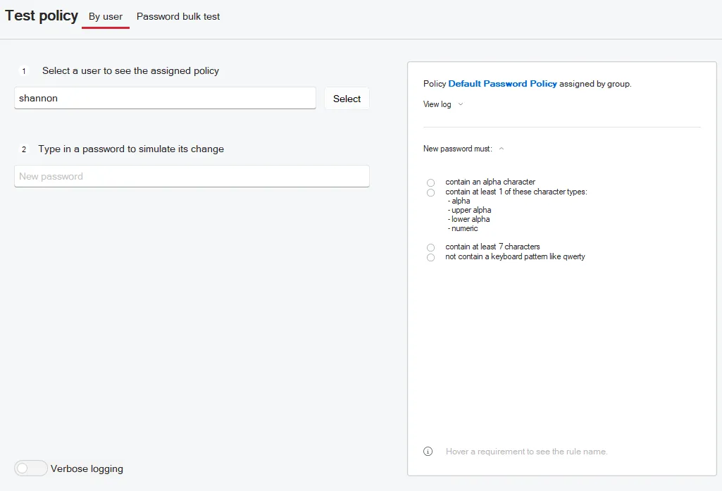

Test policy opens on the By user tab.
Test by User
By User
Policy testing simulates a password change, but it does not change the password.
Step 1 – Click Test policy from the Configuration Console dashboard or when you are setting up a policy.
Step 2 – Select a user.

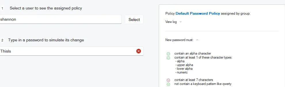

Step 3 – Type in a password to simulate its change. As you type, the new password is evaluated and the results are displayed.
Failing Password
The entered password is failing in this example, due to not meeting the length requirement. There is a red x indicating the failure. You can hover over the requirements to see the rule name.

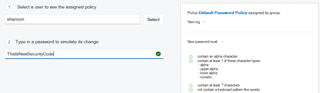

In this example, the password passes. Notice the green check beside the entered password.
Passing password

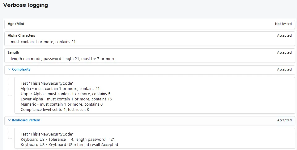

Turn on Verbose Logging to view the performed tests and results.
Verbose logging

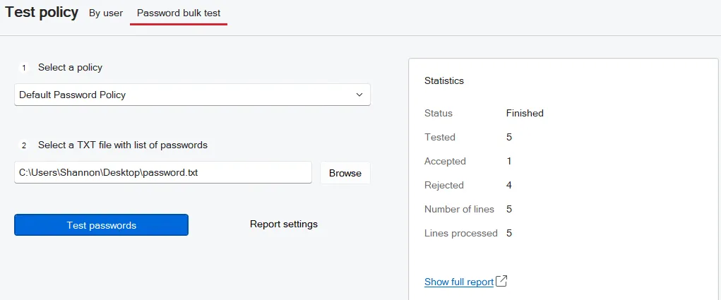

Step 2 – Open the Password bulk test tab.
Password bulk test
Step 3 – Select a policy for the test.
Step 4 – Browse to the text file containing the passwords to test. Processing is faster if the file is not on a shared drive.
Step 5 – Click Test passwords. The Statistics are displayed.
Test results
Statistics of the Bulk Password Testing
StatusShows whether the operation is ready for scanning, processing, terminated, or finished.
TestedNumber of tested passwords.
AcceptedNumber of accepted passwords.
RejectedNumber of rejected passwords.
Number of linesNumber of lines within the file.
Lines processedShows the number of the processed lines.

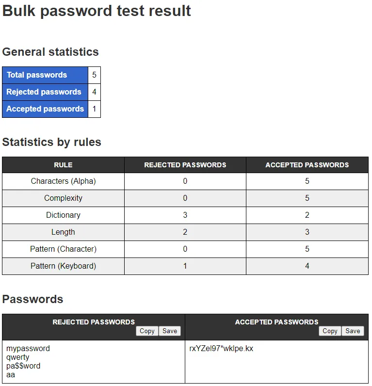

Click Show full report to view the test details.
Test Bulk Report
You can use the Report settings to customize the report:
  • Result report folder. Processing is faster if this is not a shared drive.
  • Show accepted passwords
  • Show rejected passwords
