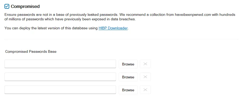

The Compromised rule rejects passwords from prior breaches. These passwords should not be used as they are vulnerable to credential stuffing attacks.
Compromised password rule
Select the Compromised check box to enable the Compromised rule.
You can browse to your compromised passwords base files or type a path into the text box. The path can contain environment variables like
CAUTION: %SystemRoot%. hash files should only be read from a local disk. Using shared hash files degrades performance, and could jeopardize security.
See the HIBP Updater topic for the information about the Have I Been Pwnd (HIBP) database usage.
