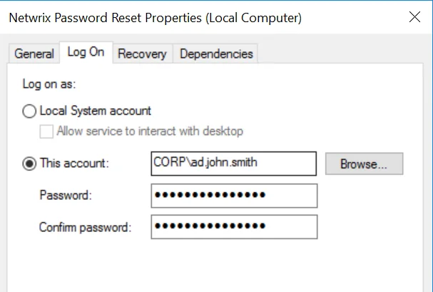

Step 2 – Create an SQL Server login for the Password Reset service account, and configure it for Windows authentication. To identify the service account, open services.msc, double-click the Password Reset service, and then click the Log On tab. Password Reset logs on to SQL Server with this account.

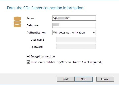

Step 7 – Set the SQL Server connection settings for the Data Copy wizard. You can set different connection settings for the service account later. The Username and Password are only needed if SQL Server Authentication is selected. The user must be in the db_datareader, db_datawriter, and db_ddladmin SQL Server roles. Encrypt connection should be selected to protect user information, and Trust server certificate must be selected if SQL Server is using a self-signed certificate. SQL Server uses a self-signed certificate if a trusted certificate is not installed. The SQL Server Native Client must be installed if Trust server certificate is selected.
