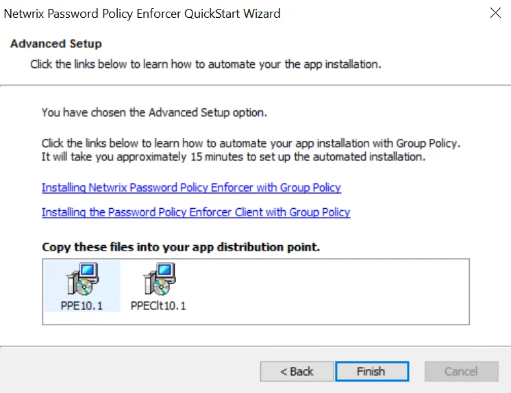

Step 1 – Start the Password Policy Enforcer installer (PPE912.exe).
Step 2 – Read the license agreement, and then click Yes if you accept all the license terms and conditions.
Step 3 – Select the Advanced option, and then click Next.
Step 4 – Right-click the PPE912.msi icon, click Copy, and then paste the file into the distribution point.
Step 5 – Give the Domain Controllers security group read access to the PPE912.msi file in the distribution point.
Step 6 – Click Finish.

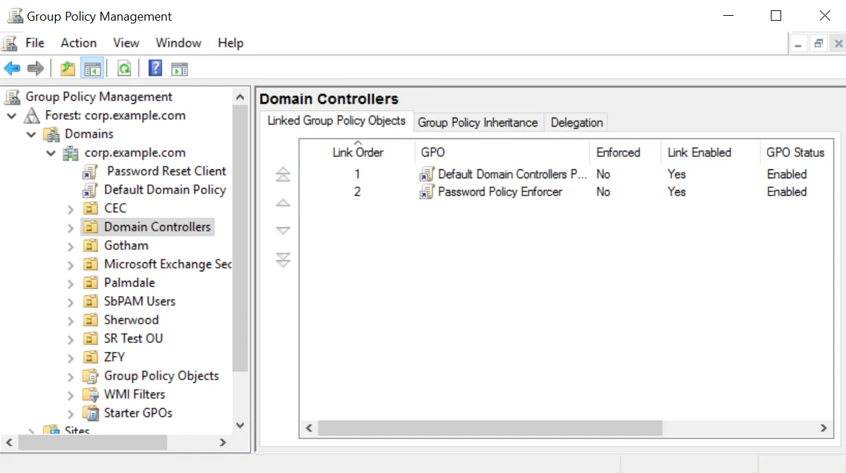

Create a Group Policy Object
Step 1 – Start the Group Policy Management Console (gpmc.msc).
Step 2 – Expand the forest and domain items in the left pane.
Step 3 – Right-click the Domain Controllers OU in the left pane, and then click Create a GPO in this domain, and Link it here...
Step 4 – Enter Password Policy Enforcer in the provided field, and then press Enter.

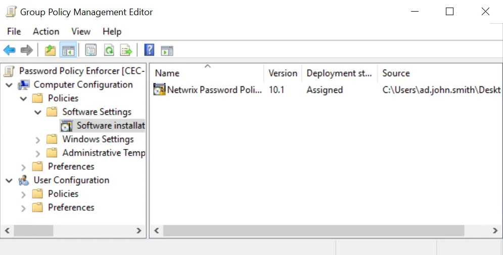

Step 1 – Right-click the Password Policy Enforcer GPO, and then click the Edit... button.
Step 2 – Expand the Computer Configuration, Policies, and Software Settings items.
Step 3 – Right-click the Software installation item, and then select New > Package...
Step 4 – Enter the full UNC path to PPE912.msi in the Open dialog box.
NOTE: You must enter a UNC path so that other computers can access this file over the network. For example: \file server\distribution point share\PPE912.msi
Step 5 – Click Open.
Step 6 – Select the Assigned deployment method, and then click OK.
Step 7 – Close the Group Policy Management Editor.

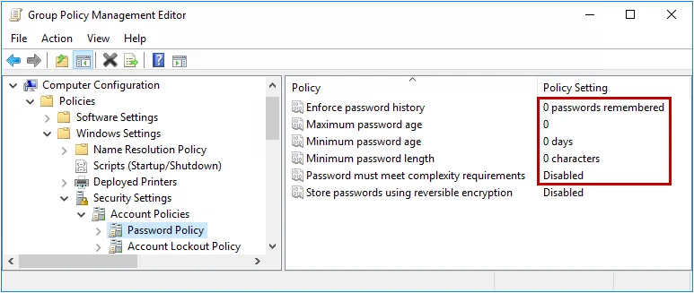

Follow the steps below to disable the Windows password policy rules:
Step 3 – Right-click the Default Domain Policy GPO (or whichever GPO you use to set your domain password policy), then click Edit...
Step 4 – Expand the Computer Configuration, Policies, Windows Settings, Security Settings, Account Policies, and Password Policy items.
Step 5 – Double-click Enforce password history in the right pane of the GPO Editor.
Step 6 – Enter 0 in the text box, then click OK.
Step 7 – Repeat the step above for the Maximum password age, Minimum password age, and Minimum password length policies.
Step 8 – Double-click Password must meet complexity requirements in the right pane.
Step 9 – Select the Disabled option, and then click OK.
Step 10 – Close the Group Policy Management Editor.
NOTE: You do not have to disable all the Windows password policy rules to use Password Policy Enforcer. You can use a combination of Password Policy Enforcer and Windows rules together if you like. Just remember that a password is only accepted if it complies with the rules enforced by both Windows and Password Policy Enforcer.

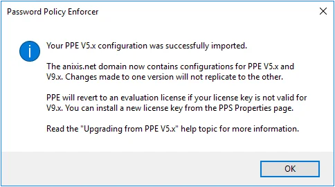

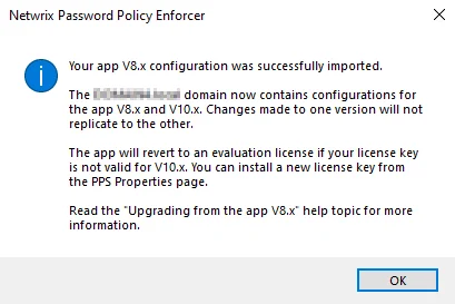

Open the Password Policy Enforcer V9.12 management console immediately after upgrading to automatically import the V8.x configuration settings into the new version.
The management console imports valid subscription license keys, but it will not import V8.x perpetual license keys as they cannot be used with Password Policy Enforcer V9.12. Password Policy Enforcer will revert to a 30-day evaluation license if it cannot import the license key. Open the PPS Properties page page after an upgrade to check your license details. See the Configuration topic for additional information.
You can run a combination of V8.x and V9.x Password Policy Servers, but extended use of both versions is not recommended as it adds administrative overhead. Maintain both versions only for a short time while you roll out Password Policy Enforcer V9.x.
NOTE: Any configuration changes made from the V9.12 management console will only affect V9.x domain controllers. Likewise, any changes made from the V8.x management console will only affect V8.x domain controllers. You must make configuration changes in both management consoles until all domain controllers are upgraded to V9.x. Failure to do so may lead to inconsistent enforcement of the password policy.

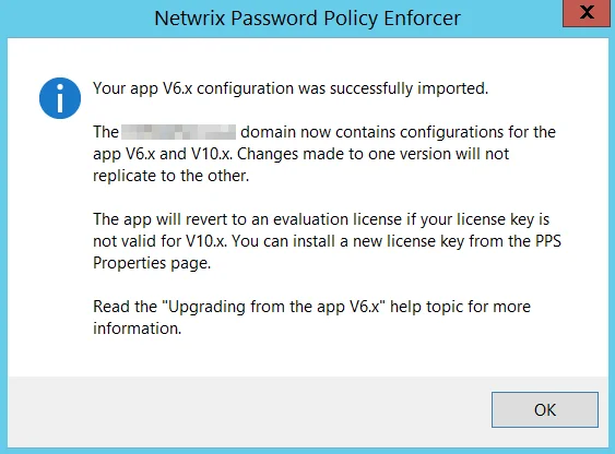

Open the Password Policy Enforcer V9.12 management console immediately after upgrading to automatically import the V6.x configuration settings into the new version.
The management console imports valid subscription license keys, but it will not import V6.x perpetual license keys as they cannot be used with Password Policy Enforcer V9.12. Password Policy Enforcer will revert to a 30-day evaluation license if it cannot import the license key. Open the PPS Properties page after an upgrade to check your license details. See the Configuration topic for additional information.
You can run a combination of V6.x and V9.x Password Policy Servers, but extended use of both versions is not recommended as it adds administrative overhead. Maintain both versions only for a short time while you roll out Password Policy Enforcer V9.x. If you are using Password Policy Enforcer's Maximum Age rule and would like to enable the new extended maximum age feature for long passwords, then you must first upgrade the domain controller holding the PDC emulator operations master role to Password Policy Enforcer V9.x. See the Rules topic for additional information.
NOTE: Any configuration changes made from the V9.12 management console will only affect V9.x domain controllers. Likewise, any changes made from the V6.x management console will only affect V6.x domain controllers. You must make configuration changes in both management consoles until all domain controllers are upgraded to V9.x. Failure to do so may lead to inconsistent enforcement of the password policy.
