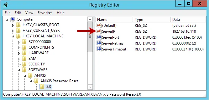

Step 10 – Start the Registry Editor (regedit.exe).
Step 11 – Expand the HKEY_LOCAL_MACHINE, SOFTWARE, ANIXIS, ANIXIS Password Reset, and 3.0 registry keys.
Step 12 – Set the ServerIP registry value to the IP address of the computer that you installed the Password Reset Server onto.

Step 1 – Start the Registry Editor (regedit.exe).
Step 2 – Expand the HKEY_LOCAL_MACHINE, SOFTWARE, ANIXIS, ANIXIS Password Reset, and 3.0 registry keys.
Step 3 – Clear the data in the ServerIP registry value.
Step 4 – Create a REG_SZ value for each Web Interface called ServerIP_VDIR where VDIR is the name of the virtual directory.
For example, if the virtual directory is called Finance, then the registry value should be called ServerIP_Finance.
Step 5 – Set each ServerIP_VDIR value to the IP address of the Password Reset Server.
