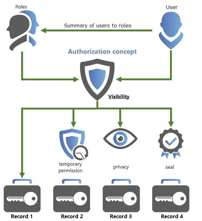

The following diagram shows a summary of how the existing protective mechanisms are integrated into the authorization concept.
protective mechanism diagram
In the interplay of the Authorization and protection mechanisms, almost all conceivable scenarios can be depicted. It is worth mentioning again that the authorization concept is already a very effective tool, with limited visibility of passwords and data records. This concept is present everywhere in Netwrix Password Secure, and will be explained in more detail below.

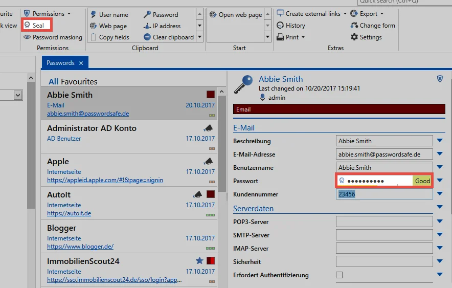

1. Requesting a release
In order to release a seal for sealed passwords, this must be requested from the user with the required permissions to issue the release. Within the Netwrix Password Secure client, this can be done via the buttons Reveal and Seal in the ribbon, as well as via the Icon in the password field of the data record in the reading pane.
seal protection
A modal window opens, which can be used to request the seal. The reason for the entry will be displayed to the users with the required permissions to issue the release.

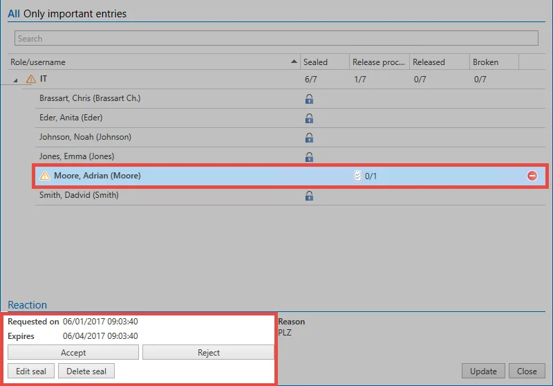

2. Granting a release
The Seal overview can be opened via the seal symbol in the ribbon directly from the mentioned notification. It is indicated by the corresponding icon that there is a need for action. All relevant data for a release are illustrated within the seal overview. The reason given in the release is also evident.
seal overview

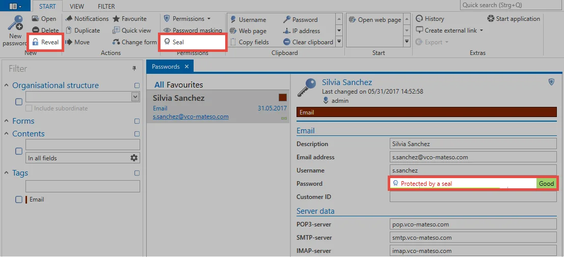

3. Breaking the seal
As soon as the requesting user has received the number of the required releases, he will be informed via the notifications as usual. The seal can now be broken. From this point on, the user will be able to see the password.

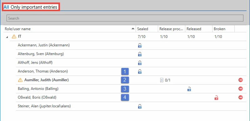

Users with the required permissions to issue the releases receive access to the current state of the existing seals at any time via the seal overview. The overview is accessible via the ribbon as well as the icon in the password field of the reading pane.
button seal
The four states of a seal
The seal overview provides an overview of all users who have access to the sealed data set. This is also the case when they receive the seal on the membership of a role. Functions for editing and removing existing seals are also available. In addition, the current state of the seal is displayed in the form of a release matrix. There are a total of four states, in which a seal can be:
states of seal
1. Sealed
If a data record for a user is sealed, the user is prevented from seeing the password by the seal. This corresponds to the condition when a seal has been newly installed. By resetting a request via the icon at the right edge of the screen, current requests from individual users are also returned to the "sealed" state.
2. Release process
If a user has requested a release, it is in the release process. This status is highlighted by an icon next to the user name, since a possible release can be actively granted by the authorized user. These so-called important entries can also be filtered in the headline of the seal overview in via the column. The maximum duration of an release request can be configured in the advanced seal settings. If the deadline has elapsed without sufficient releases being made, the request is deleted and the state “sealed” is restored.
3. Released
If a release is granted, a seal is approved as released. The maximum duration of a granted release can be limited in the advanced seal settings. The user then has, for example, 24 hours to accept the release and break the seal.
4. Broken
The actual seal breach is obtained by acquiring knowledge of the release and by actively breaking the seal after a security query. Viewing the password is irrelevant. Once broken seals can be manually reset by the icon to the right of the broken seal column. The state “Sealed” is restored.

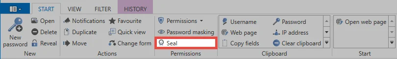

Seal wizard
All seal configurations are performed in the wizard. Both the application of new seals as well as the processing and removing are possible. The current state of a seal can also be viewed in an overview, which is accessible via the button in the ribbon. When the seal wizard is opened via the ribbon, the wizard appears in the case of unsealed data sets, which runs in four steps through the configuration of the seal.

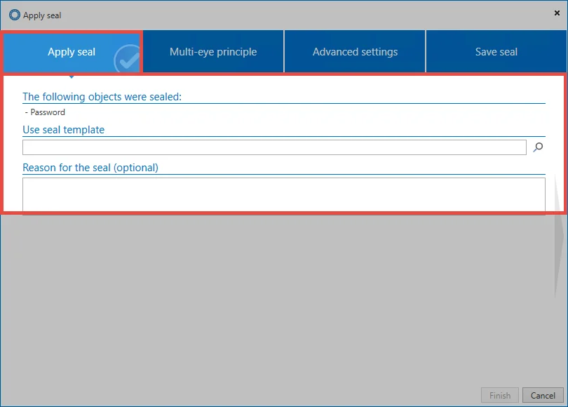

1. Apply seal
multi-eye principe
All objects that are sealed are displayed at the beginning. Depending on the data record, this can be one object, or several. It is also possible to use existing Seal templates. Optionally, you can enter a reason for each seal.

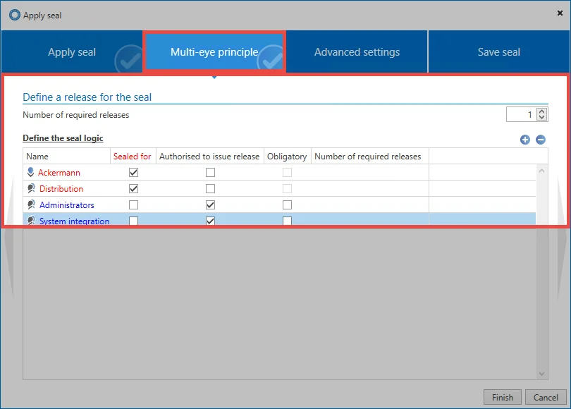

2. Multi-eye principle
The seal logic is the most basic element of this protective mechanism. Here, you define for which users or roles the record should be sealed or released in the future. All those for whom the record is to be sealed are displayed in red, while all users with the required permissions to issue a release are displayed in blue.
example permissions
NOTE: All users and roles for which the data set is not sealed and which are not authorized for release are displayed in green. These can use the data record independently of the seal.

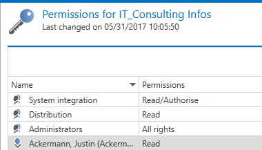

To avoid having to perform any configuration manually, roles and users are copied directly from the authorizations of the data record. Compare with the "permissions" for the record (can be viewed via the ribbon).
example permissions
Supervisors should issue the releases for their employees. Therefore, the checkbox also follows the existing authorizations. The following scheme is used:
NOTE: All users and roles that have the authorize permission to the record are "authorized to issue a release" for the seal by default. All users and roles that do not have the authorize permissions to the record are copied directly into the "Sealed for" column.
Here is a closer look at the permissions of the role Administrators on the record:
example multi-eye principe

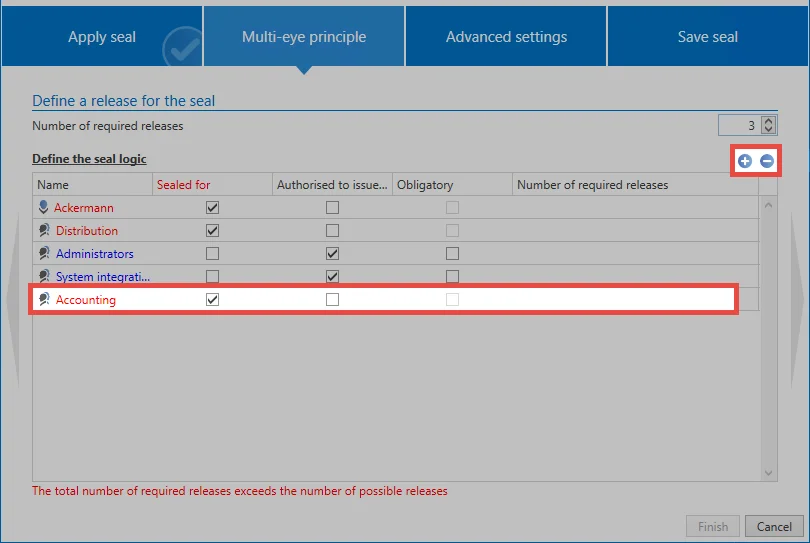

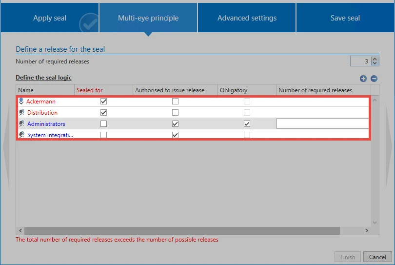

Adjusting the seal logic
Although standard authorizations are used as a basis for the sealing concept, these can be adapted. The number of releases generally required is as configurable as the required number of releases from a role. In the following example, the seal has been extended so that a total of three release authorizations are required in order to release the seal (Multi-eye principle). The role of the administrators has been marked in the mandatory column. This means that it must grant at least one release. In summary: A total of three releases must be made, whereby the group of administrators must grant at least one release.
edit seal
In order to be not only dependent on existing authorizations on the data set, other users can also be added to the seal. The role accounting under "sealed for" has been added below.
define permission for the seal
NOTE: When a role or a user is added to a seal, these users also receive permissions on the record according to the authorization granted in the seal. A role that is added under "Sealed for" receives the Read permission on the record. When you add authorization permissions, these will include the Read, Write, Delete, and Authorize permission.
CAUTION: All the roles that were once added to the seal can no longer be removed via the seal logic. This is only possible directly via the authorizations of the data record!
NOTE: It is possible to seal records for a user who is also authorized to issue a release. In this constellation, it is important to ensure that at least one other user is authorized to issue a release. In principle, you should never be able to issue a release for yourself.

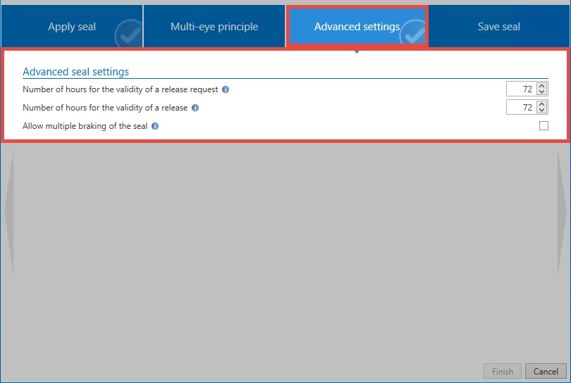

3. Advanced settings
Advanced seal settings allow you to adjust the multi-eye principle. Both the time validity of a release request as well as a granted release can be configured. Multiple break defines whether after the breaking of a seal by a user, other users may still break it.

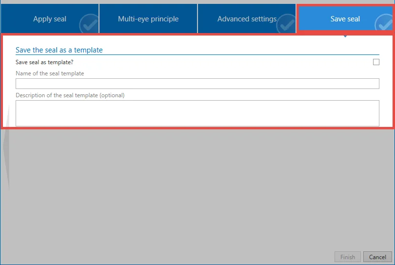

4. Saving the seal
Before closing the wizard, it is possible to save the configuration for later use in the form of a template. Seal templates can be optionally provided with a description for the purpose of overview.
save seal
