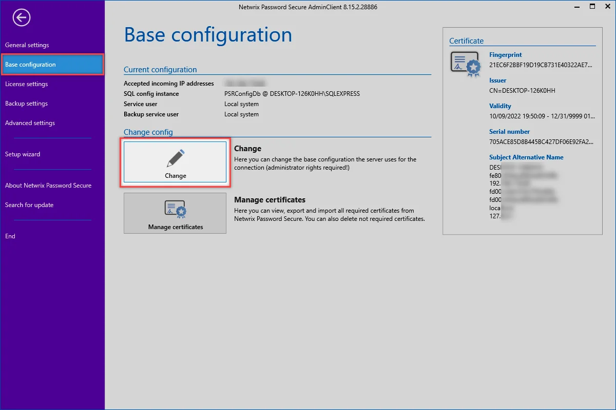

Basic configuration
What is basic configuration?
Within the basic configuration, the connection to the SQL server or to the databases is defined. The basic configuration appears the first time the Server Manager is started and can be called up at any time in the basic configuration.
base configuration

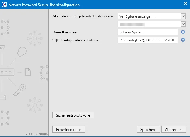

A special wizard is available to carry out the configuration:
Baseconfig
Service address
The service address of the SQL server can be selected via the drop-down menu. It is mandatory to select the adapter via which the Server Manager can also access the SQL server.
The loopback address 127.0.0.1 should not be used here.
Service user
Service user This setting is used to define the service user, which is needed to start the server service as well as the backup service. The “Use local system” setting starts the services with the local system account.
CAUTION: The defined service user needs local administrator rights to properly configure the server and create databases.

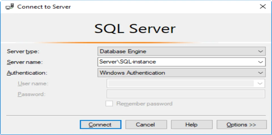

SQL configuration instance
Under “SQL Server instance” the database server must be specified, including the SQL instance. For simplicity, you can copy the server name from the login window of the SQL server.
installation_with_parameters_190

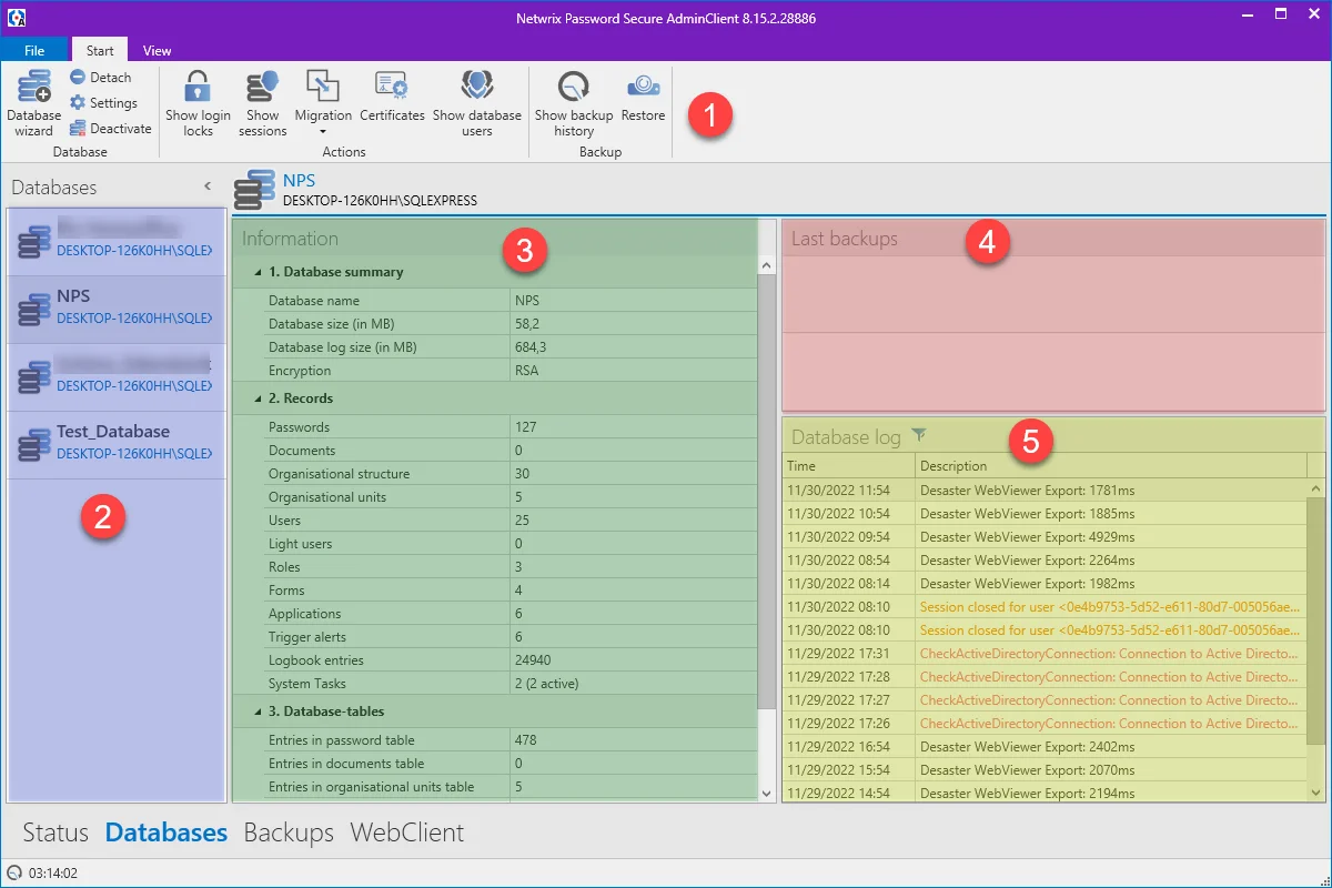

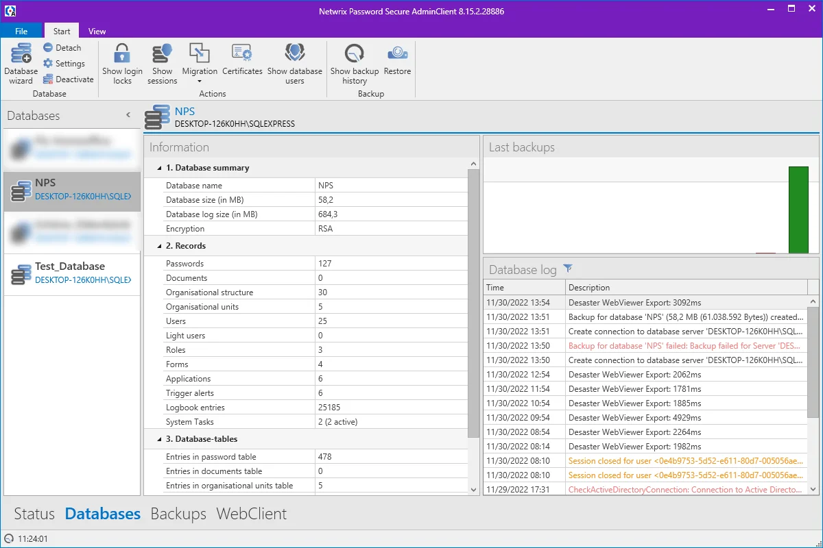

Databases module
Databases are managed in a dedicated module. All relevant information on the existing databases can also be called up – completely without accessing the SQL server.
Databases Admin Client
  1. Ribbon
  2. Database overview
In the database overview, all databases listed alphabetically. This section can be minimised using the arrow symbol on the top, left edge. Right-click on one of the databases to display a context menu with all available functions.
  1. Notification area
The Info area displays all the information about the database currently selected in the database overview. This information is ivided into the three subsections “Database summary, Data sets and Database tables”.
  1. Recent backups
List of recent backups. Can be sorted by date
  1. Database log
The database log is used to monitor and control the specific databases. All relevant actions for the selected database are displayed in a comprehensible manner in one list. The categorisation is carried out in the same way as the server log according to the colours applied.

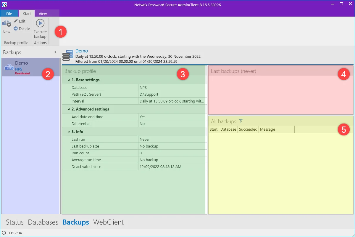

Backups module
There is also a separate module for configuring the backups. This means that all backups can be configured and managed directly from the Server Manager.
backup-ac
  1. Ribbon
  2. Backup overview
All configured backups are listed here. The overview can be minimized to the left. Other functions are available via right-click
The notification area is divided into three sections. The “Basic settings, Advanced settings and Info” sections for the selected database can be used
  1. Recent backups
The last backups are displayed in a list on the right.
  1. All backups
A tabular overview shows all previous backups. The view can be sorted as usual. Here you can see at a glance, when which database was saved and whether the backup was successful.
