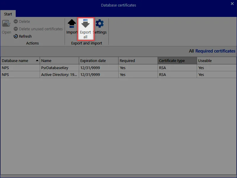

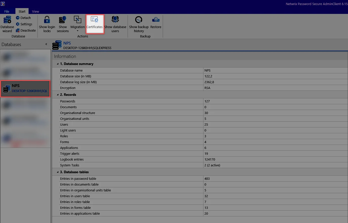

  • Backup all certificates using the Netwrix Password Secure Server Manager
CAUTION: Only certificate backups made through the Server Manager are valid!
Certificates
Export certificates

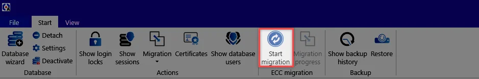

Start migration
Clicking on the icon “Start migration” in the databases' module to start the migration process
start migration

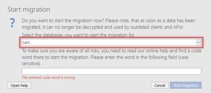

Select the database you want to migrate and enter the code-word.
Remember, The code word is “Start”. Please make sure that you have read the whole documentation. Otherwise, data loss might occur!
select database

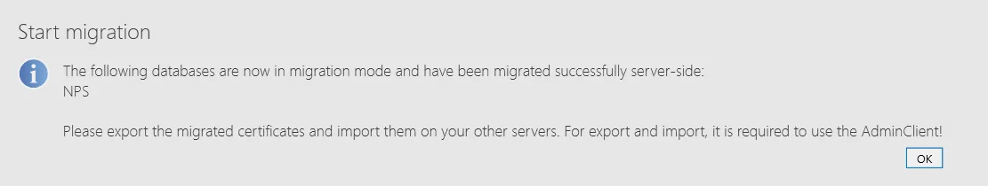

You should see the message, that the selected databases are now in migration mode:
start migration
As written in the message, export all required certificates via the Netwrix Password Secure Server Manager. If you have multiple servers in use import the certificates via the Server Manager at the end of the migration process.
CAUTION: If certificates are missing the migration cannot be continued.

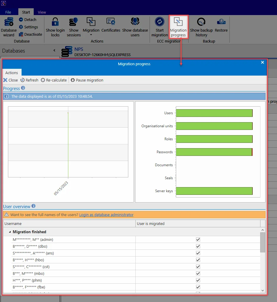

Watch the migration process
In the migration process you find all information about the current process, what is already migrated and what still needs to be migrated
migration progress

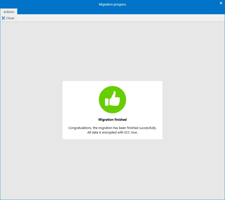

After each user has logged into the database and has been successfully migrated, the migration is complete.
migration finished

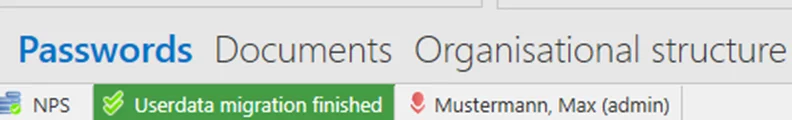

During the migration every E2EE-User of the database has to log in. Keep the client running until the message „Userdata migration finished” appears.
userdata_migration_finished_en
