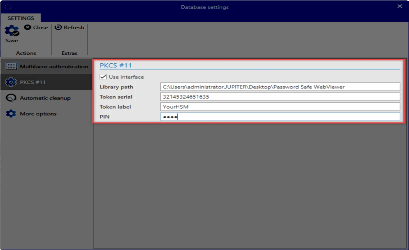

The installation is set up on the Server Manager via the database settings.
installation_with_parameters_235
  • Library path: Here you can find the installed PKCS # 11 driver of the HSM.
  • Token-Serial: The serial number of the token is given here.
  • Token Label: The name of the token.
  • PIN: Finally, the PIN is specified for authentication at the token.
