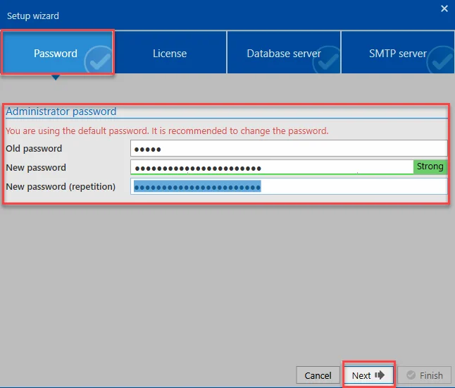

Defining the administrator password
The first step is to define the authentication password for the Server Manager. The initial password is “admin”. A new password needs to be entered during startup – this new password should be securely and properly documented. It can be subsequently changed in the General settings.
setup-wizard-ac-en
NOTE: The initial password is “admin”.

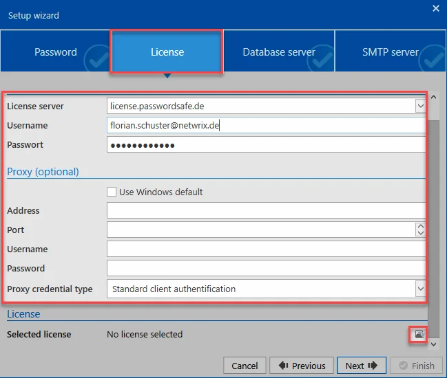

License settings
The second step is to complete the configuration for successively connecting to the licence server. This step can also be carried out later “in the License settings
setup-wizard-ac-2-en
“license.passwordsafe.de” should be entered in the field “Licence server”. The other access data (user name and password for the licence server will be sent to you by email).
If necessary, access data for a possible proxy can also be issued – otherwise the proxy in the operating system will be used. You can then select and activate the required license by clicking on the corresponding button.

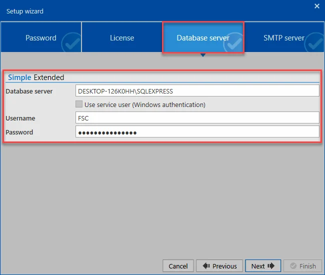

Database server
The configuration of the database server is also part of the Advanced settings and can also be edited there later on.
setup-wizard-ac-3-en
The database server must be specified along with the associated SQL instance. For simplicity, you can copy the server name from the login window of the SQL server.
The user that will be used to create the database on the SQL Server is also specified. The user therefore needs dbCreator rights. Alternatively, you can use the service user for this purpose. The “Advanced” button allows you to specify a Connection String.

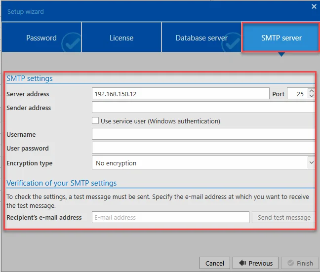

SMTP server
The last step is to configure the SMTP server via which all emails are sent. This is also part of the Advanced settings should it be necessary to make changes later on.
setup-wizard-ac-4-en
Once the data has been entered and successfully tested, the wizard can be completed by clicking on “Finish”.
