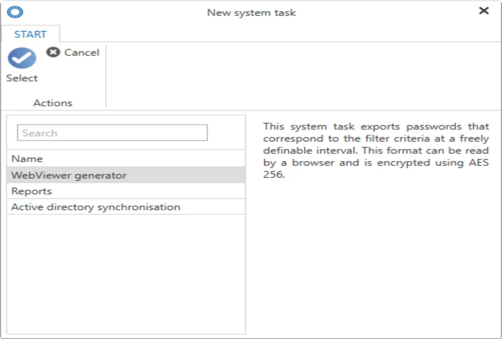

There are currently four different work processes that can be automated using system tasks:
  • HTML WebViewer export: Exports a freely definable selection of records in an AES-256 encrypted HTML file. The file is saved in the form of notifications.
  • Reports: Automatically creates a report that is issued in the notifications. This requires a report request to be created in advance.
  • Network service scan: Searches for service accounts on the network at defined cycles
  • Active Directory synchronization: The comparison with Active Directory can also be automated via system tasks. This requires an active directory profile to be created in advance. It is important to note that only the Master Key profile can be automatically compared.

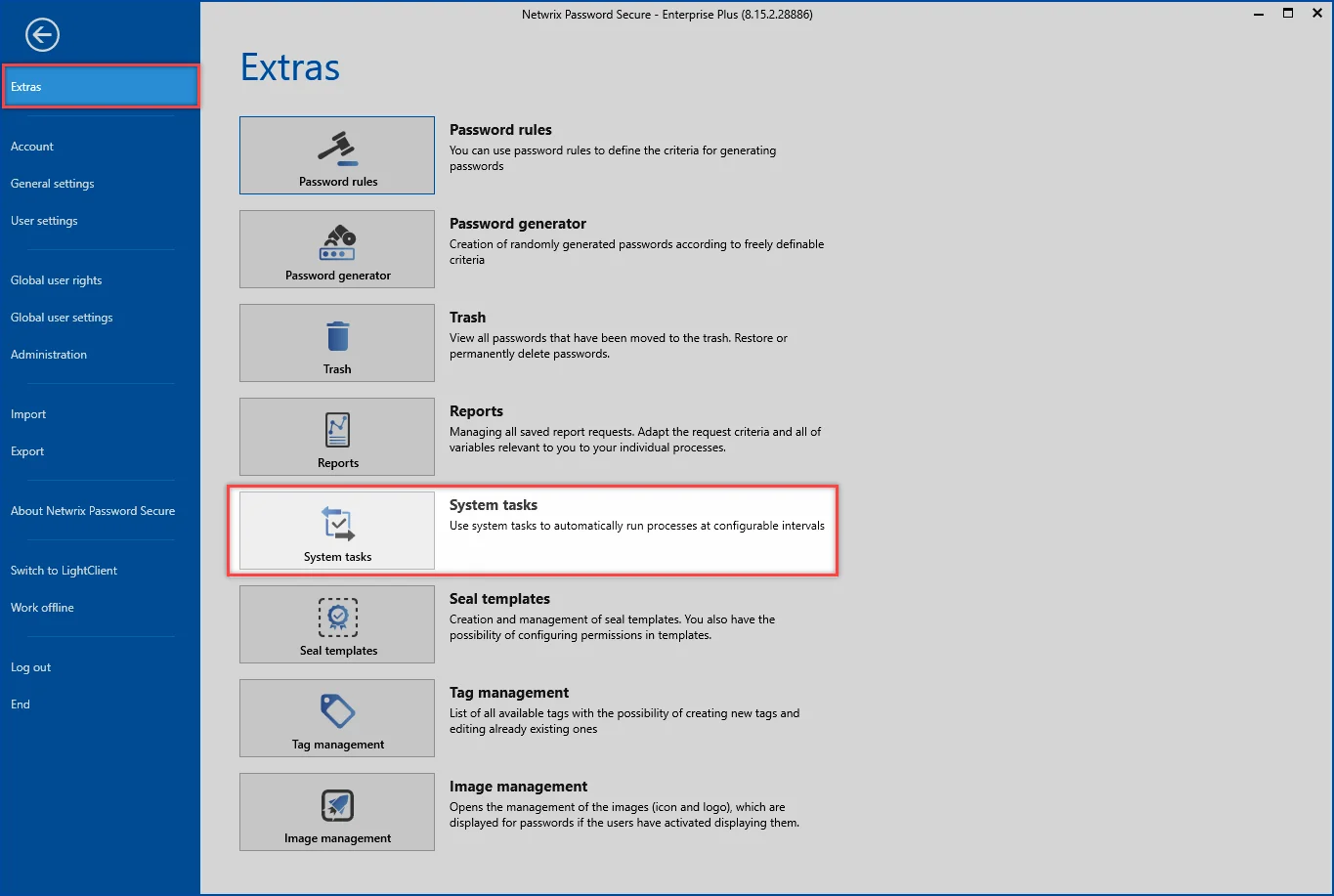

Creating system tasks
System tasks can be initiated as usual via the ribbon or also the context menu that is accessed using the right mouse button. The desired process to be automated using system tasks is then selected from the four above-mentioned work processes.

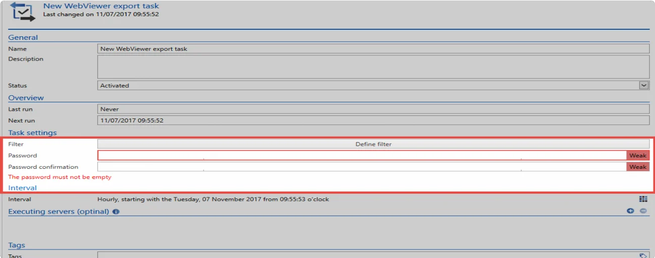

WebViewer generator
  • Filter: The passwords that should be exported are defined using a filter.
  • Password: The HTML WebViewer creates an encrypted HTML file. The password is defined here and must then be confirmed.

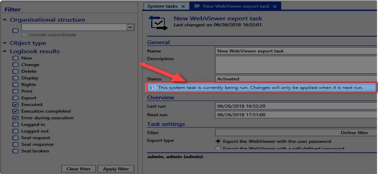

Status
A corresponding note will be displayed to indicate if a task is currently being executed.
