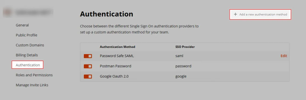

  • After logging in, click on the avatar and select "Settings".
settings postman
  • Then click on Authentication. Select a new method in the upper right corner.
option authentication postman

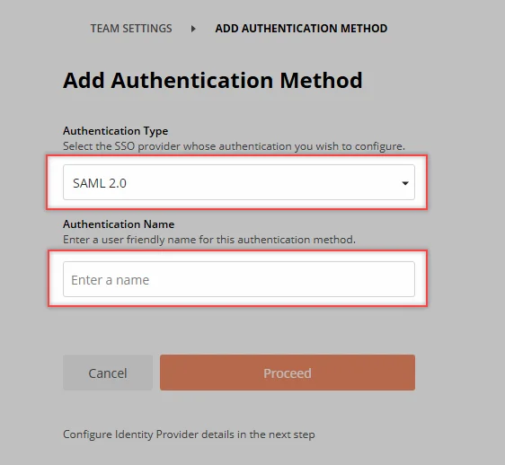

  • Here the Authentication Type must be defined with SAML 2.0 and any useful Authentication Name.
add authentication method

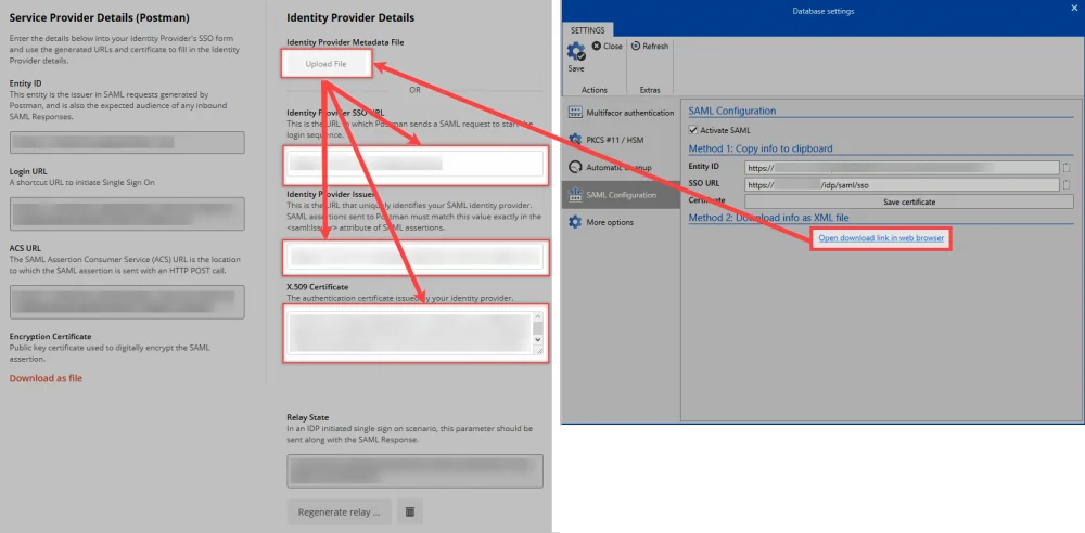

  • Store Provider Details
  • Identity Provider Details The data from the Server Manager is uploaded as XML or stored manually.
postman identity provider details

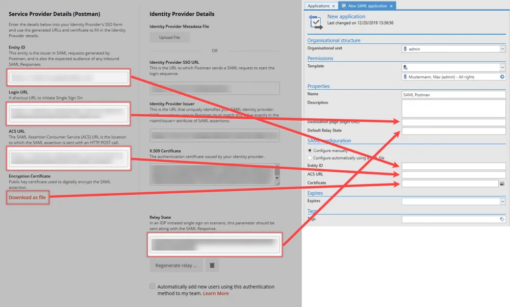

  • Service Provider Details The service provider details are now copied to the application in the Netwrix Password Secure Client.
postman service provider details
NOTE: Please note that a Relay State is required. This value can be created in the Configure Identity Provider Details View.
