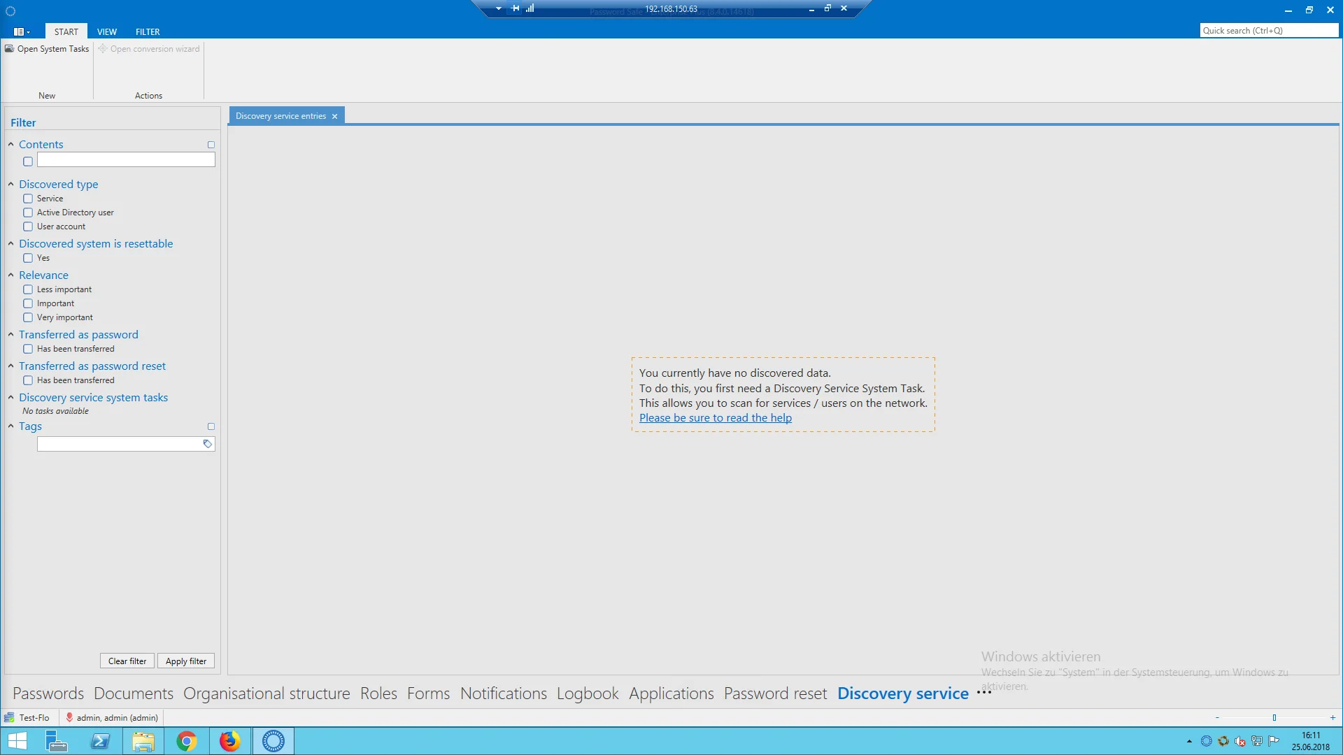

The Discovery Service module
When this module is opened in Netwrix Password Secure, there are no entries displayed in the Discovery Service module at the beginning. The entries need to be generated using a System tasks.

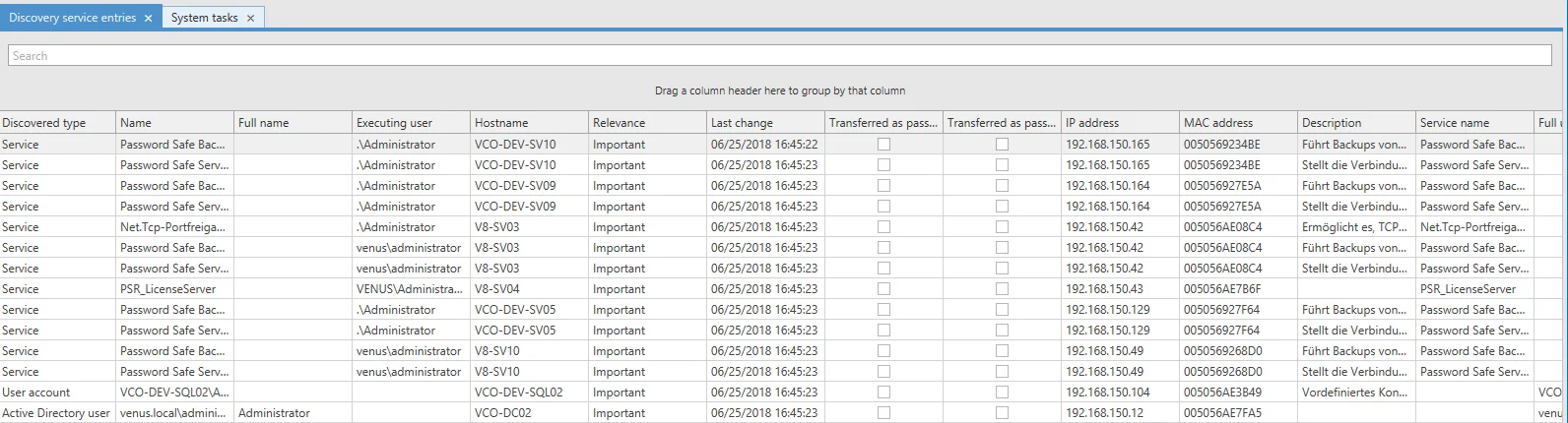

Once a System Task has been completed, the data discovered during the search is listed in a table:
discovery service entries
NOTE: The information can be grouped together using the column editor.

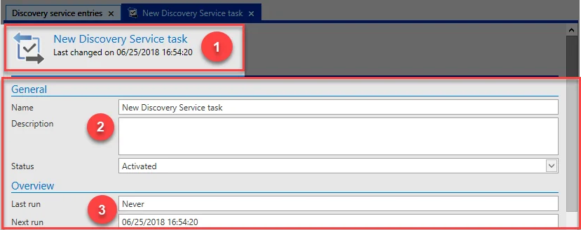

General and overview
The following image shows a newly added Discovery Service Task.
new discovery task
  1. Shows information about the Discovery Service Task.
  2. In the General section, the name of the Discovery Service Task is entered (optionally with a description). The Status is always set to Activated by default but it can also be set to Deactivated in the configuration.
  3. The Overview shows the activities of the Discovery Service Task: Last run: shows the date it was last run. Next run: shows the date of the next run.

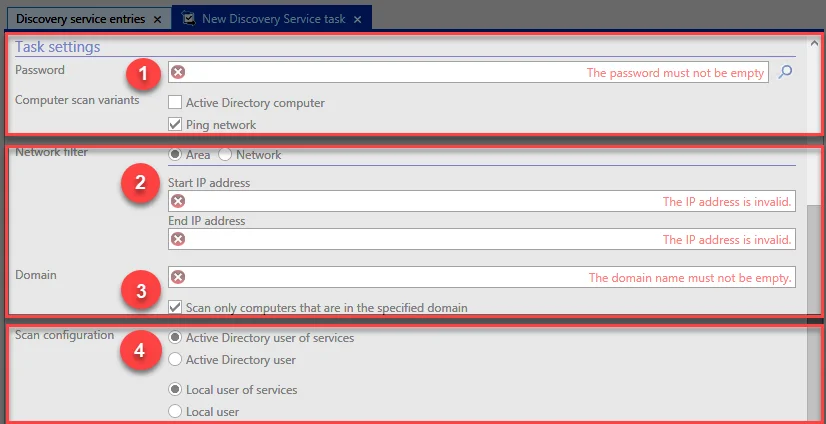

Task settings
Password:
  1. User name field: Type
  2. Password field: Type Multiple password field —> field 1. is used.
This section is used for special entries for the Discovery Service Task. After it has been finished, the Network Scan scans the network according to these guidelines.
task settings
  1. Password and Computer scan variants: The required password must already have been issued and it requires corresponding rights for the domain. Active Directory computer: Only those computers that are in Active Directory are scanned (there is also the option of using it individually or pinging the network). Ping network: A network filter for the configuration of the network is displayed.
  2. Network filter: This defines the network to be scanned: either using an IP range or an IP network address. Range: The start IP address and end IP address for the range on the network are entered here Network: The network address and corresponding subnet mask for the network are entered here
  3. Domain: The domain to be used for the network scan is entered here. In addition, you can select that only computers in the entered domain are scanned. A name resolution should work for this purpose.
  4. Scan configuration: The Network Scan for the configuration of Active Directory is defined here. Select from either Active Directory user of services or Active Directory user. The second section defines the scan configuration for the local computer. Select from either Local user of services or Local user.
CAUTION: The system executing the scan – on which the Server Manager is installed – is not scanned!
