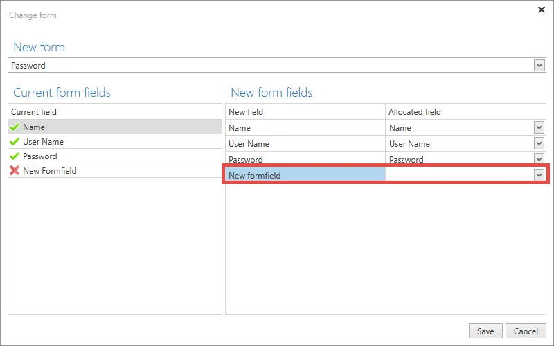

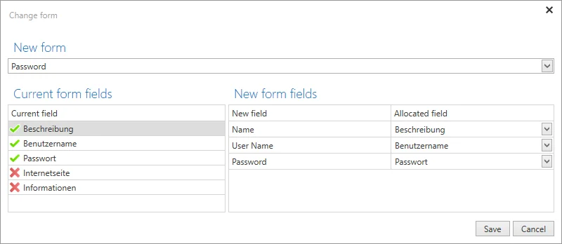

In the following screenshot, you can see the dialogue for "mapping" the form fields from the previously used form to the new form. In this example, a record that previously belonged to the "Website" form is being "mapped" to the "Password" form (right).
change form
The drop-down menu allows you to select the target form. The comparison of current and new form fields is shown in the lower section.
  • Fields marked in green have already been assigned to the new form
  • Fields marked in red indicate fields that have not been assigned

CAUTION: Please note that information could be lost during this process! In the example, this applies to the fields "Website" and "Information".

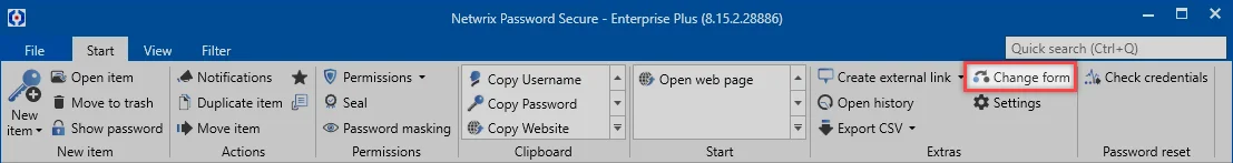

How to change forms
If you press the "Change form" button (as mentioned in the previous section), the already existing form will be used by default. If this form has been changed in the meantime, the new form field will be directly shown and adopted after it is saved.

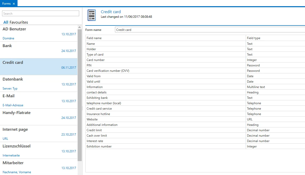

Standard forms
Netwrix Password Secure is supplied with a series of standard forms – these should generally cover all standard requirements. Naturally, it is still possible to adapt the standard forms to your individual requirements.
forms
The associated preview for the form selected in List view appears in the Reading pane. Both the field name and also the field type are visible.

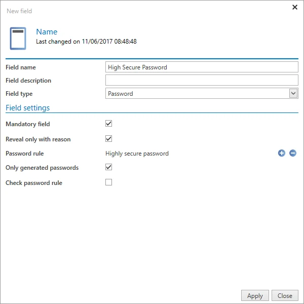

The wizard for creating new forms can be started via the ribbon, the keyboard shortcut "Ctrl + N" or also the context menu that is accessed using the right mouse button. The same mechanisms can now be used to create new form fields within the wizard. Depending on the selected field type, other options are available in the field settings section. This will be clearly explained below using the example of the field type "Password". The sequence in which form fields are requested when creating new records corresponds to the sequence within the form. This can be adapted using the relevant buttons in the ribbon.
Creating new forms
The following field settings thus appear for the field type "Password": "Mandatory field, reveal only with reason, check only generated passwords and password policy". These can now be defined as desired. (Note: It is possible to select Password rules within the field settings; they are defined as part of the options in the main menu)
CAUTION: If a form has been created, it can then be selected for use when creating new records. The prerequisite is that the logged-in user has at least read rights to the form.

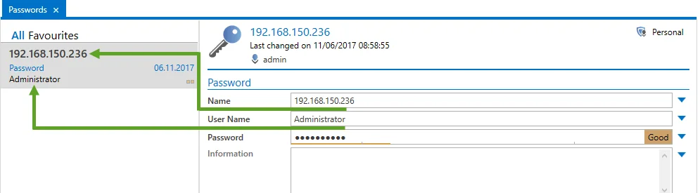

Every record displays other information underneath the obligatory name of the record in list view. In the following example, the user name is also displayed in addition to the name of the password. The name of the form is displayed in between in a blue font.
Configuring the info field

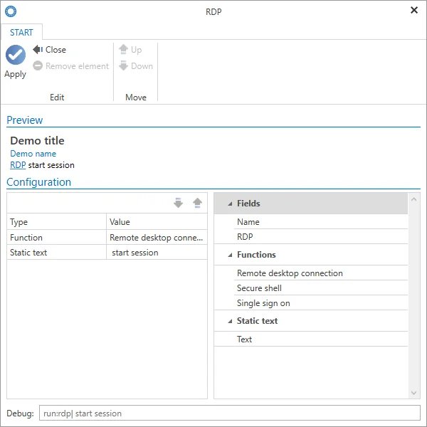

The name of the record (192.168.150.236) and the form (password) cannot be adjusted – these are always displayed. The user (Administrator) that is still saved for the record is currently displayed. This can be configured in the info field for the form. It is thus possible to separately define for each form what information for a record can be directly seen in list view. In the form module, the info field is configured by opening the form which has to be edited in editing mode by double clicking on it and then pressing the *Configure info field” button in the ribbon.

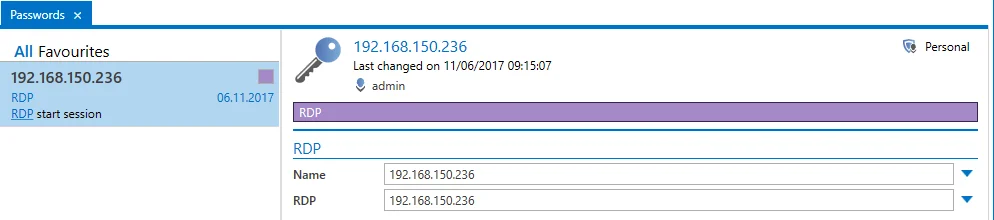

This will open a separate tab that enables you to design the info section via drag & drop. The fields that are available on the right can be "dragged" onto the configuration window on the left. In the following example, "Start RDP session2 will be made visible in the info section, whereby only the word "RDP" is assigned a function – namely to start the RDP manager. A preview is shown in the top section.
preview form
The info field for the form is now updated. It is now possible to start the RDP session directly in the RDP session.

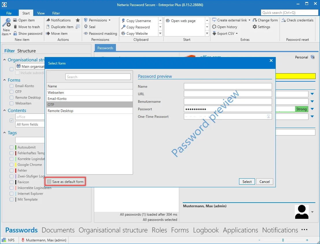

Standard form

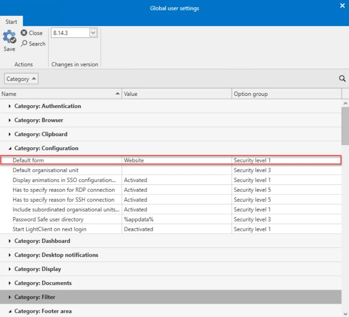

There are two possible ways to define a standard form.
Via the “standard form” user setting
settings form
Via the form selection
default form
