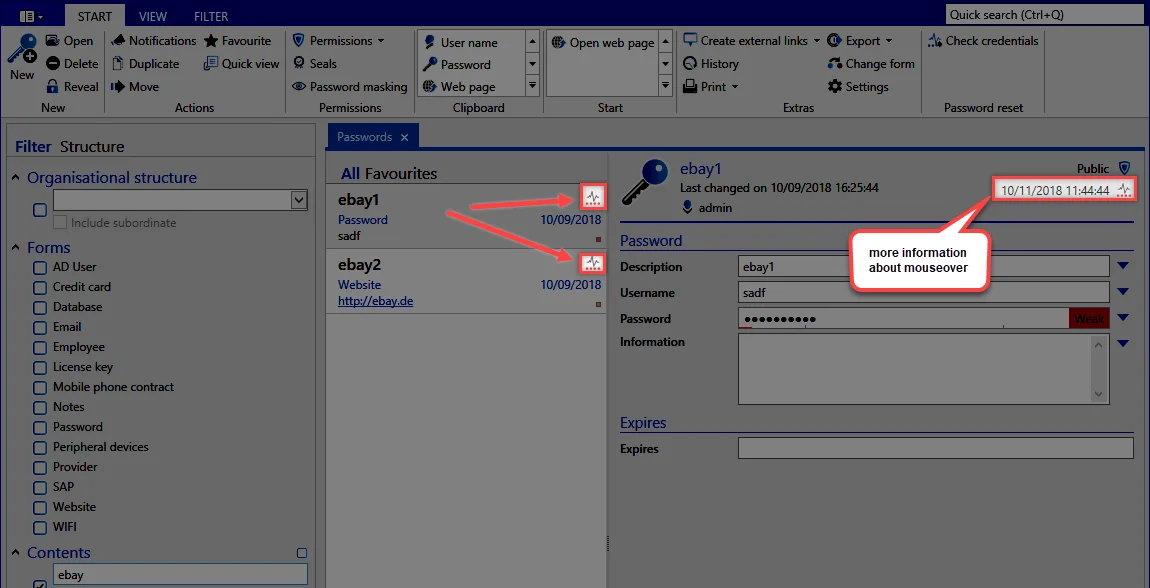

Results of the tests
The results of the test can be viewed in the passwords module.
result heartbeat
The date when it was last executed can be seen at the top of the Reading pane. The success of the testing process is indicated alongside using a coloured icon. Further information can be displayed by moving the mouse over the icon.
The icon has three different versions. These have the following meanings:
The last test was successful. The password is correct The test could not be performed. For example, the password could not be reached. The last test was completed. However, the password is different to the one on the target system.

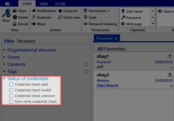

Filtering the results
The filter can be configured using the filter group Status of the login data so that the tested records can be selected.
Filter heartbeat status
