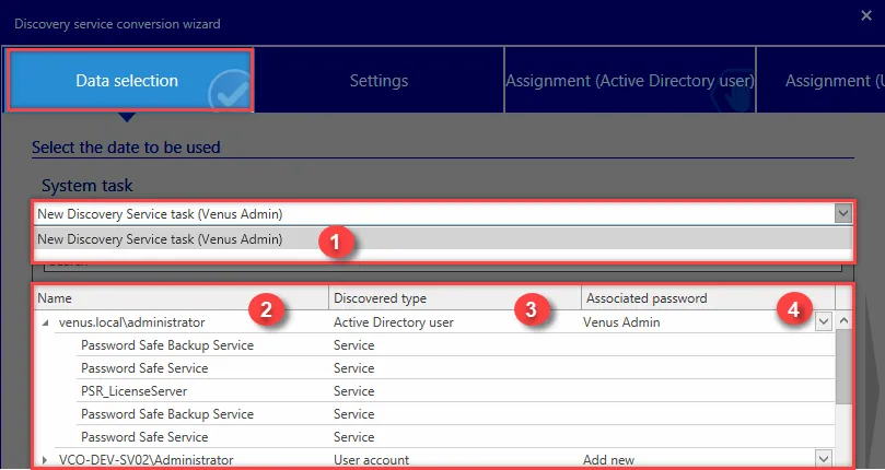

In the Discovery Service table, the user selects the entries for which he wants to add a Password Reset or password. The user then clicks on the Conversion Wizard and the Discovery Service Conversion Wizard opens for further editing.
data selection
  1. A Discovery Service Task first needs to be selected. This determines the context in which the new data will be created (for a new Password Reset, the password for the domain administrator for the task will be used as the executing user. In addition, only those Discovery Service Task entries that are also discovered by the entered Discovery Service Task will be used for the conversion).
  2. The discovered entries will be displayed in this column with the services for which the user has been entered.
  3. This column shows the discovered type for the entry.
  4. This column shows already existing passwords in Netwrix Password Secure that match the discovered Active Directory user or user account. It is possible to select here which password can be used when creating a Password Reset (it is then used as the only password linked to the Password Reset). Alternatively, these passwords can also be newly created.
NOTE: Logically, every root node corresponds to one user and all of its associated data (e.g. services). A Password Reset is created later for every user and its associated data.
The following image shows the options add new password or retain existing password.

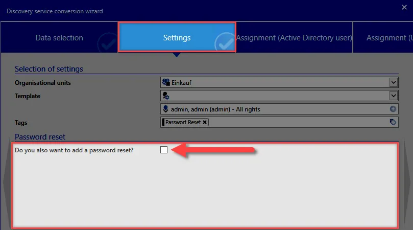

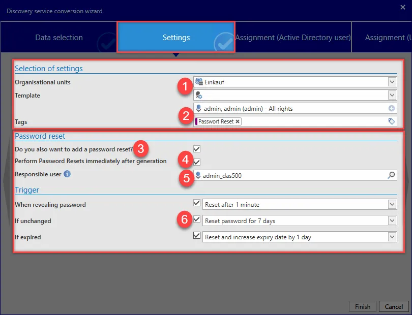

Settings
The Password Reset is configured in the Settings Ribbon.
reset setting
The settings will be described in more detail below:
  1. The organisational unit in which the Password Reset should be created is entered here. In addition, a template for the rights inheritance can be entered here.
  2. The responsible user for the password is entered here. A special tag can be set here.
  3. Adding a Password Reset Option 1: Do you also want to add a Password Reset? Adds a Password Reset If option 1 is not selected, the following options are not displayed.
  4. Setting for executing a Password Reset Option 2: (Execute Password Resets immediately after they are created) means that the Password Reset will be executed as soon as you click on Finish.
  5. The responsible user for the Password Reset is entered here.
  6. Various triggers for the Password Reset can be selected here.
CAUTION: After clicking on Finish, the Password Resets will be immediately executed and the passwords changed!. This also applies to Windows passwords!
If option 1: Do you also want to add a Password Reset? is not selected, *steps 4, 5 and 6 are not displayed for configuration.
password reset option
NOTE: After clicking on Finish, one or more passwords will be created but no corresponding Password Resets will be created!

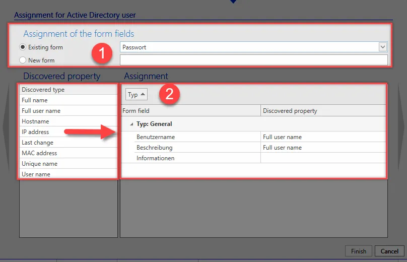

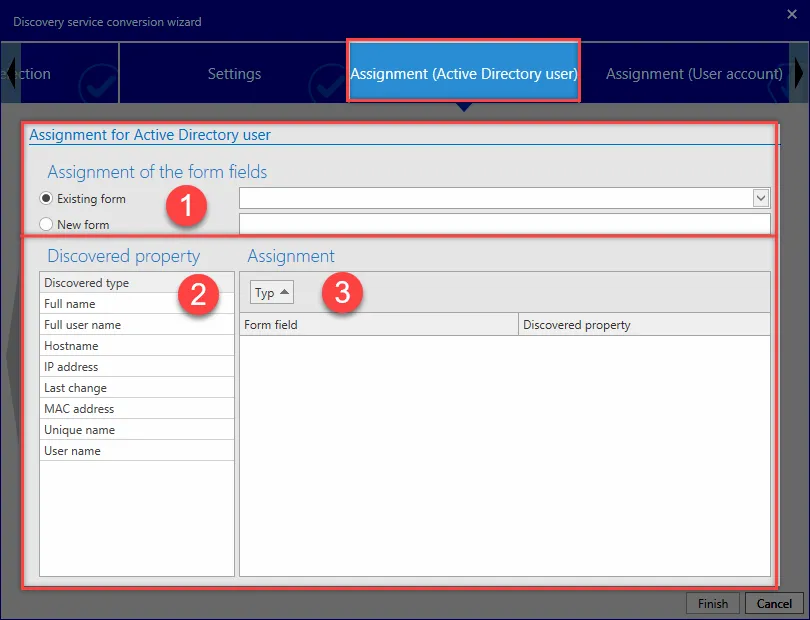

Assignment (Active Directory user)
In the Assignment (Active Directory user) Ribbon, the discovered data for the Discovery Service entries is transferred to a password form.
The following images shows the Assignment (Active Directory user) Ribbon
Description
  1. An Existing form can be selected or a New form with names can be added
  2. The discovered properties are displayed here
  3. The properties are *assigned to the form fields here
"Existing form" selected
Assignment of the form field
Procedure
  1. An Existing form is selected here
  2. The assignment to the fields is carried out here Important assignments are Type: General and Type: Password Reset. An amendment can be carried out here

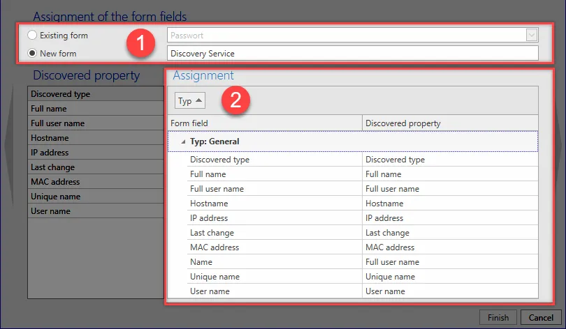

"New form" selected
New Form
Converting Procedure
  1. A name for the New form needs to be entered here
  2. The discovered entries are automatically assigned as standard Important assignments are Type: General and Type: Password Reset. An amendment can be carried out here

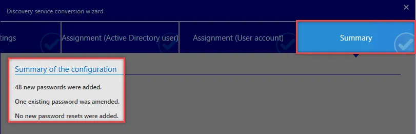

Summary
A brief overview of the actions that will be carried out with the added configuration is displayed in the Summary Ribbon. These actions will then be carried out if you click on Finish.
summary

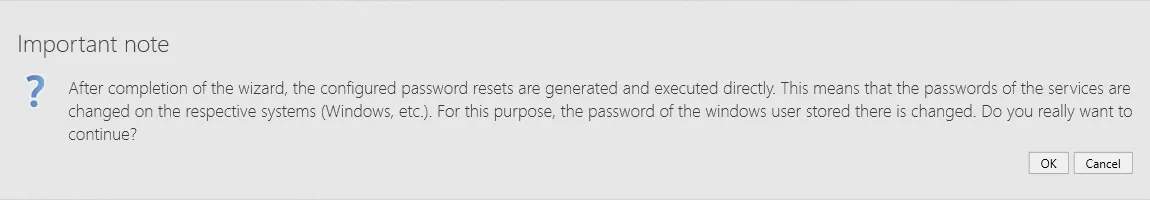

Confirmation prompt
An important aspect of Netwrix Password Secure V8 is the security of passwords on systems. In the Discovery Service, a security measures is thus triggered at the last step for creating Password Resets. If the option Execute Password Resets immediately after they are created is used in the configuration, the selected passwords are immediately changed after clicking on Finish.
CAUTION: If you are not paying careful attention, this could have inconvenient consequences.
Security level 1: An Important note is displayed in the Summary after clicking on Finish.
CAUTION: Please observe the note and read it through carefully!
An Overview of which actions will be carried out is displayed for the user together with this note. The user can then still decide to Cancel the process. If you click on OK, an additional confirmation warning will be displayed.
important note
Security level 2:
Another confirmation prompt highlights that it is important to understand what you are about to do. It will no longer be possible to reverse the actions afterwards!
CAUTION: Last chance to cancel the execution!
securtiy warning
After entering the displayed number and confirming with OK, the process is executed immediately and the Password Resets are carried out and the associated passwords changed.
