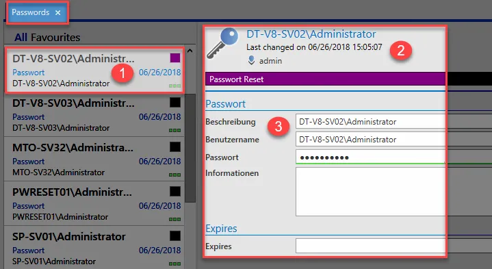

Password
- The name of the created password
- General data about the password
- Data about the password created from the form (existing or new)

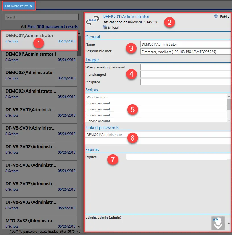

Password Reset
Another password is created in the Password Reset module and is required for an associated Password Reset.
Points 1-7 are described below:
- The name of the Password Reset
- Overview of the password
- General
- The data for the trigger are displayed here
- The scripts for the passwords to be changed are displayed here
- The associated password that will be reset using the Password Reset
- The validity is shown here (if one has been entered)
This data can then be used to create a Password Reset for the user for the discovered Discovery Service entry. The Password Reset is activated via the corresponding trigger that has been set.

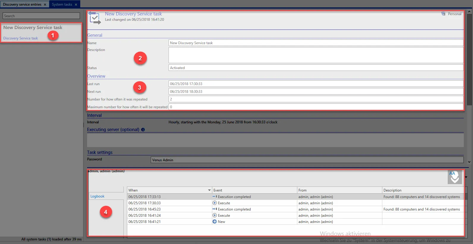

The entries for the Discovery Service are discovered using a Discovery Service Task. It can take some time for all the data on the systems for the entered IP network to be collected. This can be easily recognized by the blue arrow symbol on the Discovery Service Task and a corresponding message is also shown in the General display. Once the Discovery Service Task has been completed, the data will be shown in the Discovery Service module.
The Discovery Service Task needs to be carefully configured. The configurable sections are described below.
- Discovery Service Task: Display of the status: this can be updated in the preview and logbook using the F5 button. Red hand: Deactivated Blue arrow: Activated and being executed Boxes: Corresponds to the assigned tag
- General: The latest information about the Discovery Service Task is shown here. A message will be shown to indicate an active Discovery Service Task.
- Overview: Current data for the Discovery Service Task about its progress and subsequent executions are shown here.
- Logbook: The logbook can be found in the footer of the Discovery Service Task. The latest activities carried out by the Discovery Service Task are shown here.
NOTE: The data is not kept up-to-date while the task is being executed and does not always show the latest status. Therefore, the data should be regularly updated using the F5 button!

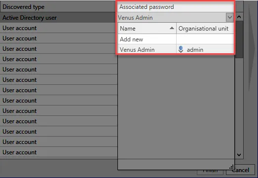

For Active Directory users, it is possible to assign an existing password.

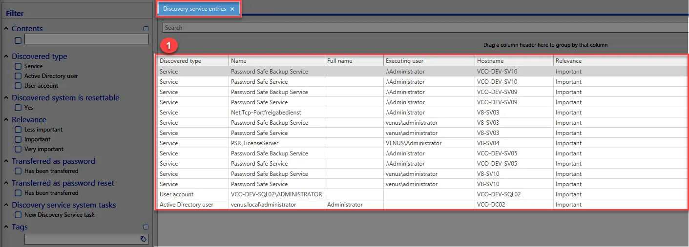

Filter settings
A good filter is required for processing the discovered data. A filter that has been adapted for this purpose is available for processing the entries in the Discovery Service module. The options in the filter are described below:
Description of the filter with the special options for the Discovery Service entries:
- Discovered type: The discovered entries can be filtered here according to their type.
- Discovered system is resettable: Indicates whether a Password Reset can be created from the discovered data.
- Relevance: Grading the importance of the discovered system. A high relevance means that multiple services have been discovered for an Active Directory user or user account. Less important: Exactly one service was found Important: Two to nine services were found Very important: 10 or more services were found If a Password Reset has already been created, the relevance is downgraded to less important.
- Transferred as password: Indicates whether a password can be created via the Conversion Wizard
- Transferred as Password Reset: Indicates whether a Password Reset can be created via the Conversion Wizard
- Discovery service system tasks: The entries are filtered here based on the System Task.
