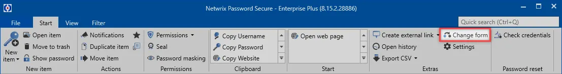

It is necessary in some cases to change the form for a record. In these cases, this is mostly to consolidate existing data or to adapt the form to match changes in the data structure. These functionalities are available under "Extras/Settings" in the ribbon.

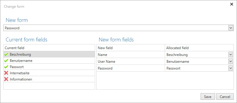

In the following screenshot, you can see the dialogue for "mapping" the form fields from the previously used form to the new form. In this example, a record that previously belonged to the "Website" form is being "mapped" to the "Password" form (right).
change form
The drop-down menu allows you to select the target form. The comparison of current and new form fields is shown in the lower section.
  • Fields marked in green have already been assigned to the new form
  • Fields marked in red indicate fields that have not been assigned

CAUTION: Please note that information could be lost during this process! In the example, this applies to the fields "Website" and "Information".

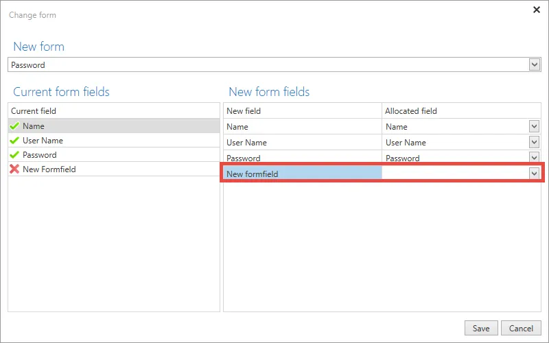

If you press the "Change form" button (as mentioned in the previous section), the already existing form will be used by default. If this form has been changed in the meantime, the new form field will be directly shown and adopted after it is saved.
New Form
