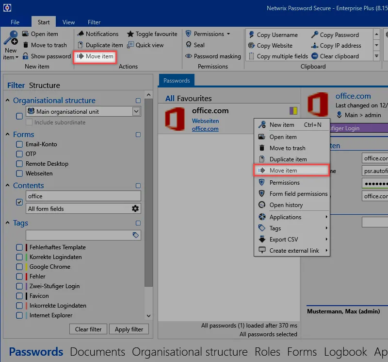

How do you move a record?
The (marked) records are moved either via the ribbon or via the context menu that is accessed using the right mouse button.
moving password
Multiple records can also be marked and moved. The selected permissions are then valid for all records in this case.
