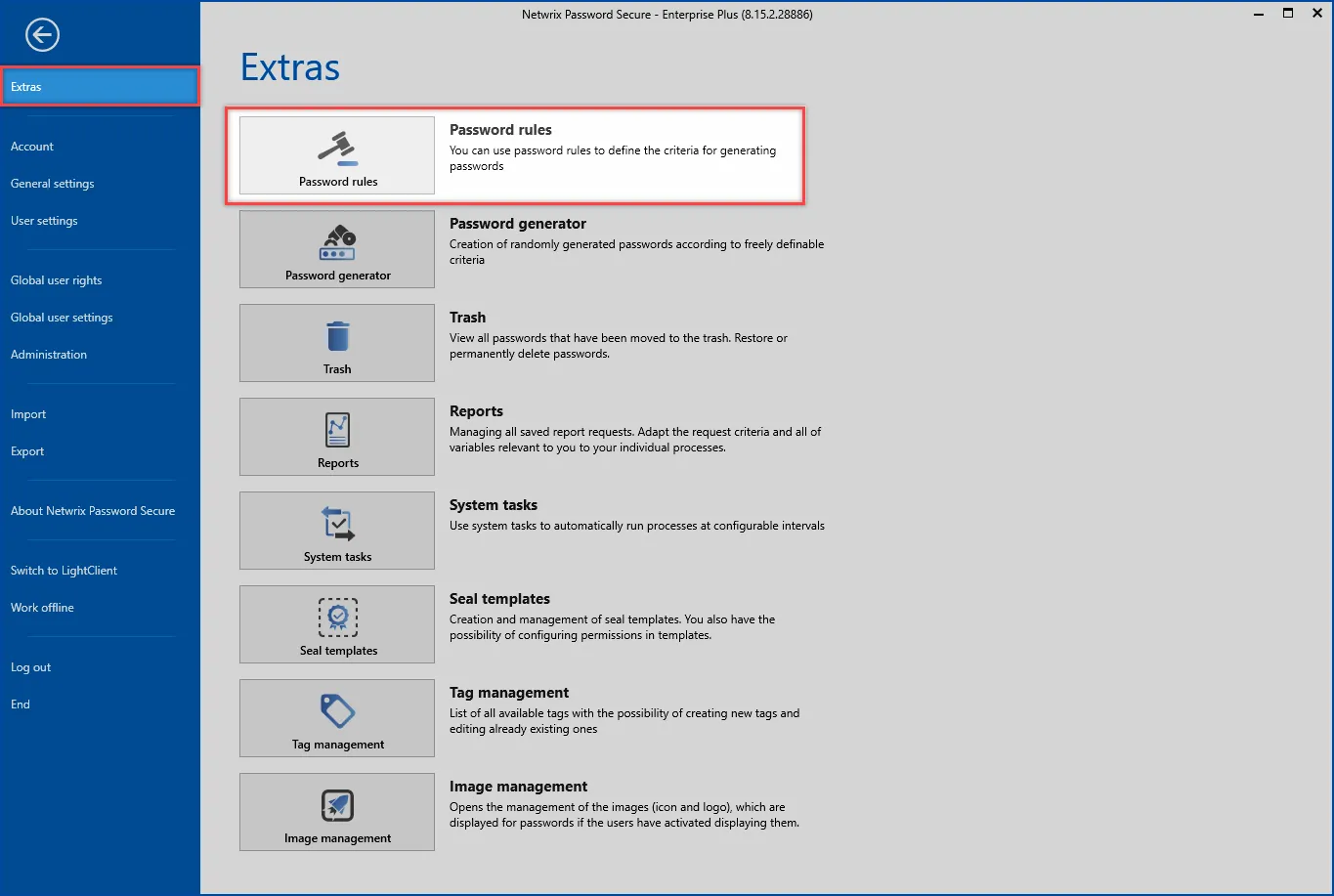

Managing password rules
If “Password rules” is selected under Main menu/Extras, the available password rules will appear in a separate tab in the currently active module.

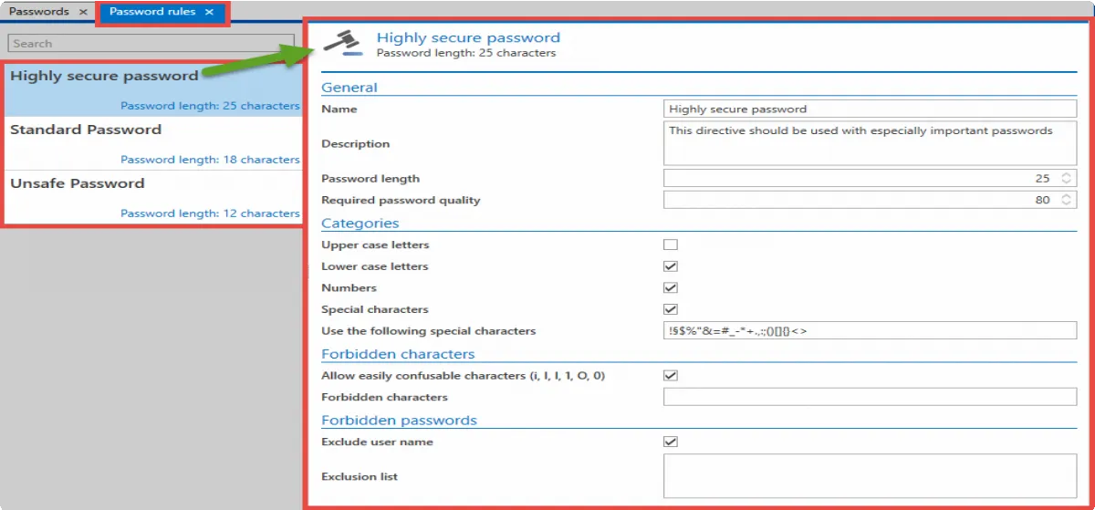

In this screenshot, a total of 3 password rules are shown. As the rule “Very secure password” has been selected in List view, the Reading pane on the right displays the configuration for this rule:
- General: The Password length of 25 is the minimum number of characters that a password needs to contain according to this rule. The required Password quality is an internal measure of security, which is calculated for this rule. This value always lies between 1 (very unsecure) and 100 (maximum security).
- Categories: A password can consist of a total of four categories. It is possible to define which of these categories to use and also how many of them to use.
- Forbidden characters: It is also possible to exclude some special characters. These characters need to be entered in the list without separators.
- Forbidden passwords: Some passwords and the user name can also be added to the list of forbidden passwords
- Preview rules: When new rules are created, an example password is generated that conforms to the configured rules. This is only the case for passwords with a minimum length of 3 characters!

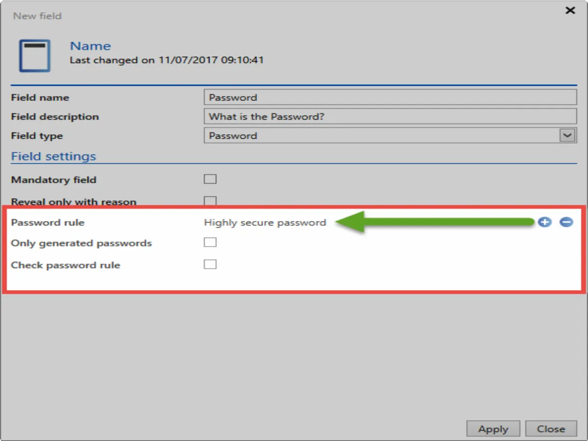

- Default for the password field in a form:
When a password field is defined in a form, one of the defined password rules can be set as the default. This means that the default will always be used when a new password is created. In this way, it is possible to ensure that the required level of complexity is maintained for certain passwords.
If one of these password rules is defined for a form, it is only possible to define a new random value for the password if a new password is created. The icon on the right hand side of the password field is used for this purpose.
