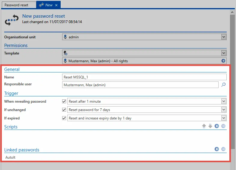

New Password Resets can be directly added via the ribbon or the keyboard shortcut "Ctrl + N" in the Password Reset module. With regards to setting permissions, a Password Reset behaves in precisely the same way as every other object. It is thus possible to precisely control which users can view and use which Password Resets.
Configuration Guide
The configuration of a new Password Reset comprises four steps. All of the necessary conditions and variables for the configuration are defined in the following areas: "General", "Trigger", "Scripts" and "Linked passwords".
configuration password reset
General
  • Name: Designation for the Password Reset
  • Responsible user: All completed Password Resets are also recorded within Netwrix Password Secure (logbook,…). To ensure these steps can be allocated to a user, a user who is registered in Netwrix Password Secure is selected in the field "Responsible user".
Trigger
Triggers describe the conditions that need to be fulfilled so that a Password Reset is carried out. There are a total of three possible triggers available:
  • Reset the password x minutes after the password has been viewed
  • Reset the password when it has not been changed for x days
  • Reset the password when it has been expired for x days
At least one trigger must be activated so that the Password Reset is activated. Deactivating all triggers is equivalent to deactivating the Password Reset. All three triggers can be activated and deactivated independently of one another. Only one selection can be made in each of the three categories.
NOTE: A separate system task within Netwrix Password Secure checks every minute whether a trigger applies.
Scripts
A new dialogue appears after the selection in which the type of system "to be reset2 can be defined.
new script password reset
  • Script type: You select here from the possible script types.
  • Password: The credentials for the record that will ultimately carry out the Password Reset. The required information is specifically requested in each case. For example, if the reset is for an MSSQL user, the MSSQL instance and the port used needs to be entered.
The functions and configuration process are described in detail in the section Scripts.
NOTE: It is not possible to create a Password Reset without an associated script.
Linked passwords
All records that should be reset with the Password Reset according to the selected trigger are listed under “Linked passwords”. Multiple objects can be entered. The linked Password Reset is also visible in the footer of the reading pane once it has been successfully configured.

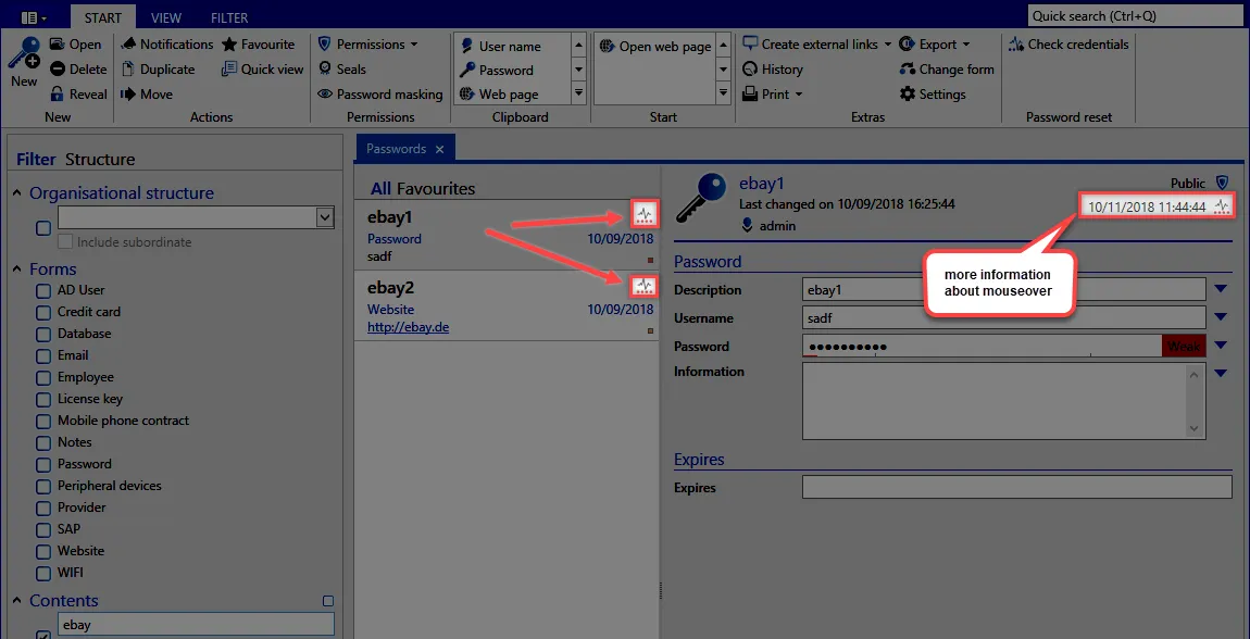

The heartbeat can be executed in the ribbon for the password module by clicking on Check login data. The currently marked password is always tested.
Automatic testing via the password settings
It is also possible to configure the heartbeat to run cyclically. It can be configured either via the User settings or directly in the Password settings.
Results of the tests
The results of the test can be viewed in the passwords module.
result heartbeat
The date when it was last executed can be seen at the top of the Reading pane. The success of the testing process is indicated alongside using a coloured icon. Further information can be displayed by moving the mouse over the icon.
The icon has three different versions. These have the following meanings:
The last test was successful. The password is correct The test could not be performed. For example, the password could not be reached. The last test was completed. However, the password is different to the one on the target system.

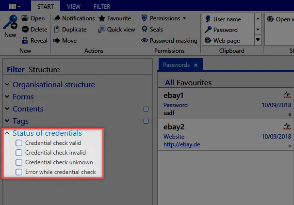

Filtering the results
The filter can be configured using the filter group Status of the login data so that the tested records can be selected.
Filter heartbeat status
