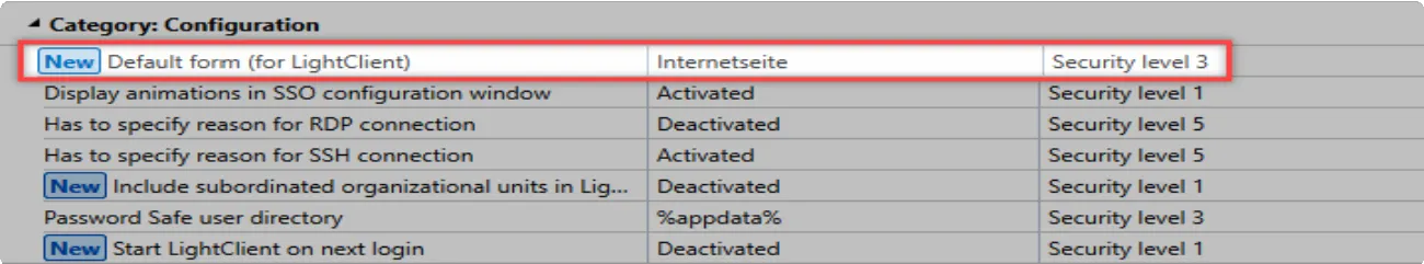

NoDefaultForm
No standard form was selected. The form can be stored in the settings under Standard form (for the Basic view).
DefaultFormNotFound
The rights of the form must be checked. The user must have at least the permission to read the form.

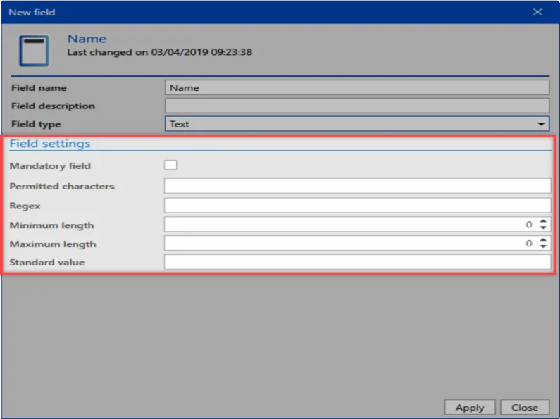

DefaultFormMissingFields
The form has been set correctly. However, the field types in the form must be checked. At least required: Text, user name, password, URL.
DefaultFormImpossiblePlausibility
When creating a password for an application, there is a field which is not displayed. Therefore, the plausibility in fields should be checked.
