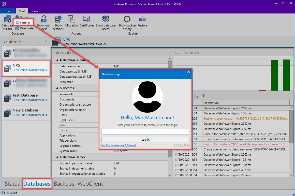

To use multifactor authentication on a database, it must firstly have been activated on the Server Manager. In the database module, open the settings for the selected database via the ribbon.
database settings

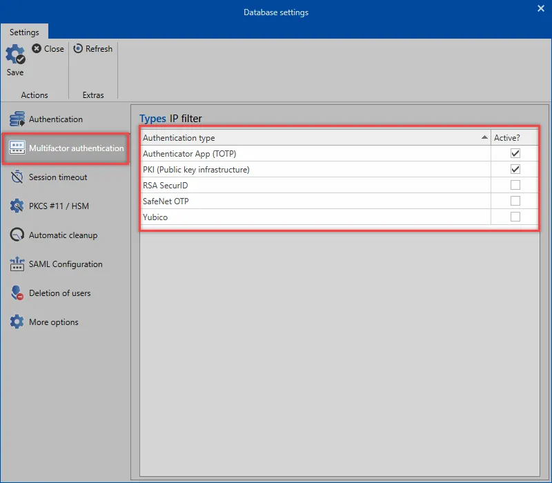

It is possible to separately define in the settings whether it is permitted to use each interface on the database.

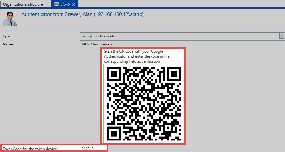

Google authenticator
The prerequisite for this is that the relevant app has been started on a smartphone. After the name has been assigned for the authentication, you generate a new secret via the corresponding button. A QR code is displayed, which must be scanned using the Google Authenticator app on a smartphone.
google authenticator
Once the Google Authenticator app has detected the QR code, it will return a 6-digit PIN. You must then enter it in the appropriate field. Finally, click on Create in the ribbon.

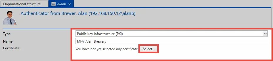

Public key infrastructure
For PKI setup, the Select button is used to open the menu for selecting the desired certificate. All eligible certificates are displayed.
Now just select the desired certificate from the list to confirm the process.

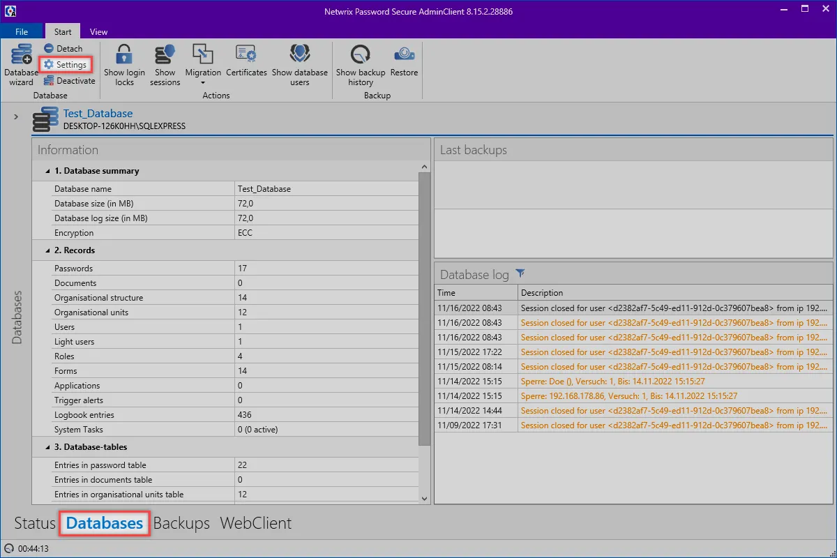

In the Databases module, select a database and open its settings via the ribbon...
Database settings
In the settings you define which second factors can be used.
NOTE: If you want to use "Encipherment" for PKI certificates without KeyUsageFlag, uncheck the corresponding checkbox.
