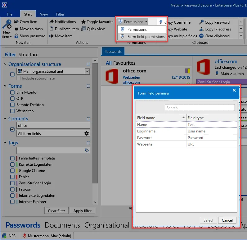

The associated form field permissions for the marked record can be opened via the ribbon using the drop-down menu under "Permissions".

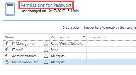

The window that opens allows you to select the relevant form field for which you want to grant permissions. The following example focuses on the password field.
permissions of password field
The permissions configured here now exclusively apply to the password field. The other form fields remain unaffected.

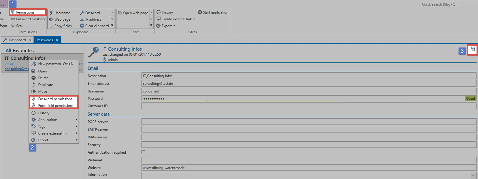

In the previous section, it was clarified that permissions are granted either directly to the user or to several users grouped in a role. With this knowledge, the permissions can be set manually. In the Passwords, there are three different ways to access the permissions in the list view:
  1. Icon in the ribbon
  2. Context menu of a data record (right-click)
  3. Icon at the right edge of the reading pane

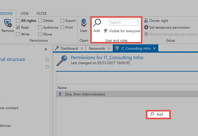

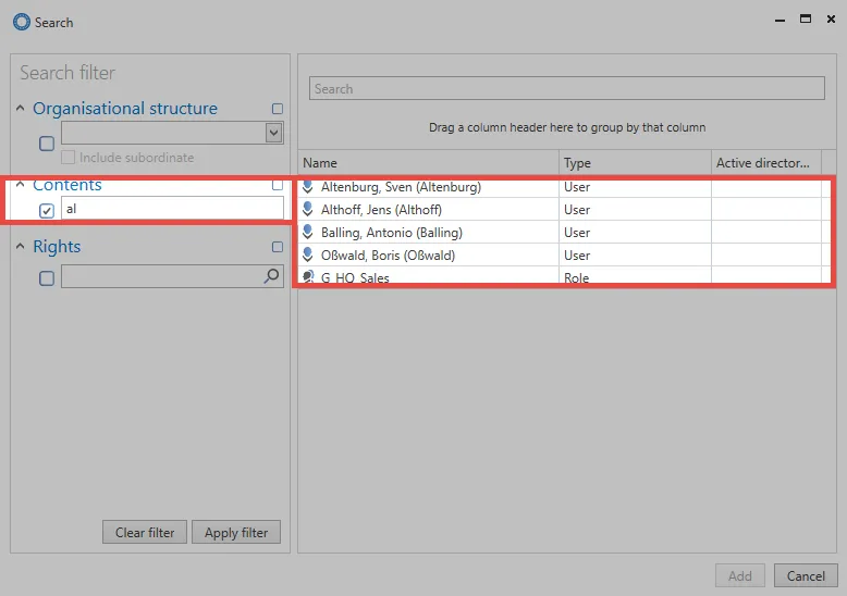

The author is created with all permissions for the record. As described in the Permission concept and protective mechanisms, you can now add roles and users. 'Right click - Add' inside the userlist or use the ribbon "User and roles" to add a user. The filter helps you to quickly find those users who should be granted permissions for the record in just a few steps.
add user and role
The search Filteropens in a separate tab and can be configured as usual.
seach filter
Multiple selection is also enabled. It allows to add several users via the Windows standard Ctrl/Shift + left mouse button.

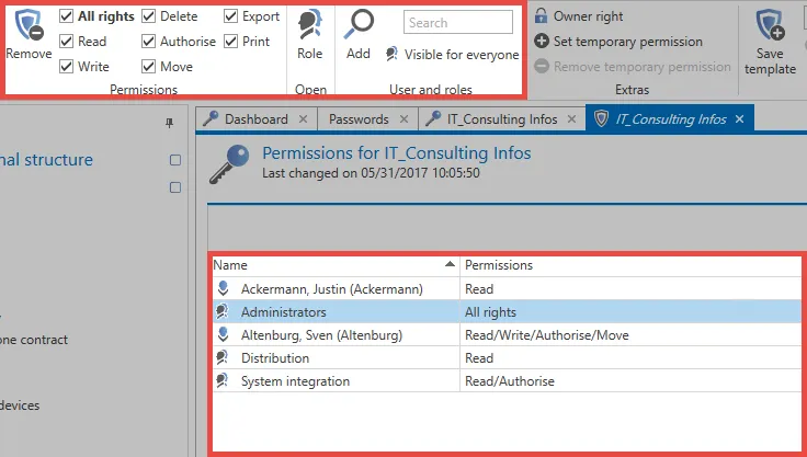

By default, all added users or roles receive only the “Read” permission on the record. The “Read” permission at the beginning is sufficient to view the fields of the data record and to use the password. "Write" permission allows you to edit a data record. The permission “Authorize” is necessary to authorize other users to the record. This is also a requirement for theSeals.
setting all permissions example

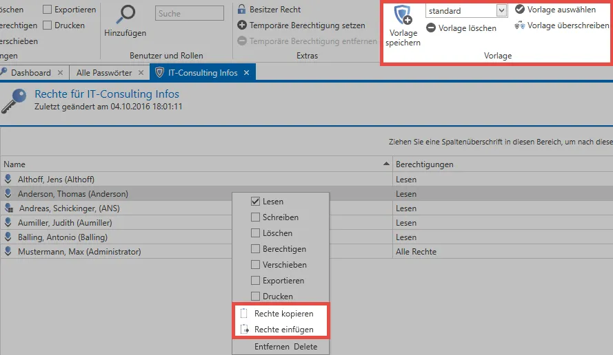

A simple right-click on a user can be used to copy and transfer permission configurations of users or roles to others in the context menu. In this context, the use of permission templates is also very practical. In the “Template” area of ​​the ribbon, you can save configured permissions, including all users, and reuse them for other records.
preset menu

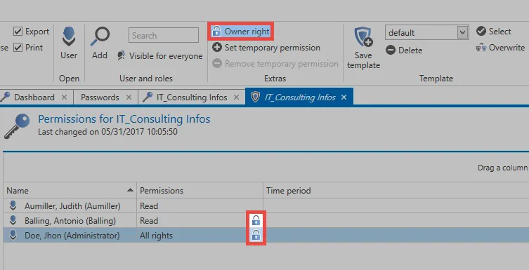

The "owner" permission can be set for a user. This permission is more of a guarantee. Once assigned, there is no way to remove the user or role. This is only possible by the user or the role itself, as well as by users with the permission “Is database administrator”.
owner permission
The owner permission prevents other users who have the “Authorize” permission from removing someone with the owner permission from the record.

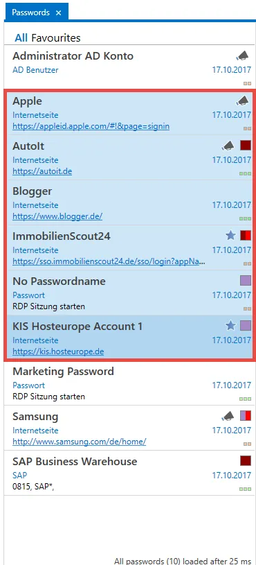

In list view, Shift or Ctrl + mouse click can be used to select multiple records. Permissions can also be granted for these records via the selection. The marked records are displayed in a different color. 6 records are marked in the following image.
password list

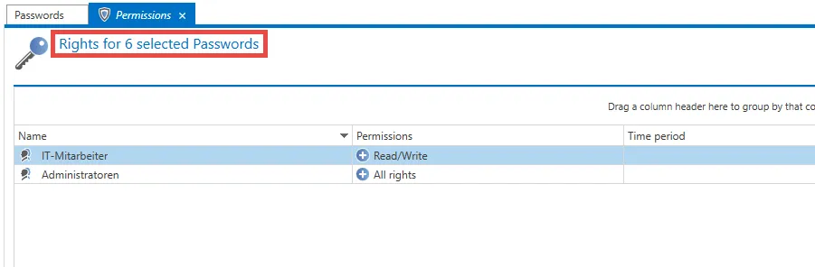

Adding permissions
To add a permission, a user or role is selected first in the ribbon under Search and add or Search. The permissions are then selected as usual in the ribbon. The :material-plus-circle-outline: symbol indicates that permissions will be added. In the following example, Mr. Steiner receives read permission to all selected records. In contrast, Mr. Brewery receives all permissions.
Reducing permissions / removing users and roles from the permissions
If you want to remove permissions, it is also necessary to add the user or the desired role to be edited. Clicking on Reduce permissions now means that permissions will be removed. This is indicated by the :material-minus-circle-outline: symbol. The selected permissions will be removed.
NOTE: If the read permission is to be removed for a user or role, the user will be completely removed from the permissions.

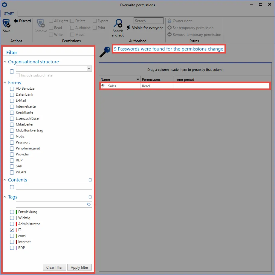

Batch processing using a filter
In some cases it is necessary to edit the permissions for a very large number of records. On the one hand, a maximum limit of 1000 records exists and on the other hand, handling a very large number of records via list view is not always the best solution. The Batch processing using a filter mode has been developed for this purpose. This is directly initiated via the ribbon.
In the subsequent dialogue, you define whether you want to expand, reduce or completely overwrite existing permissions. If you select expand or reduce at this stage, the same logic as for editing via list view is used. No permissions will thus be overwritten.
In the option overwrite permissions, the existing permissions are removed and then replaced by the newly defined permissions.
CAUTION: It is important to proceed with great caution when overwriting permissions because this function can quickly lead to a large number of records becoming unusable.
permissions adapted on a filter
The filter itself defines the selection criteria for the records to be edited. The currently configured filter will be used as default. The records that will be affected by the changes are also not displayed in this view. Only the number of records is displayed. In the following example, 9 passwords are being edited to add the read permission the role "Sales".
permissions change for selected records

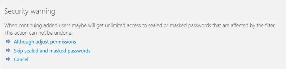

Seals and password masking
Sealed or masked records cannot be edited using batch processing. If these types of passwords are selected, a dialogue will be displayed when carrying out batch processing to inquire how these records should be handled.
security warning because of sealed or masked passwords
It is possible to select whether the affected records are skipped or whether the seal or password masking should be removed. If the remove option is selected, the process needs to be confirmed again by entering a PIN.
security warning
CAUTION: The removal of seals and password masking cannot be reversed!
