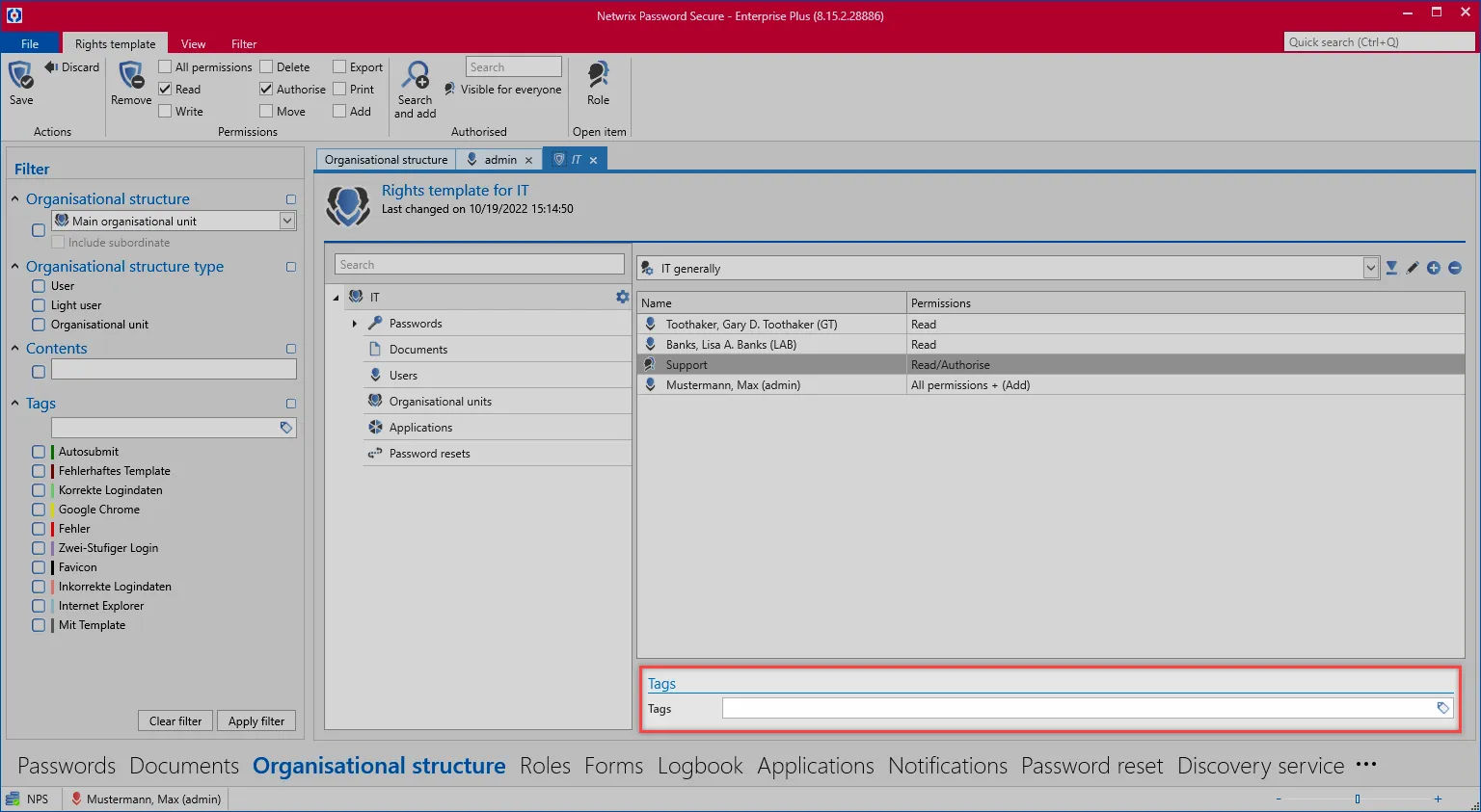

Once they have been configured, permissions can be constantly reused. The functionality Saving permissions as a template in the ribbon is used for this purpose. The templates are globally available and can also be used for other records.
NOTE: When saving templates, always select a name that will also allow it to be safely differentiated from other templates if you have a large number of right templates.
Nevertheless, the use of right templates merely reduces the amount of work and still envisages the manual setting of permissions. Automatic process for the issuing of permissions also exist in Netwrix Password Secure and will be covered in the section Predefining rights and also under "Inheritance from organisational structures".

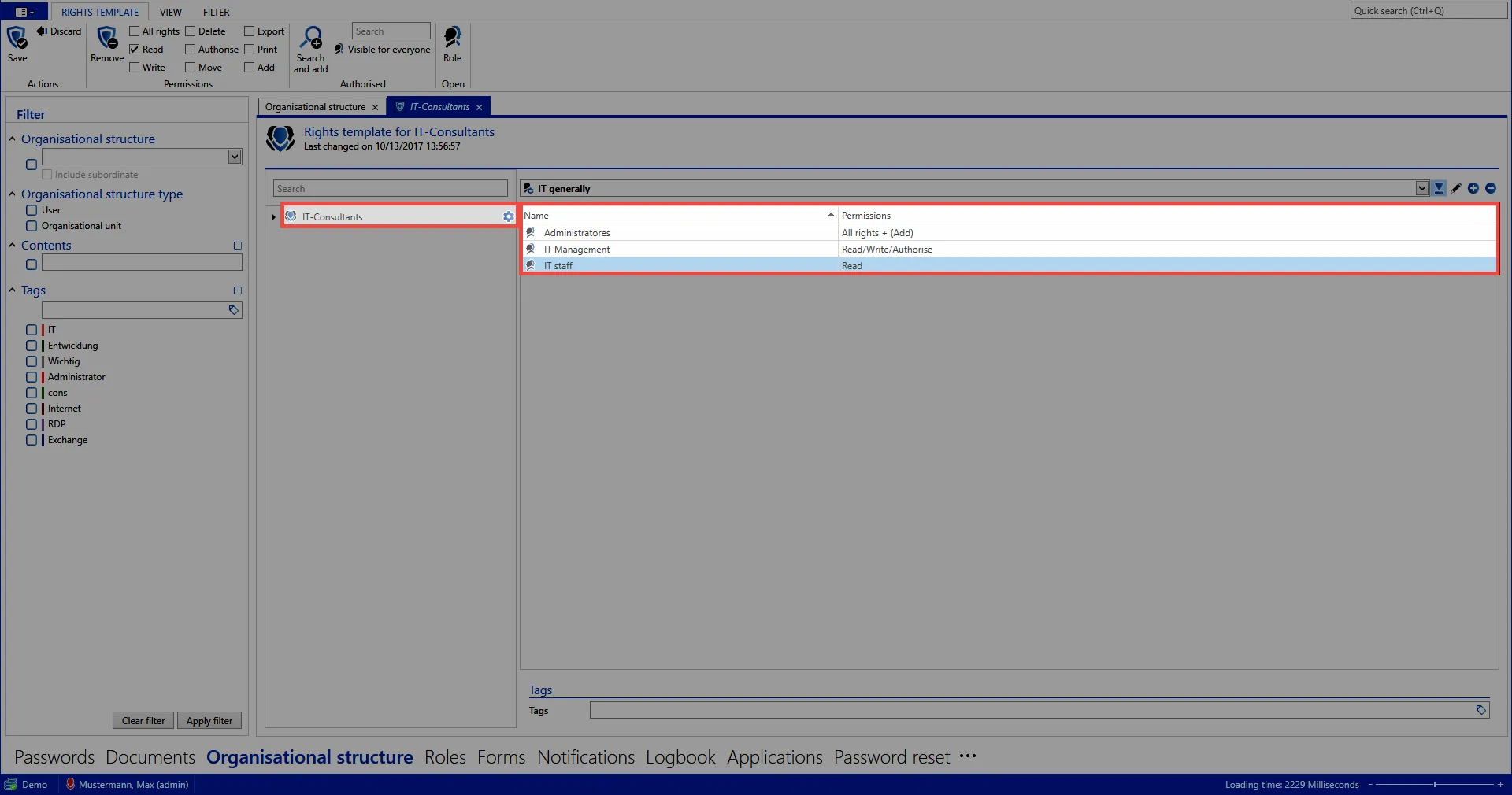

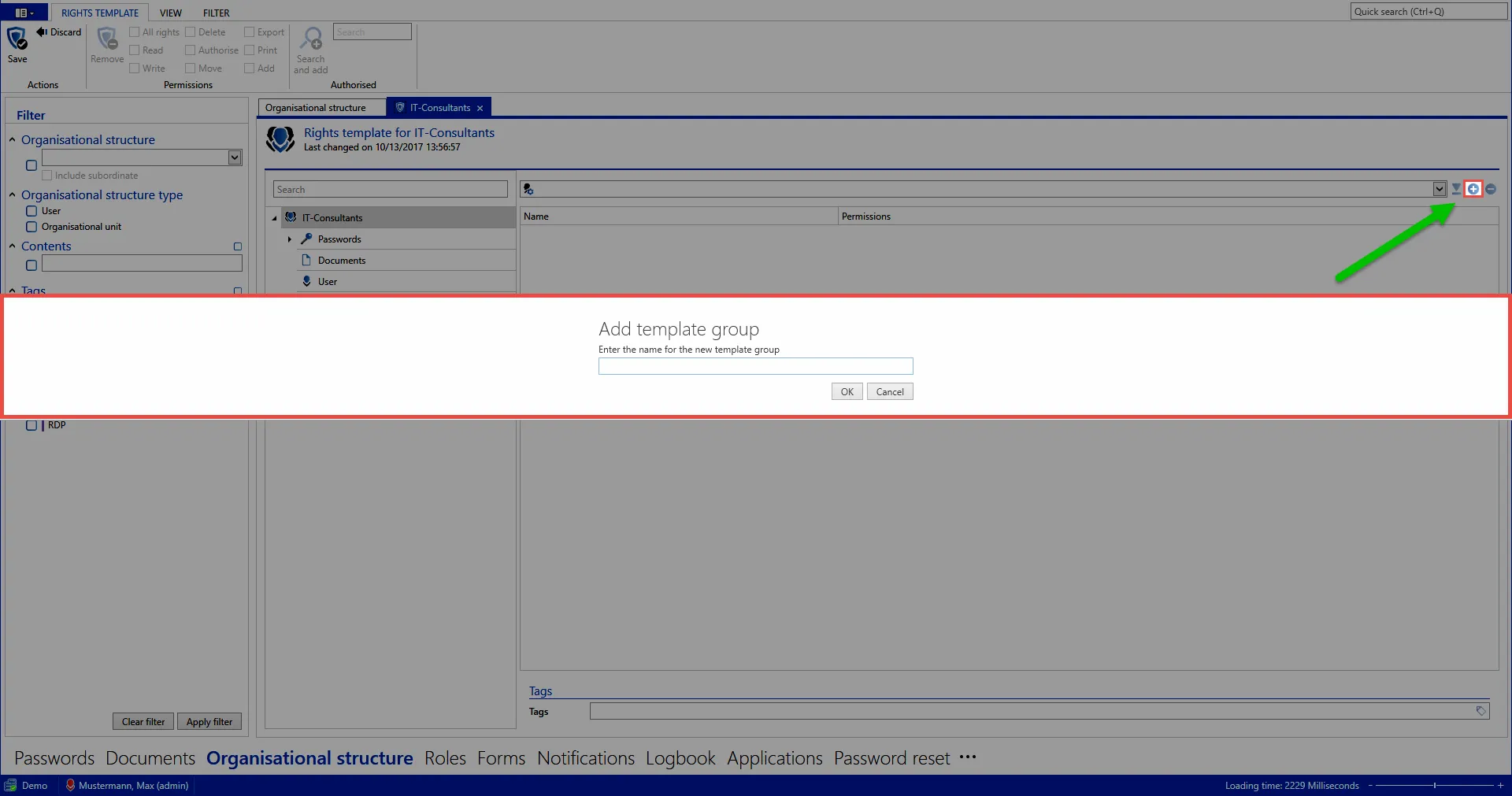

- Creating the first template group: A new window will appear after clicking on the icon for adding a new template group (green arrow) in which a meaningful name for the template group should be entered.
Roles and users can now be added to this template via the ribbon or through the context menu (right mouse click). This was already completed in the example. The role IT employee only has the "read permission", the IT manager also has the "write permission" and the capability of managing permissions. Administrators possess all available permissions. Configuration of the permission structures is explained in Manual setting of permissions.

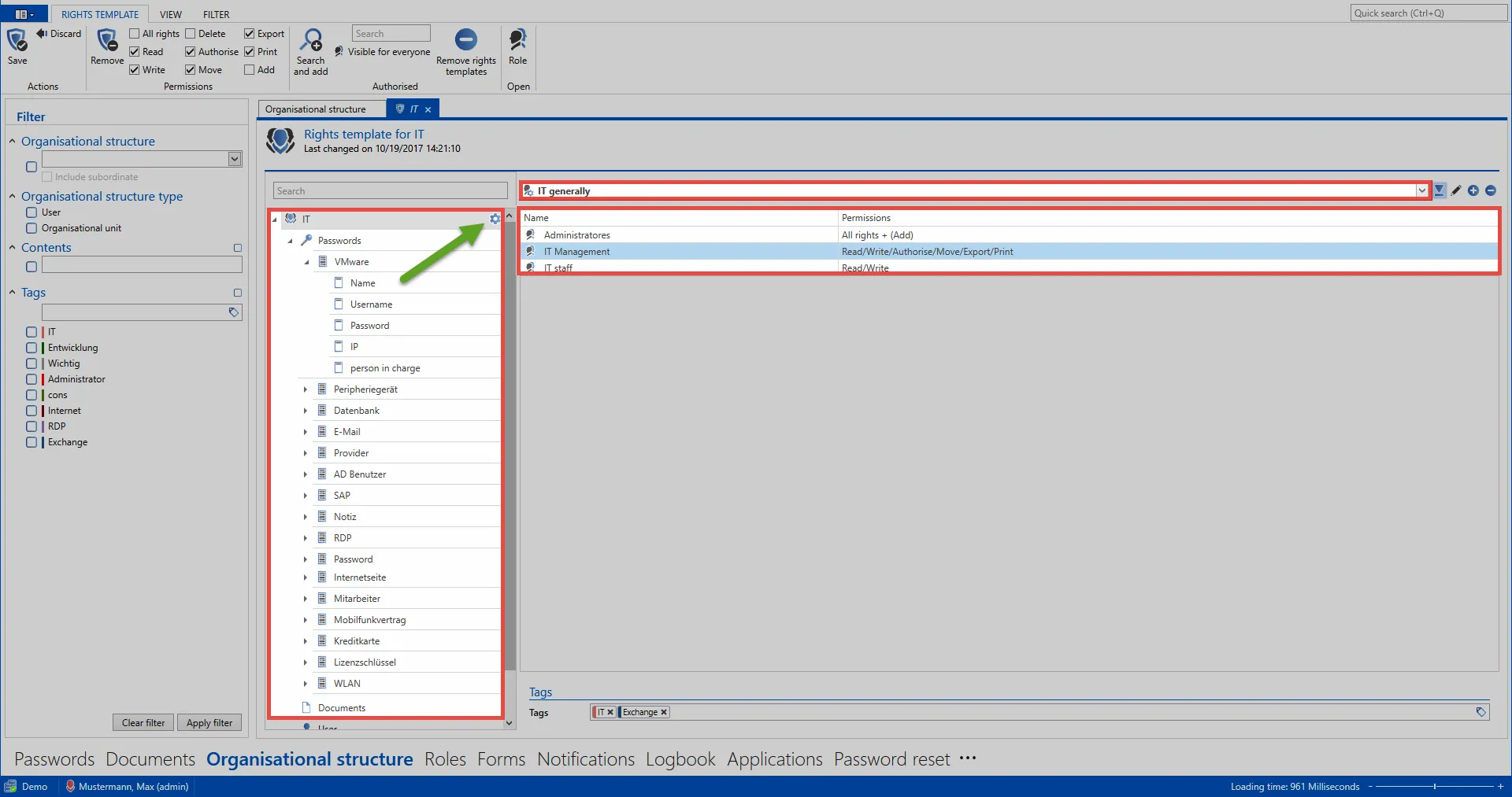

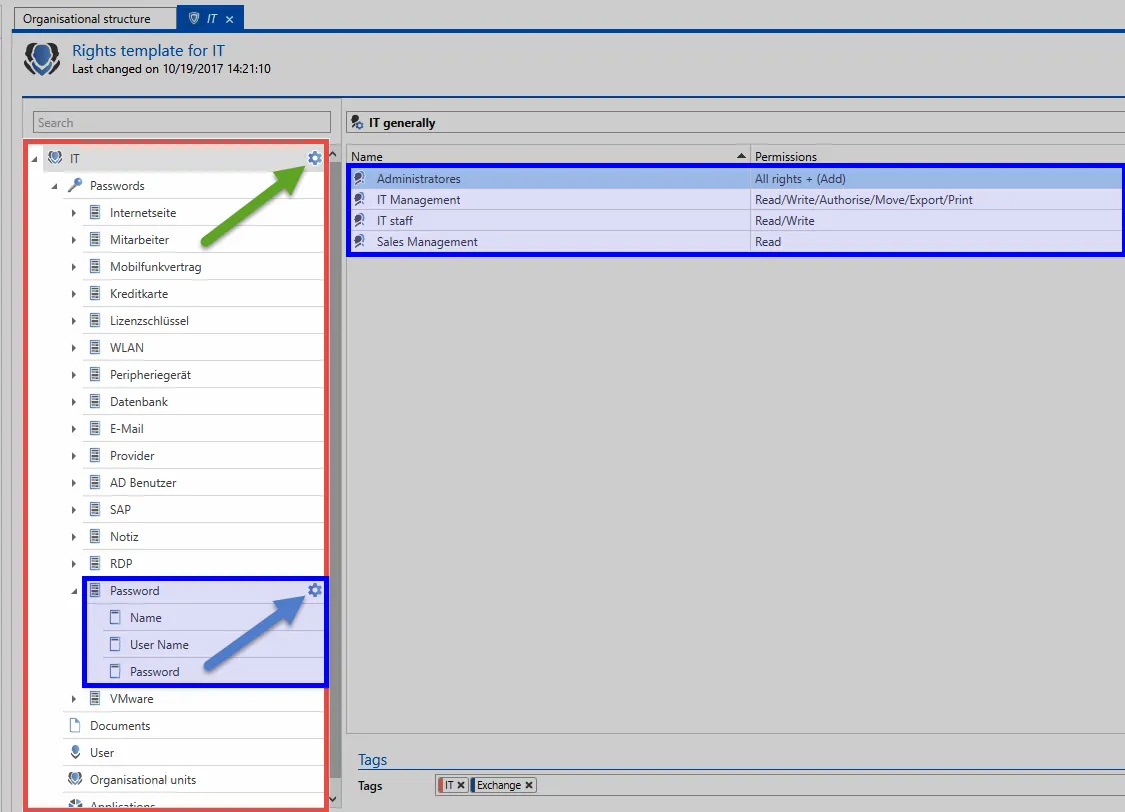

In general, all of the predefined rights for an organisational structure are applied to all underlying objects. These objects could be passwords, forms, form fields documents, users, applications or also other nested organisational structures in the hierarchy. In the following example, the rights template IT general has been defined for the organisational unit IT.
If this type of “preset” has been defined, the corresponding icon is displayed at the corresponding level (= green arrow). As no other icons exist below this level, this means that the preset is valid for all underlying objects.
The following example shows how a preset can be defined for when the “password” form is used that not only grants the existing permissions to the roles but also provides the sales manager with read rights.
As can be seen, the preset “IT general” is valid for all objects. An exception here is the “password” form because a unique preset has been defined for this form (blue arrow). As a result, all records created using the “password” form receive permissions as defined in this preset (incl. the sales manager).

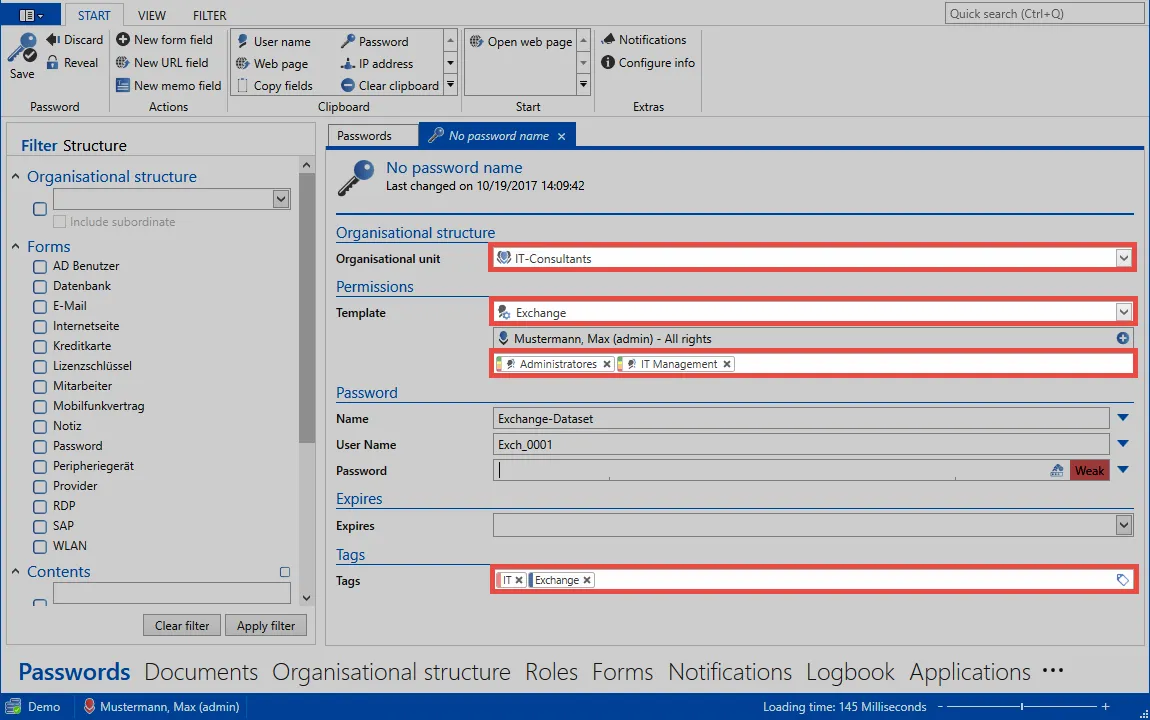

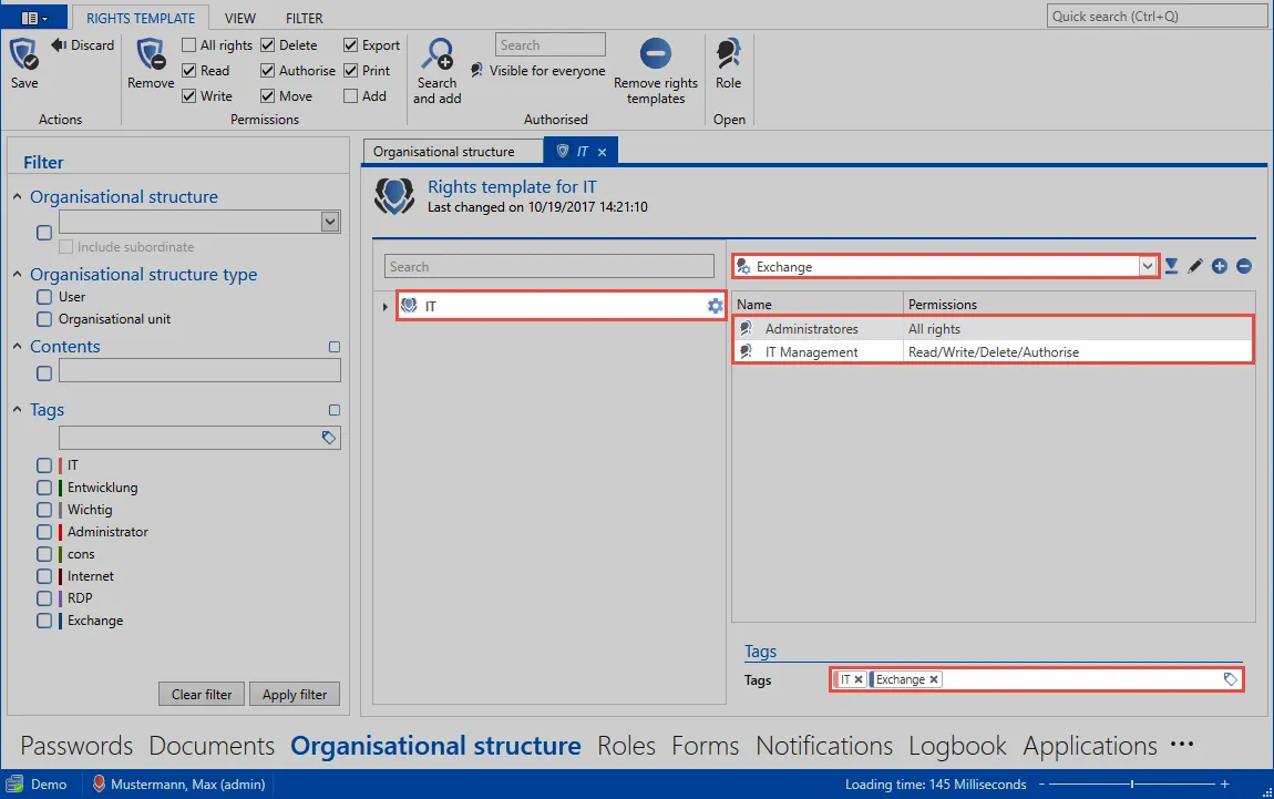

In the next window to appear, the organisational unit “IT” and the template group “Exchange” are selected.
Here is the underlying rights template as a comparison:
The relationship between them is obvious. It can be immediately seen that by selecting the organisational unit “IT” based on the rights configured in the rights template, permissions are granted for the roles “IT management” and also “Administrators”. The underlying tags “IT” and “Exchange” are also set.
Preview of the permissions to be set

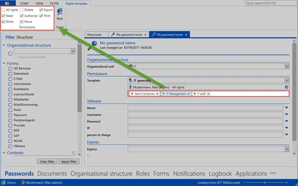

When using rights templates, the permissions to be granted can be very quickly classified via a color table. The actual permissions can also be viewed as usual via the Ribbon. The following color key is used with the associated permissions:
Color | Permission |
Green | Read |
Yellow | Write |
Orange | Delete |
Red | Authorize |
Other rights also exist that are, however, not separately indicated by a color. The overview in the ribbon can be used to see whether the “move”, “export” and “print” rights are set or not. The permissions for the selected role/user are always displayed – in this case for the role “IT management”.
