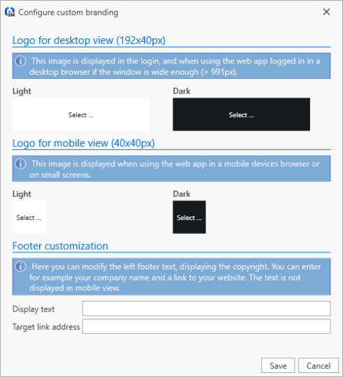

Custom Branding​
You can personalize the Web App with your company’s branding by navigating to Custom branding. There, upload your logo files and specify the custom text you want to display; the updated branding will appear across the application once saved.
Custom branding configuration
