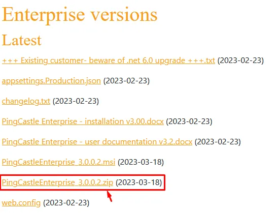

Download the software
You have to download the .zip file of the program.
The .msi file has not been designed for upgrade.
