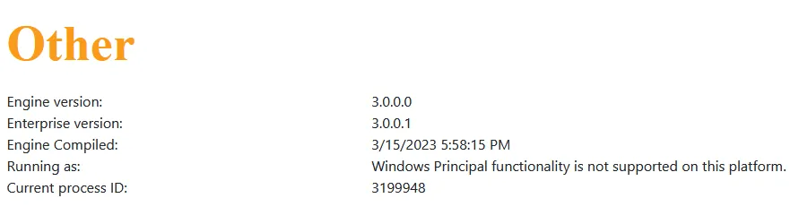

Version check
You can check the existing version using the About link at the bottom of each page.
