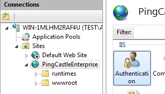

Configure IIS Binding:
- Open Internet Information Services (IIS) Manager
- Locate the PingCastleEnterprise website
- Right-click and select "Edit Bindings..."
- Click "Add..." to create a new binding
- Select "https" as the type
- Choose port 443 (or your preferred port)
- Select your SSL certificate from the dropdown
- Click OK to save

Change the application pool identity from ApplicationPoolIdentity to LocalSystem:
Open the IIS console and navigate to Application Pools
Select the PingCastle Enterprise application pool
Click Advanced Settings
Find the Identity setting and change it to LocalSystem
Restart the application pool

Windows Manual Installation:
- Extract the application ZIP file to a target directory
- Create an IIS website and application pool
- Disable the Default Web Site if it conflicts with PingCastle Enterprise
- Configure the application pool identity
- Grant SQL Server permissions to the application pool account

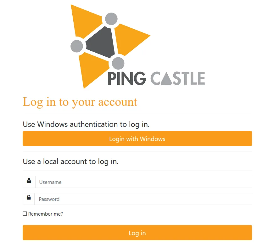

Local authentication is enabled by default and uses username and password stored in the PingCastle Enterprise database. No additional configuration is required.
To hide the local authentication option when other authentication methods are configured, add this to appsettings.json:
"disablePasswordLogon": true
When disablePasswordLogon is set to true and Windows Authentication is enabled, any account calling the API will need to be a member of the WindowsGroup that is configured for authentication.

Step 2: Enable Windows Authentication in IIS
- Close and reopen the IIS Manager console to refresh the available options.
- Select the PingCastleEnterprise website in the left-hand tree view.
- Double-click the Authentication icon in the center panel.
- In the Authentication settings, ensure the following:
- Anonymous Authentication: Enabled (should already be enabled)
- Windows Authentication: Right-click and select Enable

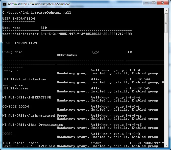

If you are already a member of the groups and have rebooted since being added you can run
whoami /all to get your group memberships and find the SID in the output

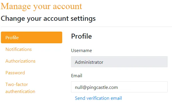

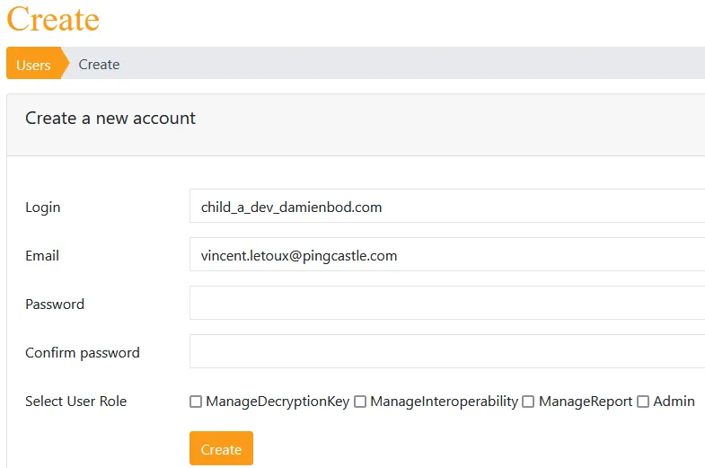

Windows Authentication doesn't provide an email address when creating accounts. Email addresses are set to a default value that disables notifications.

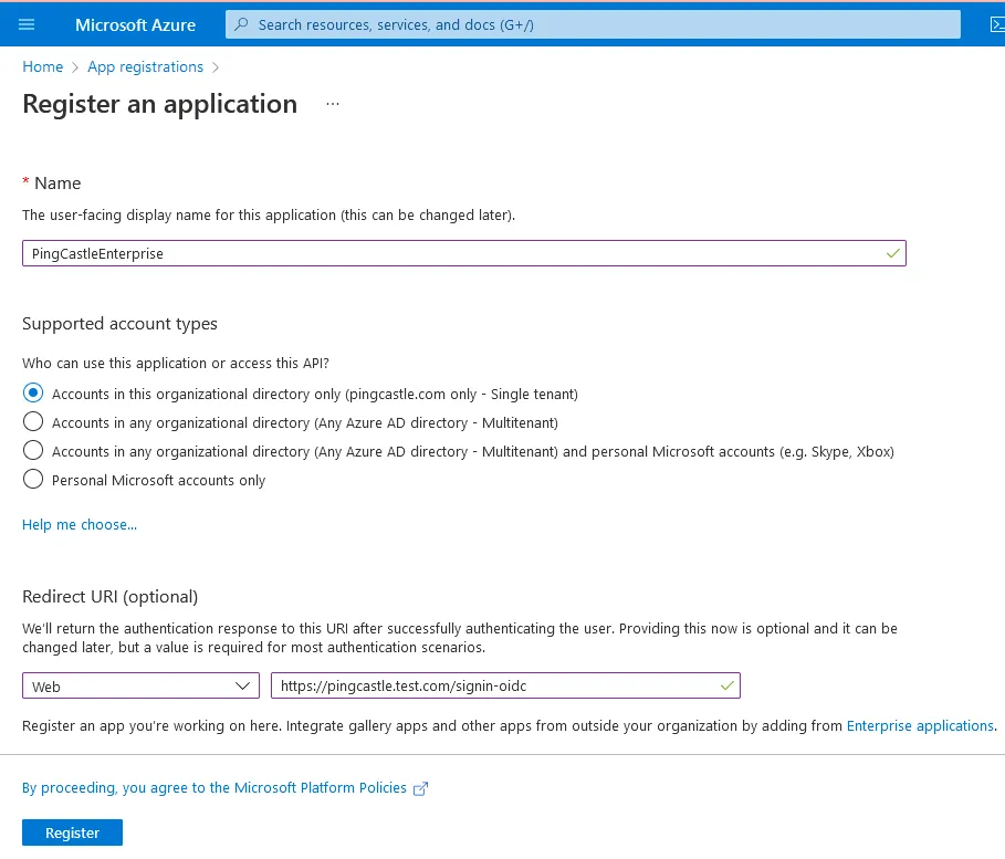

PingCastle Enterprise supports OpenID Connect authentication using the ASP.NET Core API. Configuration options are documented here.
Proxy settings rely on the current user proxy configuration, which can be defined using netsh for IIS running as SYSTEM. Entra ID can be configured as an OpenID Connect provider. Entra ID Portal Configuration Navigate to Entra ID Portal and go to "App registrations" Register a new application Set the Redirect URI as Web with the URL: The URL must end with Go to the API permissions page Click "Grant admin consent" for the application Verify the Status shows as granted Note the Application (client) ID and Directory (tenant) ID Go to the Authentication tab and enable ID tokensConfiguring Entra ID for OpenIDConnect Authentication
https://your-pingcastle-server.com/signin-oidc
/signin-oidc

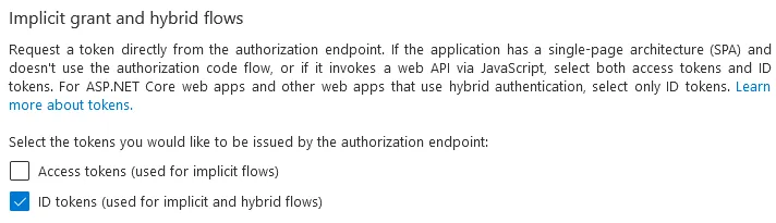

"OpenIdConnect": {
"DisplayName": "Entra ID",
"ClientSecret": "your-client-secret",
"ClientId": "your-client-id",
"Authority": "https://your-identity-provider.com/oauth2/default",
"PostLogoutRedirectUrl": "https://your-pingcastle-server.com",
"CallbackPath": "/authorization-code/callback",
"ResponseType": "code"
All parameters except PostLogoutRedirectUrl (which should point to your PingCastle Enterprise URL) are dependent on your OpenID provider.

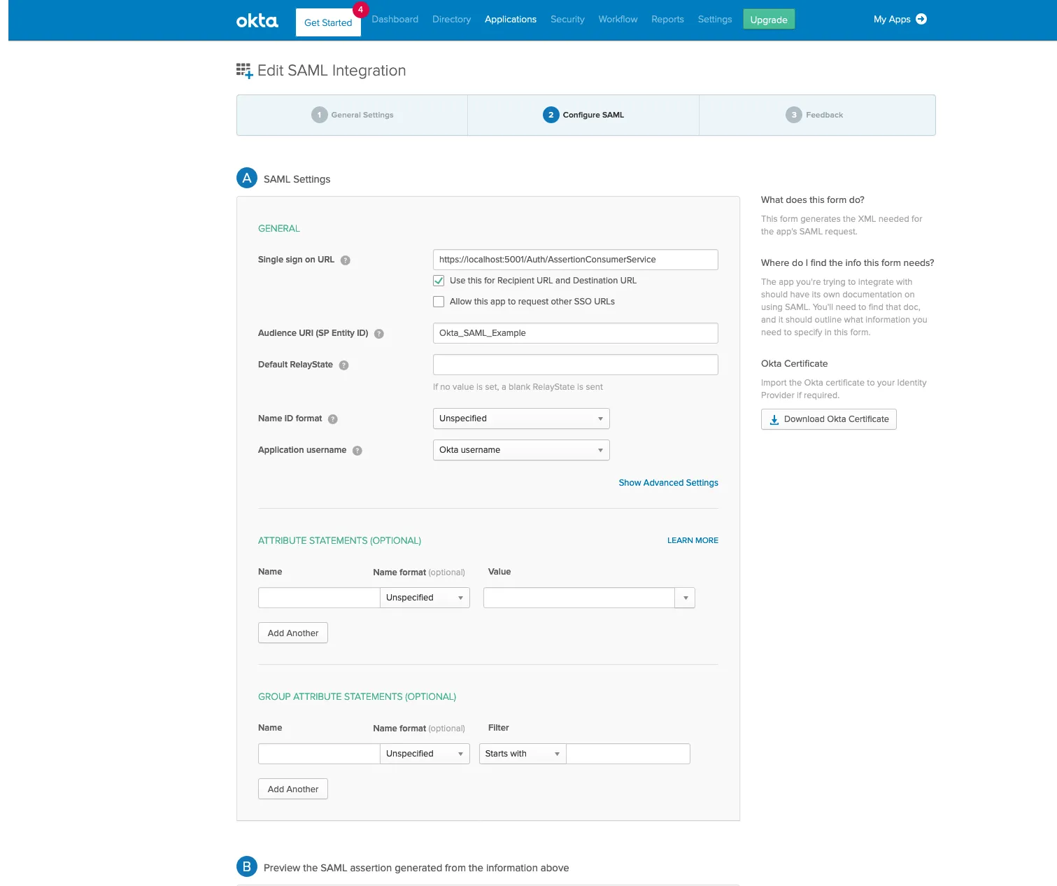

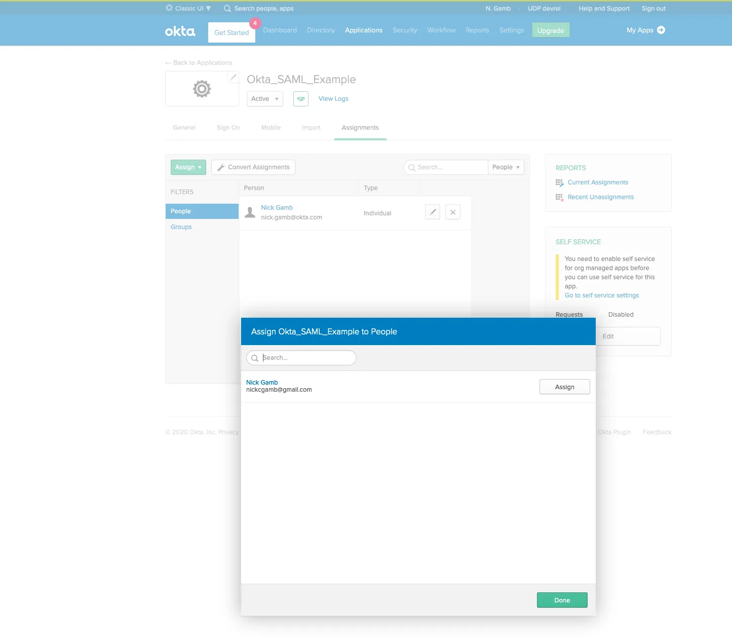

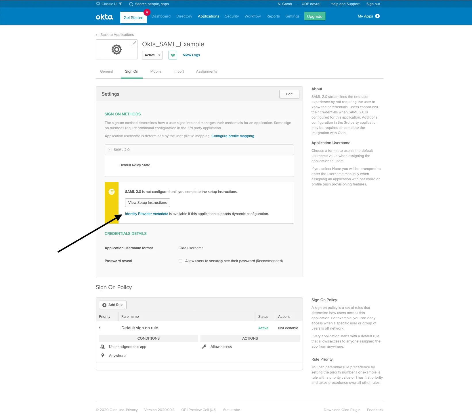

Step 1 Access Okta Admin Portal
Step 2 Create New Application
Step 3 Name Your Application
Step 4 Configure SAML Settings
Setting Value Single Sign on URL https://your-pingcastle-server.com/Saml2/AssertionConsumerServiceAudience URI PingCastle (or match your Issuer setting)
Step 5 Get IdP Metadata URL
Step 6 Assign Users
Step 7 Restart and Test

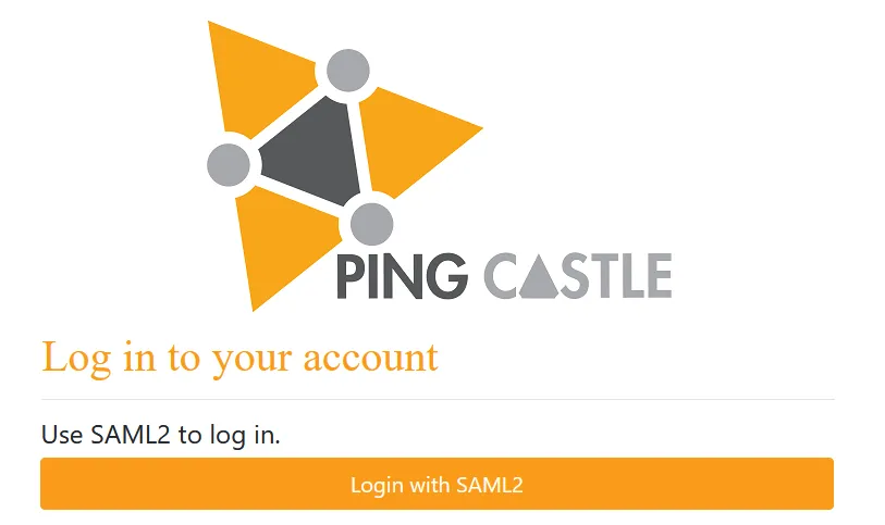

- Simple (Metadata URL)
- Advanced (Full Configuration)
- ADFS
This configuration fetches IdP metadata automatically from a URL:
"Saml2": {
"DisplayName": "SAML2",
"IdPMetadata": "https://your-idp.com/saml/metadata",
"Issuer": "PingCastle"
When using IdPMetadata, PingCastle Enterprise accesses the metadata URL at application startup. If the URL is unavailable, PingCastle Enterprise will be unavailable until you run IISRESET and the metadata becomes accessible. For production environments, consider using the full configuration.

"Saml2": {
"Issuer": "https://your-adfs-server/Saml2/Login",
"IdPMetadata": "https://your-adfs-server/FederationMetadata/2007-06/FederationMetadata.xml"
Customizing Display Name
Customize the button text on the login page:
"Saml2": {
"DisplayName": "Login with Okta",
Hiding Local Authentication
To hide the internal username/password login option:

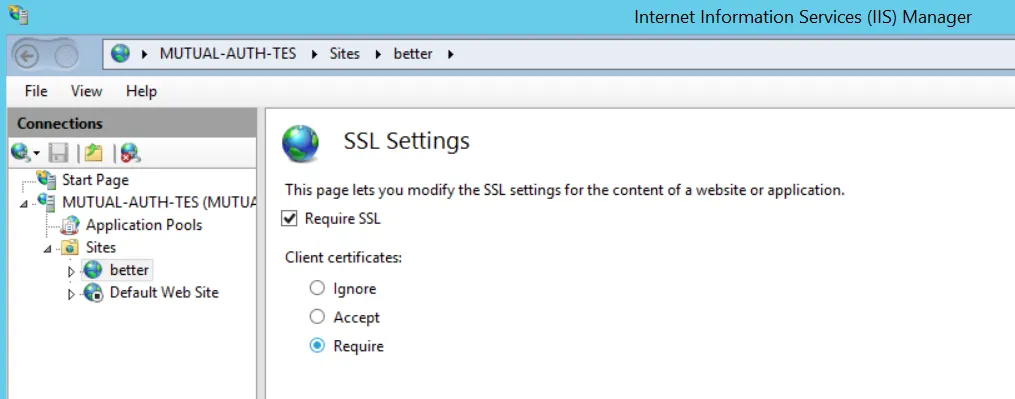

IIS Configuration
Configure IIS to require or accept client certificates. This requires HTTPS access.
The server will request a certificate when the website is accessed.
Set the certificate requirement to Accept (not Require) to allow API access without certificates, or configure a separate virtual host for API access.
If certificate settings are changed, close and reopen the browser to avoid connection cache reuse.

User Account Setup
Create a user account with a login matching the certificate subject (DNS form). No password is required.

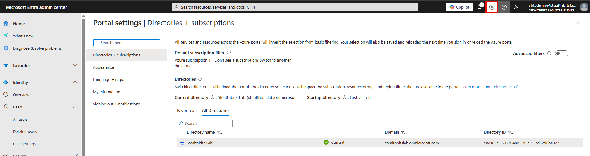

- If you have access to multiple tenants, use the Settings gear icon in the top menu to switch to the correct tenant

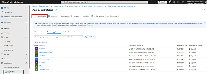

Step 2: Navigate to App Registrations
- In the left navigation pane, expand Identity
- Click Applications
- Select App registrations
- Click + New registration at the top of the page

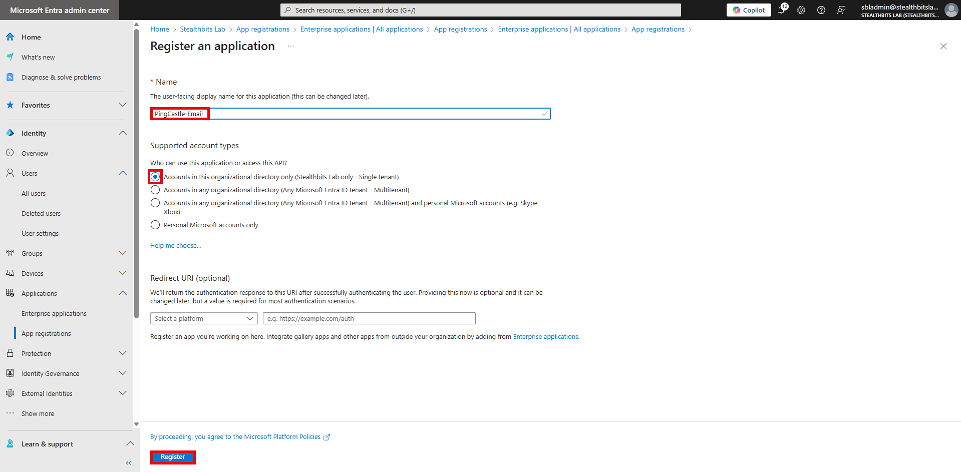

Step 3: Configure Application Registration
- In the Name field, enter:
PingCastle-Email - Under Supported account types, select Accounts in this organizational directory only
- Leave Redirect URI (optional) blank for now
- Click Register

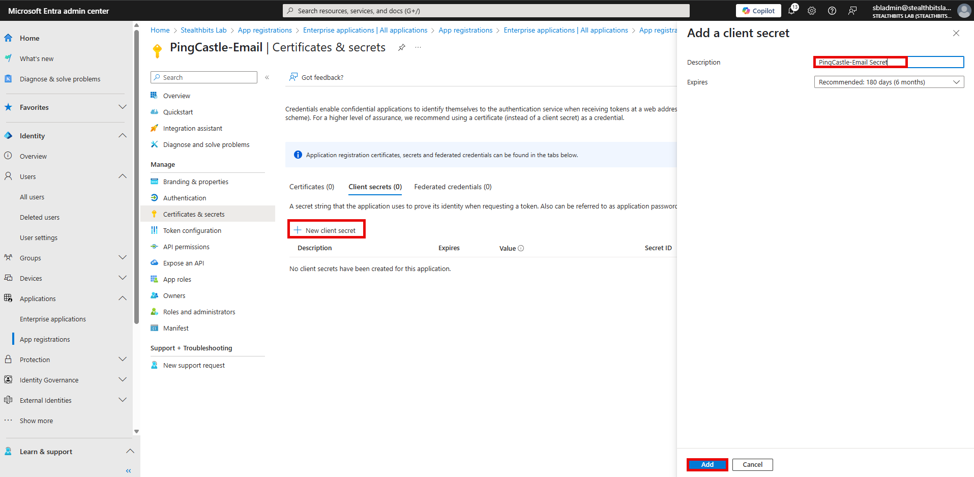

Step 4: Create Client Secret
- In the left menu under Manage, click Certificates & secrets
- Click + New client secret
- Add a description:
PingCastle-Email Secret - Set expiration to 12 months (or as per your policy)
- Click Add
- Important: Copy the secret Value immediately - it won't be shown again
- Paste it in Notepad or a password manager for later use
If you misplace your secret, you can return to this screen and generate a new one.

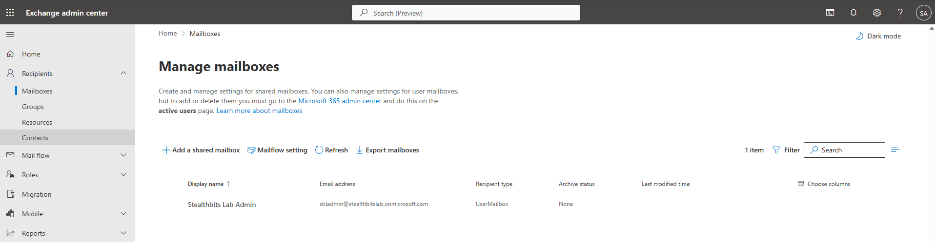

Part 2: Create Shared Mailbox
Step 5: Access Exchange Admin Center
- Navigate to https://admin.exchange.microsoft.com
- Sign in with your Exchange administrator account
- In the left navigation, expand Recipients
- Click Mailboxes

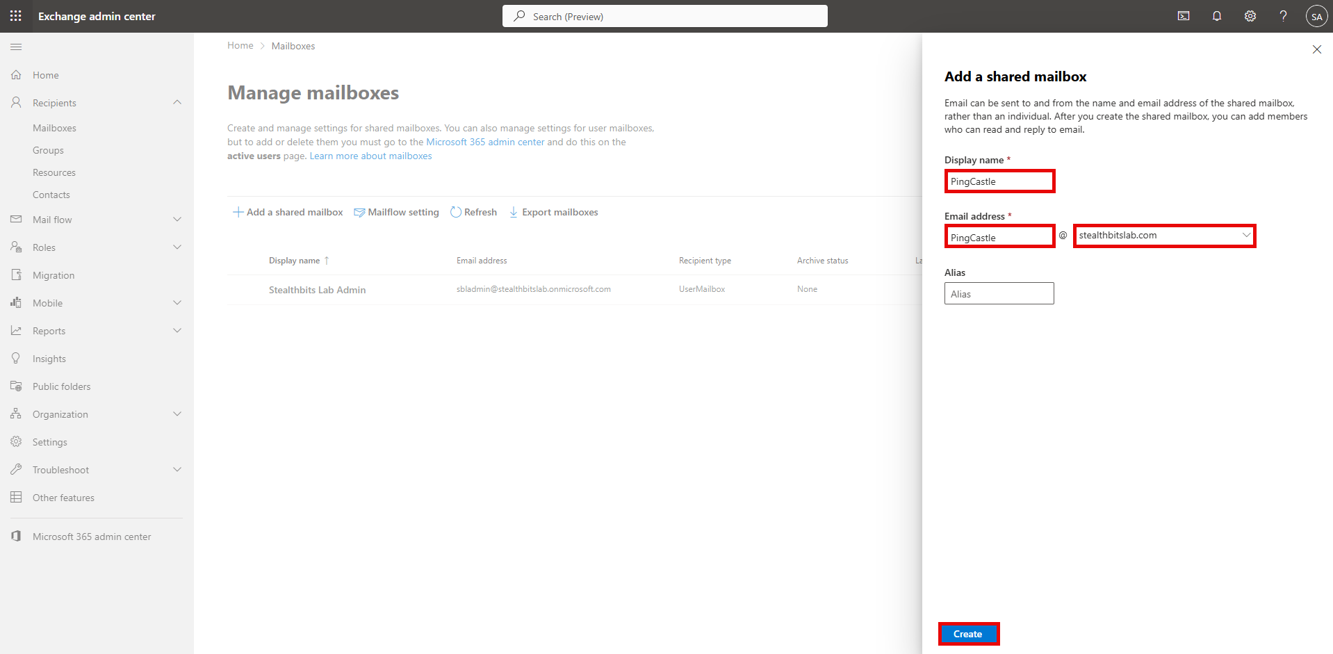

Step 6: Create Shared Mailbox
- Click + Add a shared mailbox
- Fill in the following details:
- Display Name: PingCastle
- Email Address: pingcastle (the domain should auto-populate with your domain)
- Alias: pingcastle (optional)
- Click Create
Step 7: Verify Shared Mailbox Creation
- Wait for the mailbox creation process to complete
- Verify the mailbox appears in the mailboxes list
- Note the full email address (e.g.,
pingcastle@yourdomain.com)
Step 8: Block Shared Mailbox Sign-in
This should be automatically configured, but verify it:
- Navigate to https://entra.microsoft.com/
- Go to Users > All Users
- Search for and select the user account corresponding to the shared mailbox
- Click Edit Properties
- Click the Settings tab
- Ensure the Account Enabled checkbox is unchecked
- Click Save

# Step 3: Create Azure AD App Registration
Write-Host "Step 3: Creating Azure AD App Registration..." -ForegroundColor Yellow
$AppRegistration = New-MgApplication -DisplayName $AppName -SignInAudience "AzureADMyOrg"
if ($AppRegistration) {
Write-Host "App Registration created successfully" -ForegroundColor Green
$Results.AppRegistration = @{
ApplicationId = $AppRegistration.AppId
ObjectId = $AppRegistration.Id
DisplayName = $AppRegistration.DisplayName

# Step 5: Create Authentication Credential
Write-Host "Step 5: Creating Authentication Credential..." -ForegroundColor Yellow
if ($CertificateAuth -and $CertificatePath) {
# Certificate-based authentication
if (Test-Path $CertificatePath) {
$Certificate = New-Object System.Security.Cryptography.X509Certificates.X509Certificate2($CertificatePath)
$KeyCredential = @{
Type = "AsymmetricX509Cert"
Usage = "Verify"
Key = $Certificate.RawData
Update-MgApplication -ApplicationId $AppRegistration.Id -KeyCredentials $KeyCredential
Write-Host "Certificate credential added" -ForegroundColor Green
$Results.AppRegistration.AuthenticationType = "Certificate"
$Results.AppRegistration.CertificateThumbprint = $Certificate.Thumbprint
} else {
throw "Certificate file not found at: $CertificatePath"
} else {
# Client secret authentication
$ClientSecret = Add-MgApplicationPassword -ApplicationId $AppRegistration.Id -PasswordCredential @{
DisplayName = "PingCastle-Email Secret"
EndDateTime = (Get-Date).AddMonths($ClientSecretExpiration)
Write-Host "Client secret created (expires in $ClientSecretExpiration months)" -ForegroundColor Green
$Results.AppRegistration.ClientSecret = $ClientSecret.SecretText
$Results.AppRegistration.SecretId = $ClientSecret.KeyId
$Results.AppRegistration.AuthenticationType = "ClientSecret"
# Step 6: Connect to Exchange Online
Write-Host "Step 6: Connecting to Exchange Online..." -ForegroundColor Yellow
Connect-ExchangeOnline -ShowBanner:$false
# Step 7: Create Shared Mailbox
Write-Host "Step 7: Creating Shared Mailbox..." -ForegroundColor Yellow
# Check if mailbox already exists
$ExistingMailbox = Get-Mailbox -Identity $SharedMailboxAddress -ErrorAction SilentlyContinue
if (!$ExistingMailbox) {
$SharedMailbox = New-Mailbox -Shared -Name $SharedMailboxDisplayName -PrimarySmtpAddress $SharedMailboxAddress -Alias $SharedMailboxName
if ($SharedMailbox) {
Write-Host "Shared mailbox created successfully" -ForegroundColor Green
$Results.SharedMailbox = @{
DisplayName = $SharedMailbox.DisplayName
PrimarySmtpAddress = $SharedMailbox.PrimarySmtpAddress
Alias = $SharedMailbox.Alias
Created = $true
} else {
Write-Host "! Shared mailbox already exists" -ForegroundColor Yellow
DisplayName = $ExistingMailbox.DisplayName
PrimarySmtpAddress = $ExistingMailbox.PrimarySmtpAddress
Alias = $ExistingMailbox.Alias
Created = $false
# Step 8: Block shared mailbox sign-in
Write-Host "Step 8: Blocking shared mailbox sign-in..." -ForegroundColor Yellow
$MailboxUser = Get-Mailbox -Identity $SharedMailboxAddress
if ($MailboxUser.ExternalDirectoryObjectId) {
Update-MgUser -UserId $MailboxUser.ExternalDirectoryObjectId -AccountEnabled:$false
Write-Host "Shared mailbox sign-in blocked" -ForegroundColor Green

Initial startup
At the first run of the application, the application creates the database. If there is an error with the database (missing right, invalid connection string) or hosting, the application won't display the next screen.
For security reasons, there is no default account or password.
When there is no user configured in the application, a special screen appears to create the first user. This user receives the "Admin" role.

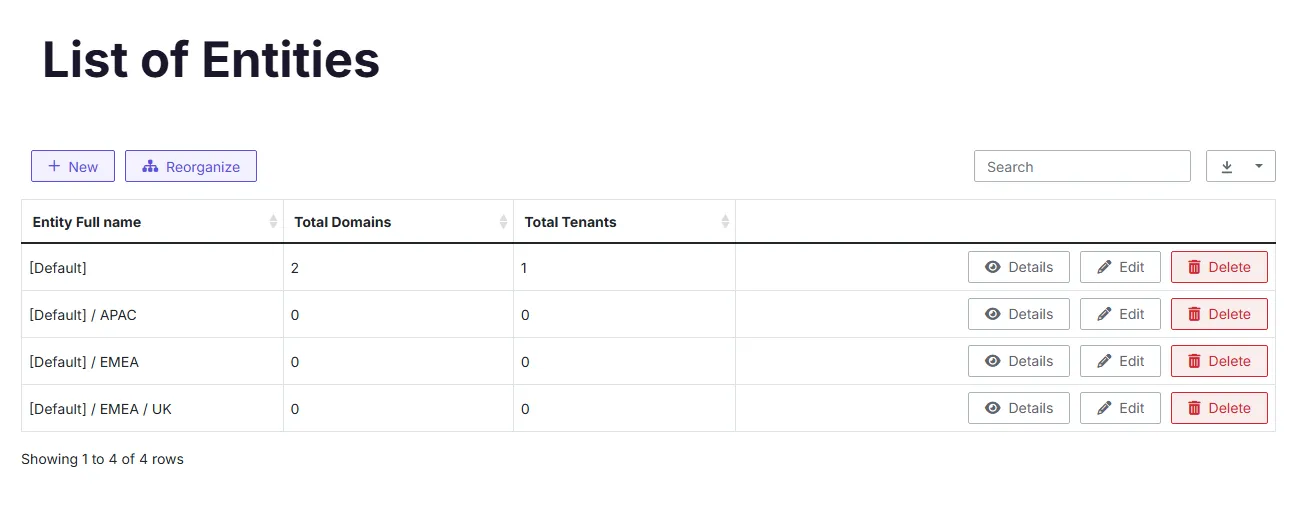

Entities
Entities are created at Configuration -> Entities and implement Role-Based Access Control (RBAC) by assigning permissions to users for groups of domains. This controls access for email notifications and enables targeted dashboards.
PingCastle configures a default entity named "Default" where auto-created domains are assigned. You can create additional entities and build a hierarchy by setting parent relationships.
For bulk configuration, use Configuration -> Interoperability to edit the entity hierarchy using an Excel file (compatible with the PingCastleReporting tool format).

Reset Administrator Password
If no administrators are available (password forgotten or the administrator has left the company), you can reset PingCastle to Initialization mode to create a new administrator account.
Steps:
Open your database management tool and navigate to the
AspNetUserstable. -
Locate the administrator account (use the email address to find it) and delete that row.
Restart the PingCastle Enterprise application.
On the next visit to the web portal, the application will detect that no administrator exists and automatically switch to initialization mode.
Follow the prompts to create a new administrator account.
This procedure only removes the administrator account. All other data (users, domains, reports) remains intact in the database.
