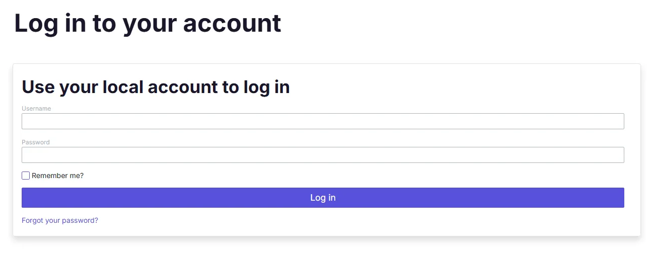

Authentication using login/password:
When the login / password method is configured (by default), a password recovery mechanism by email and a two-factor authentication method are provided.

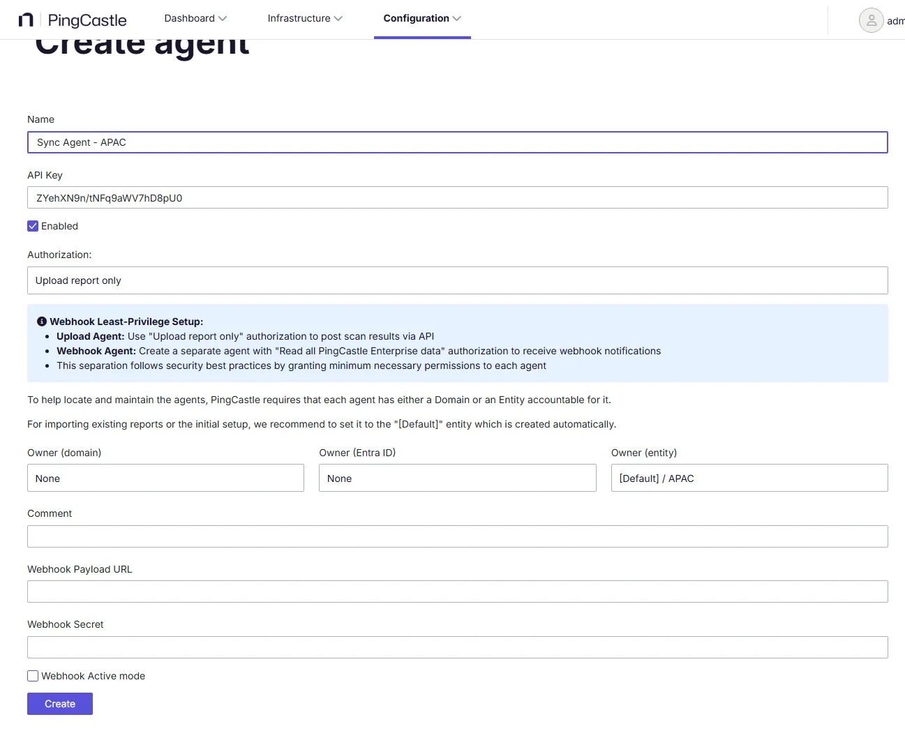

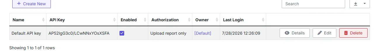

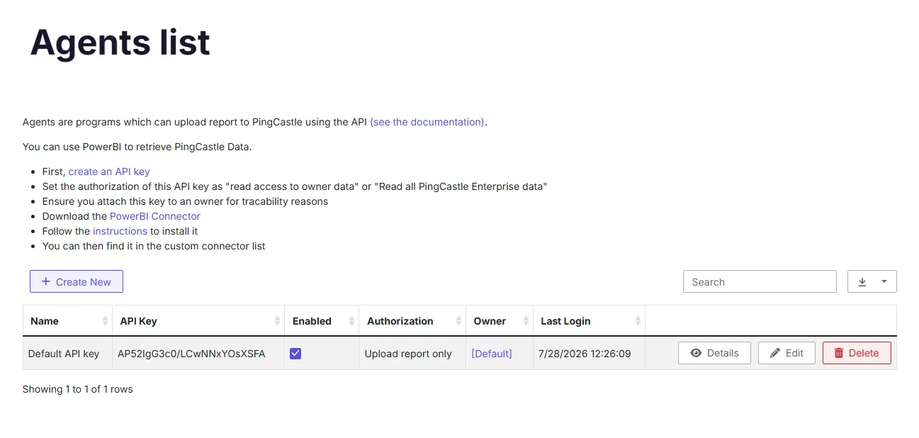

From the "Configuration" tab, you first need to get an API key using the "Agents" page and configurate the PingCastle agent accordingly.
The first step is to create an Agent API key. Click the create button to reach the creation page.
To map the agent to a responsible, the Owner field must be completed. It can be an entity or a domain, such as the "default" entity.
The API key is generated automatically but can be changed if the complexity requirements are met.
After this is set up correctly, you can directly upload reports automatically using the command:
pingcastle --healthcheck --api-endpoint <endpoint> --api-key <key>
- By default, all detailed information will be filtered. To avoid this behavior, the command line can to be changed to:
pingcastle --healthcheck --api-endpoint <endpoint> --api-key <key> --level Full
The API can be browsed using the link found in the agent page:
