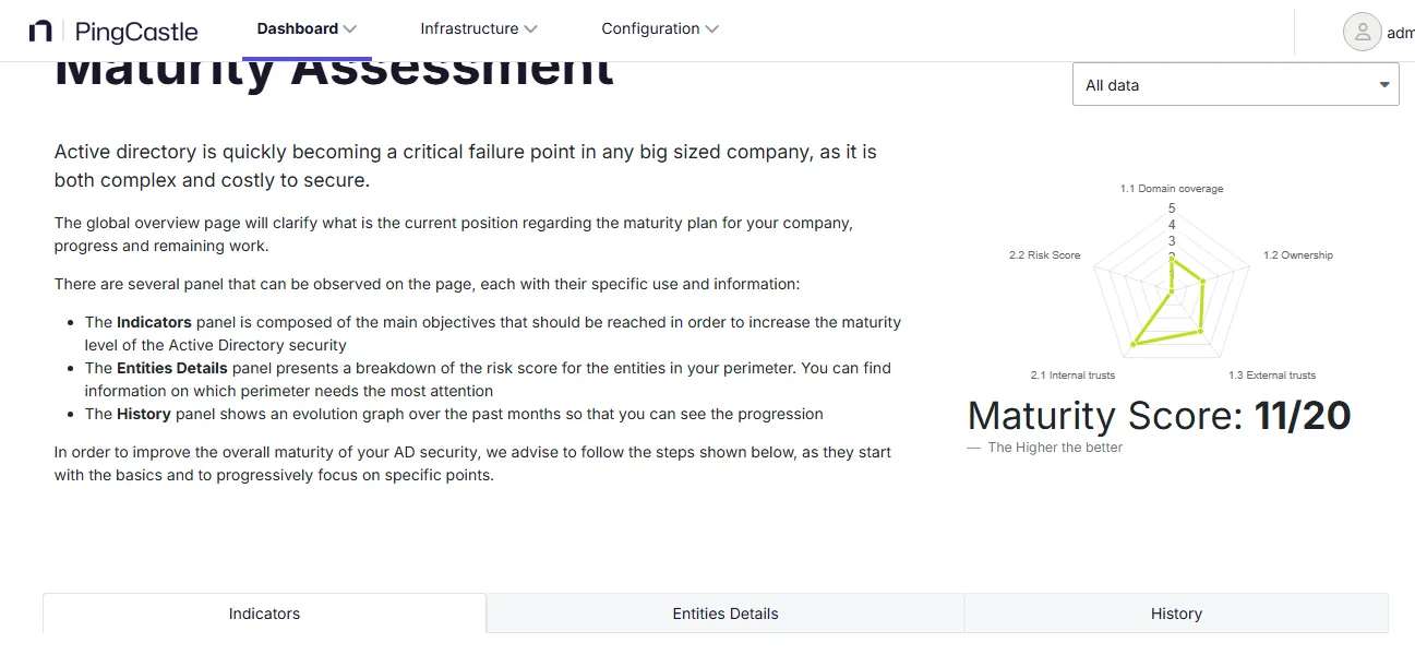

The "Maturity Assessment" divides a maturity evaluation into two areas. Each area groups several measures, for a total of five measures across both areas. Several detailed KPIs make up each measure, for a total of 20 detailed KPIs.
Each KPI for which the company AD is compliant gives 1 point in the total, ending in a score out of 20 that you can view in a radar chart.
To go into more detail, the tool computes this score on the first two levels of the Capability Maturity Model Integration (CMMI) methodology applied to AD:

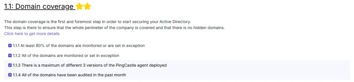

Each measure has its own detailed page, where you can find more information on how to improve the situation and how to gain the associated "star". A star indicates whether a single rule linked to a measure is raising an alert.

These general pages help users understand the current level of protection of the company Active Directory. Use this page to understand the work performed and the remaining work for AD security.
Click the Get more details button to switch to a more detailed dashboard.

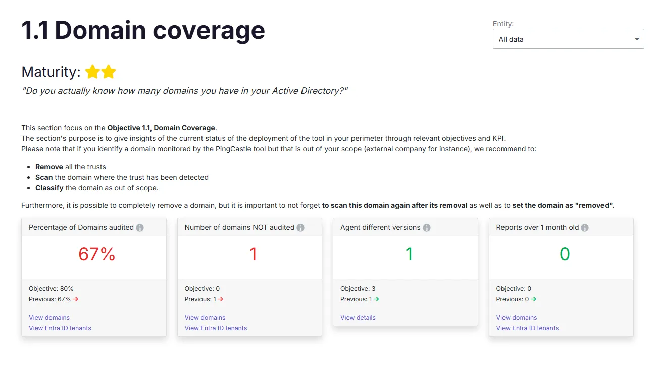

Each area has a dedicated page with a lot of information about what you do well and what you can improve.

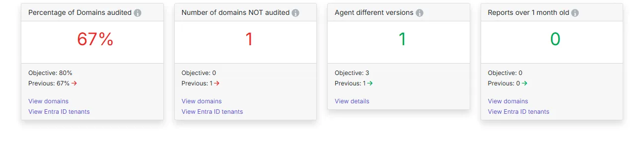

The first section of the page always shows a global explanation of the objective of the area.
Then, it displays a few KPIs that compose the maturity evaluation. If you reach the objective, the KPI appears in green; otherwise, it appears in red. A "Detail" button takes you directly to the technical view, with advanced information on how to remediate and improve the KPI.

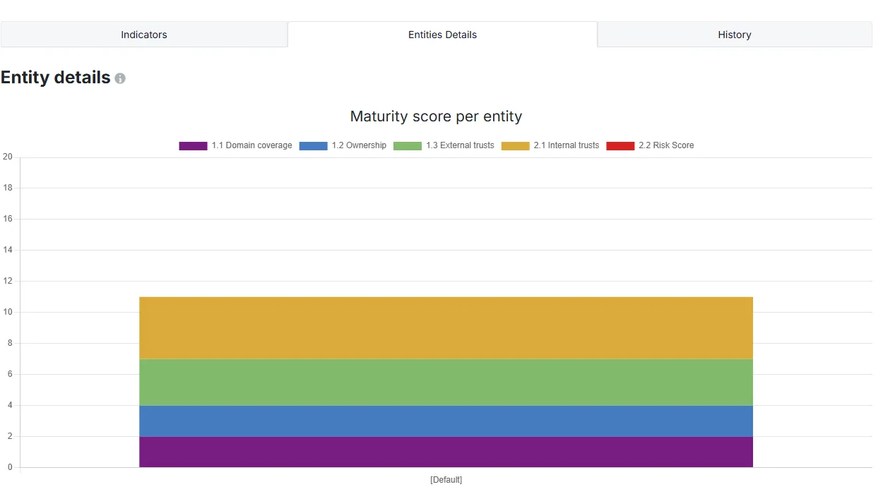

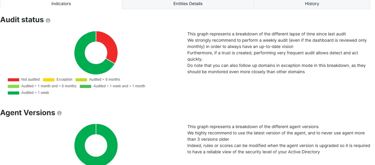

The second section offers different kinds of detailed information in different tabs. This information can be a couple of indicators that help you understand the situation better, a breakdown of the information shown by entity within the selected perimeter, or a history graph representing how the KPI evolved in the past.
Each chart is dynamic, and you can filter out a category by clicking it in the legend. You can also click certain data points to go directly to the page containing the data behind the chart.
Indicators for the related tab:
Entities Details for the related tab:

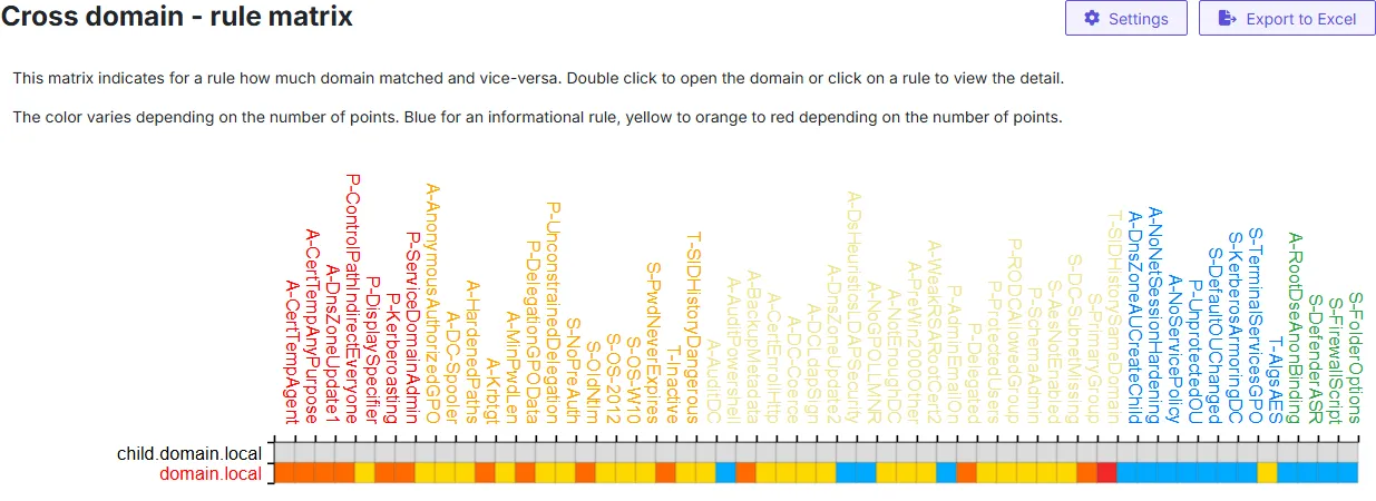

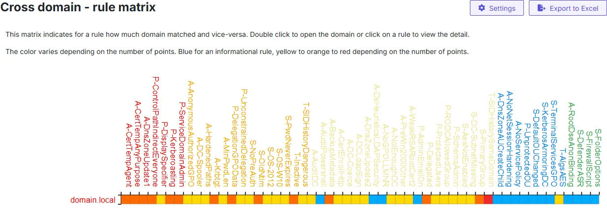

The "Rule Matrix" view aggregates every rule used in the 4 categories to calculate the Global Risk score. With this feature, you can identify the main points of failure within your Active Directory and then implement the associated remediation plan.
It takes the form of a double entry table, with all the domains within your perimeter on one side, and all the rules and whether they're OK or not on the other. You can filter it to show only relevant information (that is, what affects your security negatively), and you can also download it in CSV format.
Use this dashboard to set up a taskforce and a remediation project.

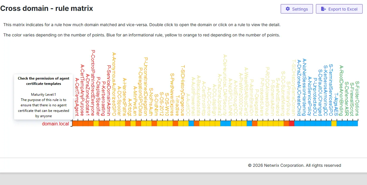

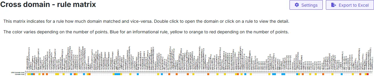

The first view is a matrix with all the rules in columns and all the domains in lines.
Global problems appear as a vertical line (affecting a rule), and local problems appear as a horizontal line (affecting a domain).
PingCastle recommends working on a unit consisting of 10 to 15 domains. After you make the selection, PingCastle recommends ordering the items by maturity level and removing the blank items.
Une image contenant texte Description générée automatiquement
The result is a matrix of about 15 to 20 domains, where each colored cell represents a rule that matched.
You can view the detail by pointing at the cell, and a click forwards you to the detail of the report.

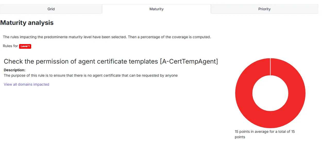

To see the top rules to fix to improve the maturity or the score, select the "Maturity" or "Priority" tab.

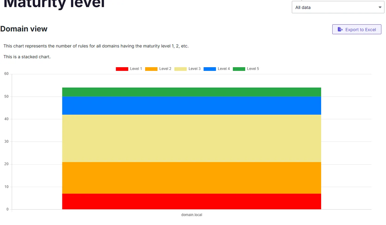

This view lets you compare the number of rules per domain in a selected entity.
