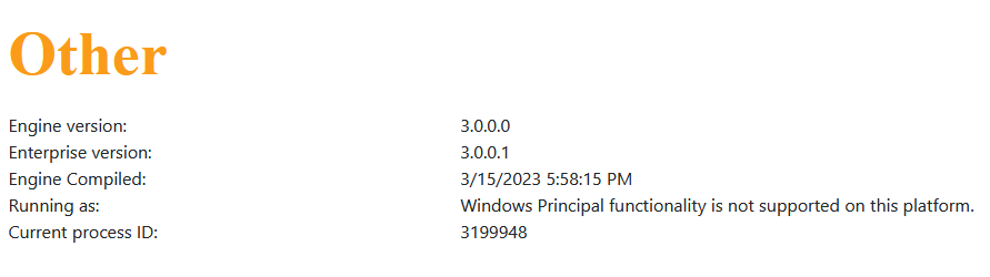

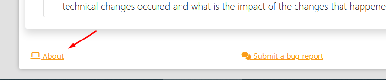

Version check
You can check the existing version using the About link at the bottom of each page.

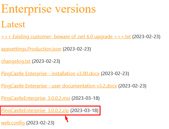

Download the software
You have to download the .zip file of the program.
The .msi file has not been designed for upgrade.

You should check that the version of the application changed in the about page.
