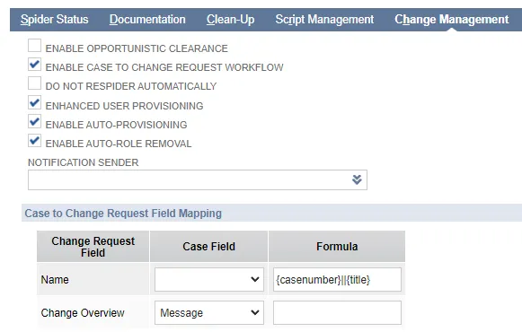

Change Management
Accesses change management features:
- Enable Opportunistic Clearance: enables automatic clearance of qualifying low risk non-compliant changes. Default is off.
- Enable Case to Change Request Workflow: enables the workflow
Create Change Request from Case,
based on the provided mappings. Change Request Field Mapping includes an optional Formula to
handle complex fields. After the Enable Case to Change Request Workflow is enabled, a Create
Change Request button is available on the Case record (Lists > Support >
Cases).
Here is an example using a Formula for the Case to Change Request Field Mapping:
- Do Not ReSpider Automatically: sets the default condition for the Do Not ReSpider
Automatically setting on the
ITGC Change Request. The default is
unchecked.
