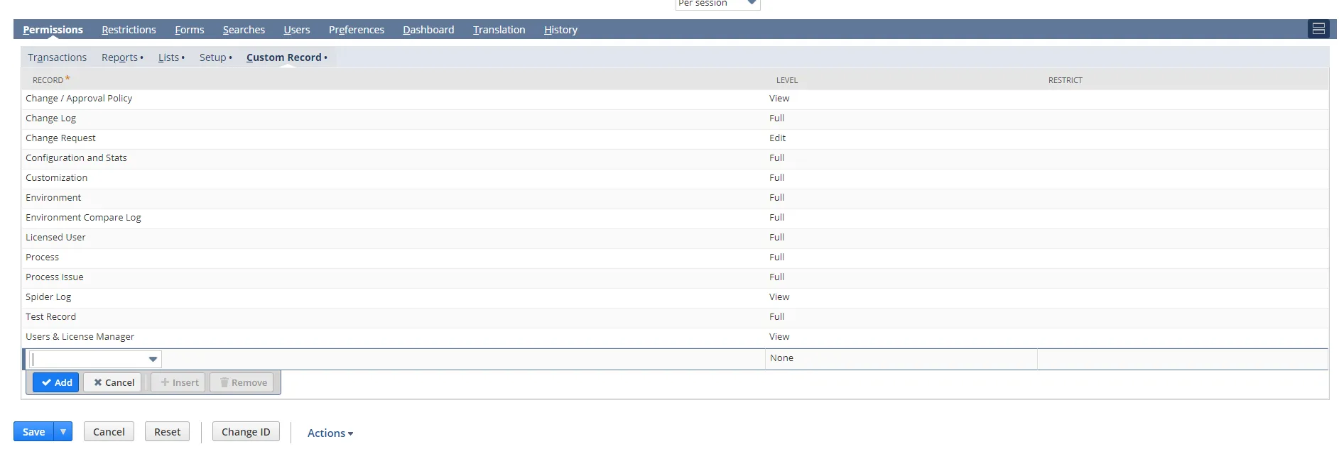

To use Platform Governance for NetSuite with your custom roles, add the record types to the permission list for each role. The Strongpoint roles have the correct access levels by default.
Open Setup > Users/Roles > Manage Roles
Edit each custom role your targeted Users use for their tasks.
Open the Permissions tab.
Open the Custom Record tab and add the Record Types and access levels to your custom roles.
Adding permissions to a role affects all employees who have the role assigned to them.
Refer to the lists of Custom Permissions needed for each role: Change Request Approvers, Manage ITGC, Manage SoD, User Access Review (UAR) and Manage Internal Audit - View Only.
The default settings are shown in the Default Custom Record Types and Permission Lists and Default SoD Custom Record Types and Permission Lists tables. -
Save the Permissions.

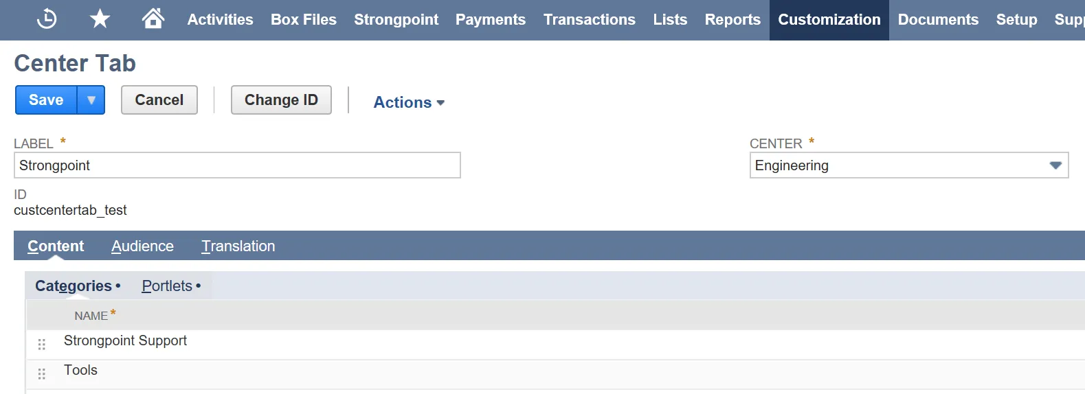

Creating a Copy of Classic Center
This procedure makes a copy of the Strongpoint Classic Center tab that is preserved through bundle updates. After you create the copy, you must add all of the appropriate category links prior to Setting Permissions.
Open Customization > Centers and Tabs > Center Tabs
Click Edit by Strongpoint
Select a different Center
Click Save a Copy
Leave this window open so you can see all of the categories.
This example shows Engineering as the new Center -

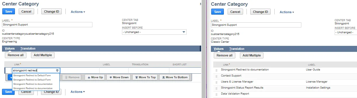

Create the Category links:
Open Customization > Centers and Tabs > Center Categories in a new window.
Click Edit by the Label of your first category (Strongpoint Support in the example) and your selected Center Type (Engineering in the example). -
Open Customization > Centers and Tabs > Center Categories in a second new window.
Click Edit by the Label of the same category and the Classic Center version. -
Add each Link and Label in your new Center, using the Classic Center version as a guide. A drop down completion list is shown as you type. Click Add after each addition.
When complete, click Save in your new Center and Cancel in the Classic Center.
Click Edit by the next Category in your new Center and the corresponding Category in the Classic Center and continue adding the links.

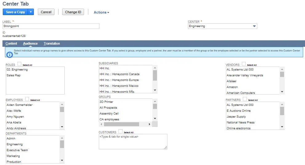

Setting the Audience
Click Edit by Strongpoint and the correct Center Type (Engineering in this example).
Open the Audience tab.
Assign the audience. This can be role(s) or specific employees.
Click Save
