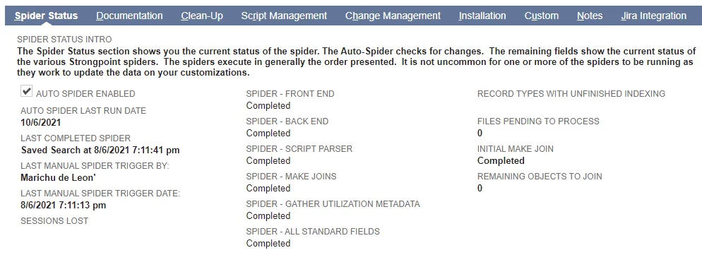

Confirm the Spider is Complete
Open Strongpoint > Strongpoint Support > Installation Settings and review the Spider Status tab to confirm the Last Completed Spider shows a date.
- Strongpoint Record Server Side Spider Scheduled Script is no longer running.
- Strongpoint Search Customization to Make Join (By Join Proc) should not have any results. If there are items in the results, it indicates the Strongpoint Make Joins Script is still running.
