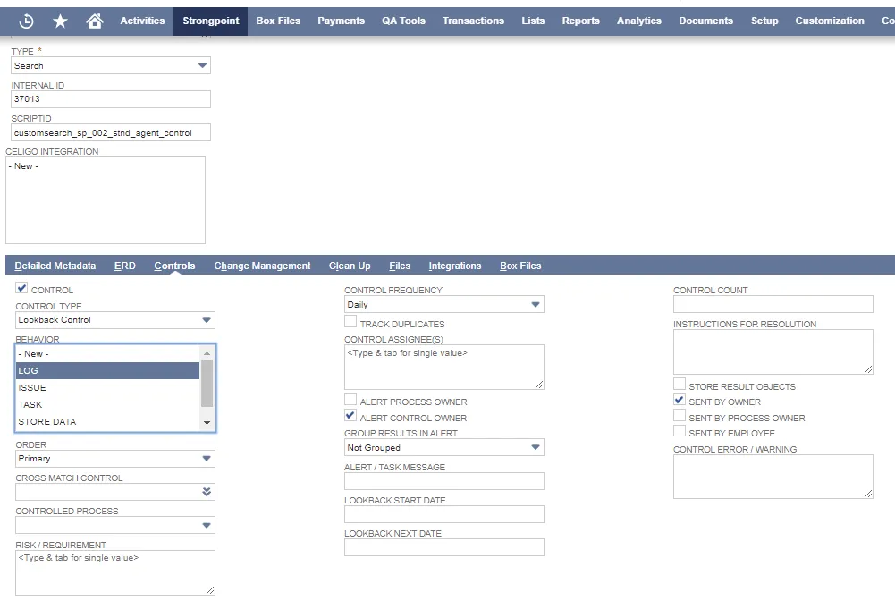

The Agent Lookback is accessed from the Customization record for the control.
  1. Open Strongpoint > Financial Controls > Controls.
  2. Edit the control to run.
  3. Open the Controls tab.
    New Agent Lookback
  4. Set Control Type to Lookback Control or Lookback Control with Admin Verification.
  5. Click Go to Record.
  6. In the Filter drop down, select User Fields. Select a date such as Date Created. The first date in the filter becomes the lookback start date.
  7. Add the details and click Set.
  8. Click Add .
  9. Click Save.
  10. The Lookback Start Date and Lookback Next Date are now populated on your Customization record.
  11. Save the customization record. The Lookback agent runs single day batches for the specified dates.

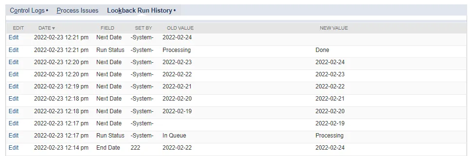

Lookback Run History
The Lookback Run History tab is available on the Controls tab on a Customization record.
View the Lookback Run history.

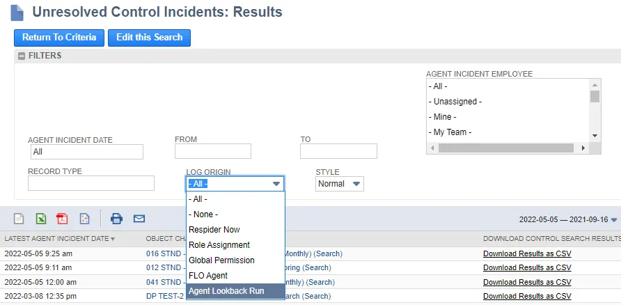

Lookback Run Incidents
You can filter your Control Incidents reports by setting Log Origin in the report Filters. Agent Lookback Run is available as a filter option.
Filter Incident Results on Lookback Run
