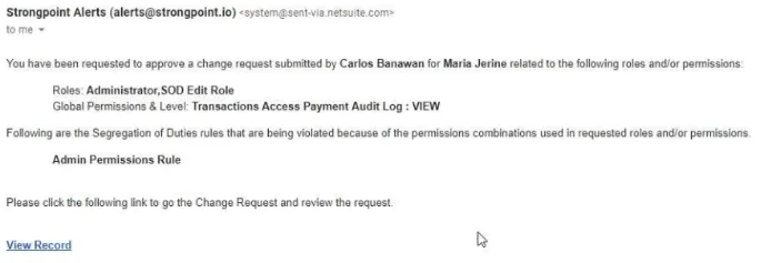

  5. After a change request is generated, Strongpoint for NetSuite sends email to the approvers. The email shows the requested change, the SoD violations, and links to the change request.
    sod_email_msg
