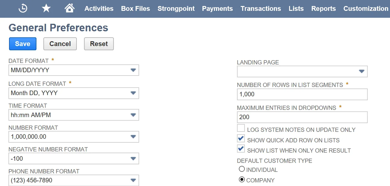

When setting the Number of Rows in List segments, sometimes the field cannot be edited.
To resolve this:
- Open Setup
- Select Company.
- Select General Preferences.
- Set the Number of Rows in List Segments to 1000.

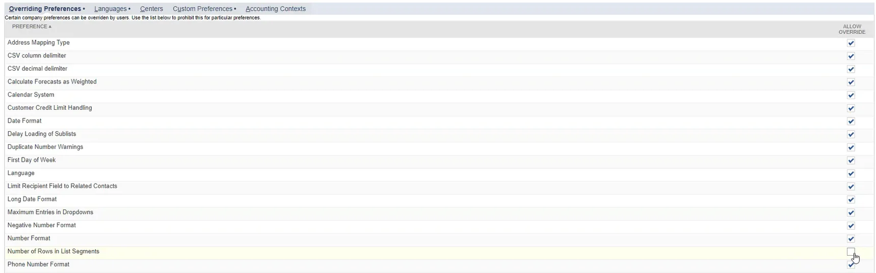

If the field is still gray:
- Scroll down the page to the tab Overriding Preferences
- Check the box for Number of Rows in List Segments.
