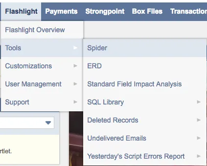

Open Flashlight > Tools > Spider.

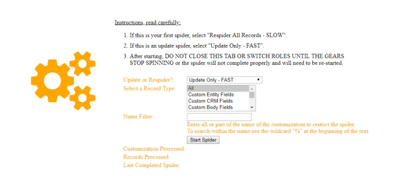

Set the following fields:
- Set Update or Respider to Respider All Records - SLOW.
- Set Select a Record Type to All
These values are required to document the entire account for the first time.
Click Start Spider. The gears start spinning to indicate the spidering process is running. The initial indexing process takes approximately 25 - 40 minutes. The indexing status is displayed at the bottom of the screen. You can see the specific customizations being processed and documented. Once the indexing is complete, you can close this window. From this point forward, Flashlight's scheduled scripts take care of the remaining documentation process over the next 3 - 5 days.
A confirmation email is sent when the spider is complete. The notification includes instructions on how to use your system documentation to manage your customizations and to keep your account running smoothly.
NOTE: During the initial indexing process, you must keep this window open, do not switch roles, do
not switch accounts and do not logout until the gears stop spinning, otherwise the process stops and
you must restart the spider.
Internet connection issues can also interrupt the indexing process. If the indexing continues over
an hour with no progress, you must restart the spider.
