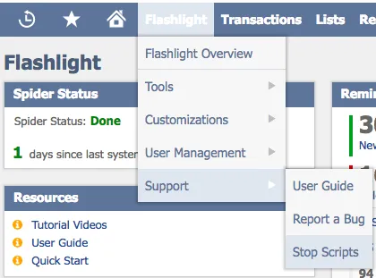

Stop Scripts
You can stop the Spider scripts at any point during the spider process:
Open Flashlight > Support > Stop Scripts
This stops the next execution of the scheduled scripts.
Stop Scripts
