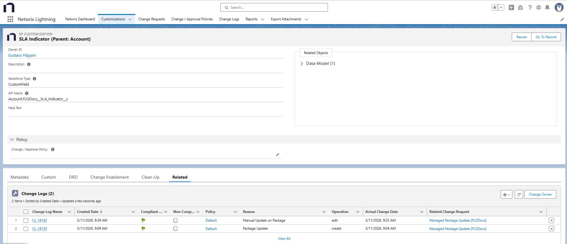

Setup Audit Trail entry​
Setup Audit Trail entry for delegate user
Customization record​
Customization record showing owner

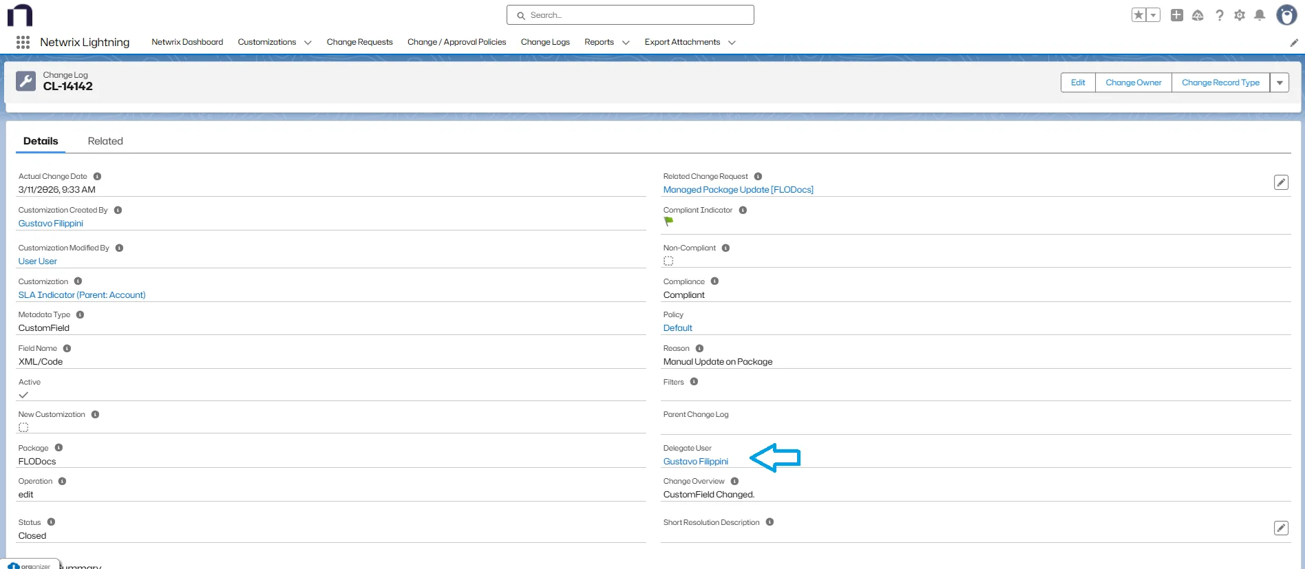

Change Log showing Delegate User​
Delegate User in Change Log
This allows you to differentiate between:
  • The original administrator
  • The user who actually performed the change
