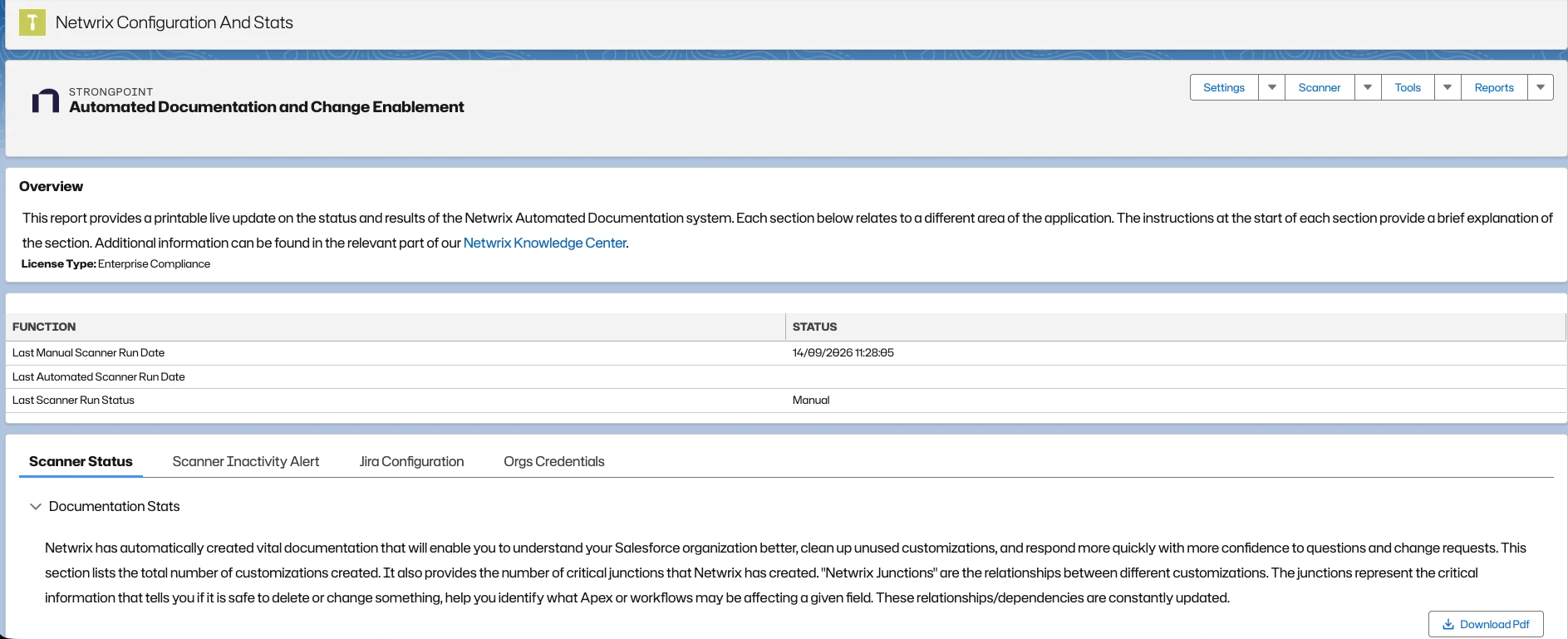

Documentation Stats​
This section displays the current status of the documentation Strongpoint for Salesforce has created for your account. The statistics included the total number of customization, and the various junctions created to track the relationships between customizations. junctions represent critical relationship information to help you determine if it is safe to delete or change something, and how it affects other items. Click Download PDF to export a copy of the report.
Configuration and Stats - Documentation Stats

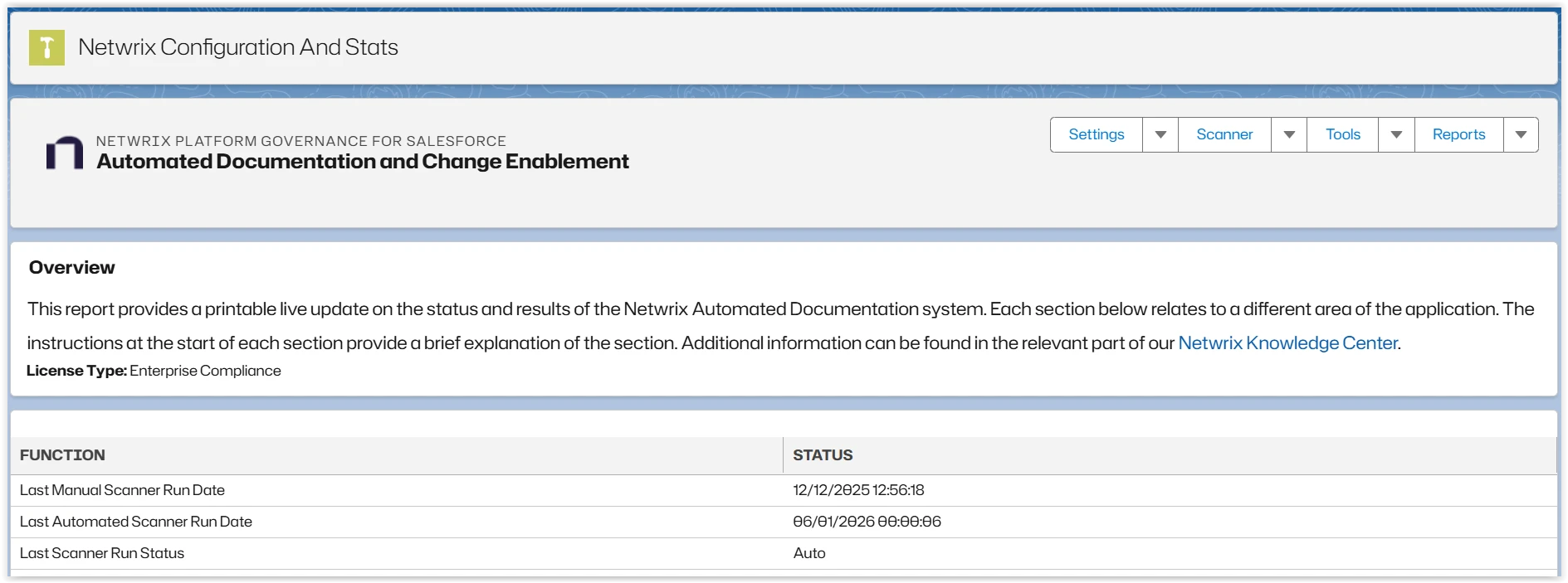

Scanner Additional Information​
This section only applies to sandbox orgs. It displays each scanner function and the status:
  • Last Scanner Run Date: The date and time when the scanner was last run manually.
  • Last Automated Scanner Run Date: The date and time when the scanner last ran on its automated schedule.
  • Last Scanner Run Status: Indicates the type of the most recent scanner execution (manual or automated).
Configuration and Stas - Scanner Additional Information

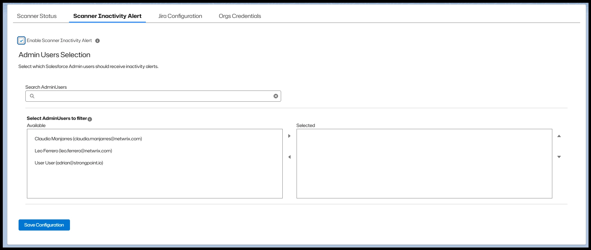

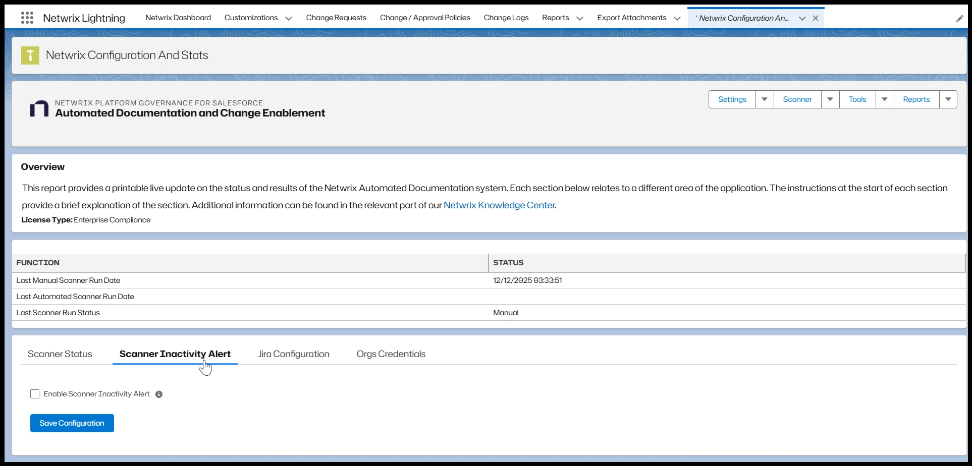

Scanner Inactivity Alert​
The Scanner Inactivity Alert feature provides automated email notifications to designated administrators when the Auto Scanner fails to run according to its configured schedule. This proactive monitoring ensures that your Salesforce environment remains continuously protected.
Scanner Inactivity Alert Section

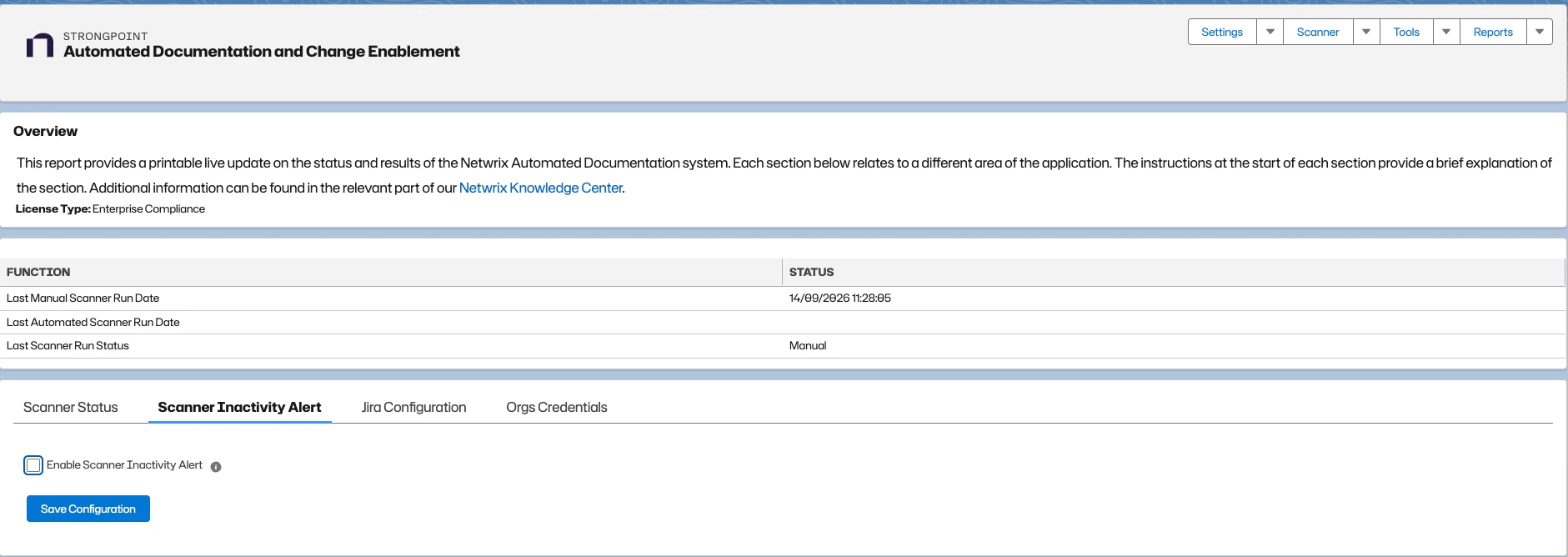

Configuration Steps​
Step 1: Enable Scanner Inactivity Alert​
  1. Locate the Enable Checkbox
    • Find the checkbox labeled "Enable Scanner Inactivity Alert"
  2. Enable the Feature
    • Select the checkbox to enable scanner inactivity alerts
    • Once enabled, the Admin Users Selection panel appears
Step 2: Select Admin Users​
After enabling the alert, configure the recipients.
Admin Users Selection Panel​
A multi-select list displays available administrator users.
Select Recipients​
The system lists all Salesforce users with the System Administrator profile.
Use the multi-select panel to manage recipients:
  • Search: Type to filter admin users by name
  • Select: Click a user to add them to the recipient list
  • Remove: Click a selected user again to remove them
  • Multiple users can be selected
Review Selection​
  • Confirm all intended recipients are selected
  • For redundancy, consider selecting more than one admin
Step 3: Save Configuration​
Save Settings​
  1. Click Save Configuration at the bottom of the page
  2. A loading spinner appears while the configuration saves.
  3. Wait for the confirmation message.
Alert Trigger Conditions​
The system continuously monitors the Auto Scanner and sends email alerts when it detects that the scanner isn't running as configured in the scheduler.

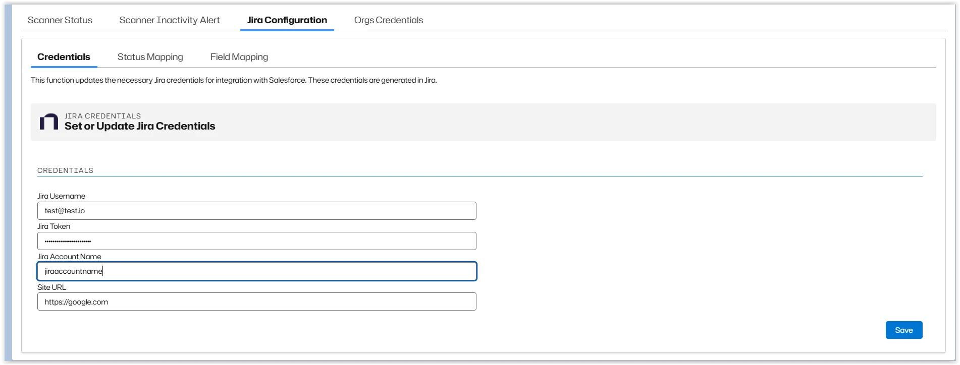

Credentials​
Generate your credentials in Jira, then enter them here for the Strongpoint for Salesforce Jira integration.
  1. Open Netwrix Dashboard > Settings > Configuration and Stats.
  2. Open the Jira Configuration tab. It opens on the Credentials tab.
    Open the credentials
  3. Enter your credentials:
    • Jira Username is your Jira login email associated with your Jira API token.
    • Jira Token is your Jira API token. If you don't have your token, follow the steps in the Atlassian documentation.
    • Jira Account Name is the company specific part of the Jira site URL (https://_JiraAccountName**_.atlassian.net**). Only enter the JiraAccountName, not the entire URL.
    • Site URL is https://site.force.secure.com
  4. Click Save.

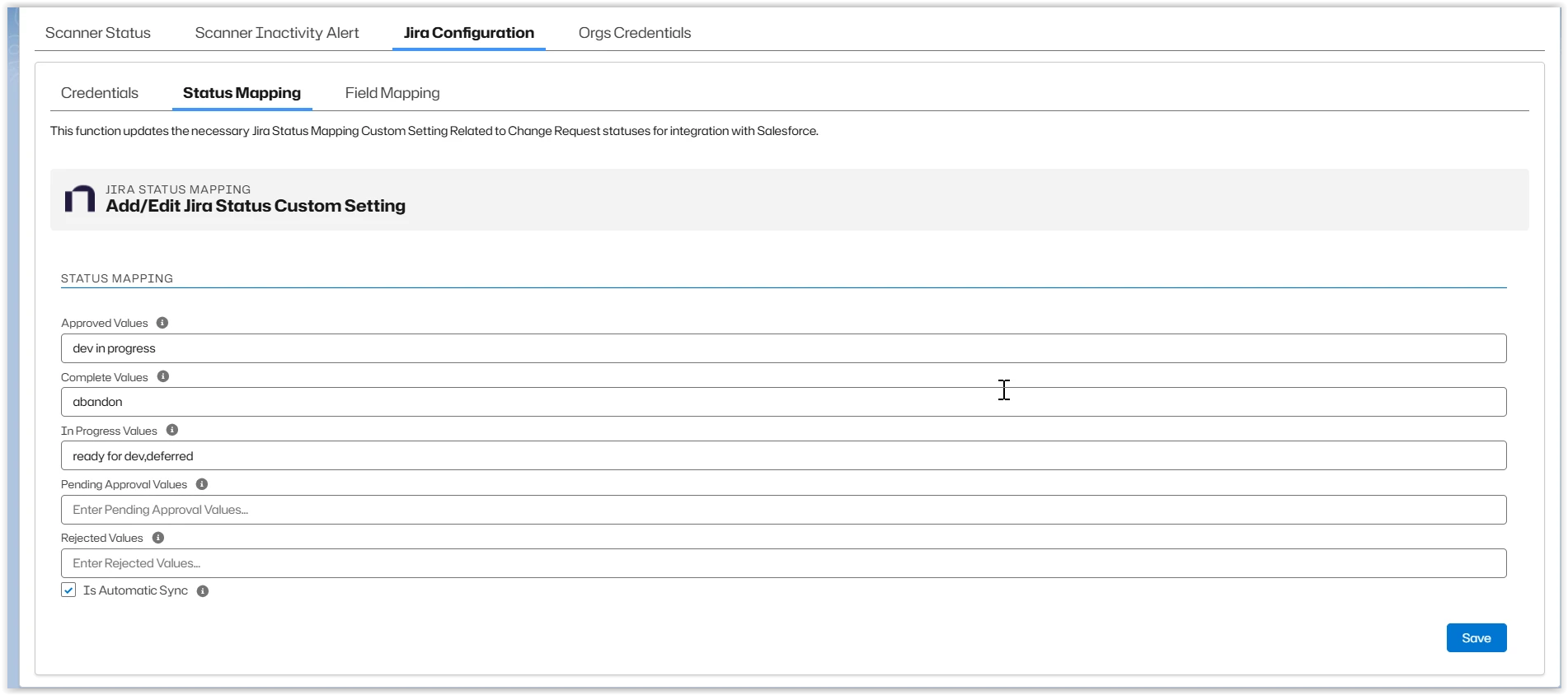

Status Mapping​
  3. Open the Status Mapping tab.
    Set up the Jira status mappings for Change Request status
  4. Enter the mappings between your Jira statuses and the Change Request statuses. You must define your Jira statuses before this step. You can enter multiple Jira statuses for each Change Request status, separated by commas. For example, In Progress, Backlog. Assign your mapping for each of the Change Request statuses:
    • Approved Values
    • Complete Values
    • In Progress Values
    • Pending Approval Values
    • Rejected Values
  5. Check Is Automatic Sync to enable Strongpoint for Salesforce to handle the synchronization between Jira and Salesforce when a Ticket status is updated to a mapped status. without clicking Push. If you are using an org where you don't want to create a Change Request, leave this unchecked so you can do your research or testing without generating Change Requests.
  6. Strongpoint for Salesforce doesn't automatically create Change Requests, because not all tickets result in a Change Request. Tickets must be pushed to Strongpoint for Salesforce to begin the process. When Automatic Synchronization is on, Strongpoint for Salesforce synchronizes changes to the Status and Customizations between Jira and Strongpoint for Salesforce without manually pushing changes.
  7. Click Save.

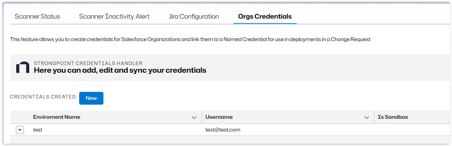

Orgs Credentials​
Create credentials for your Salesforce orgs and link the a Named Credential Change Request deployments.
  2. Open the Orgs Credentials tab.

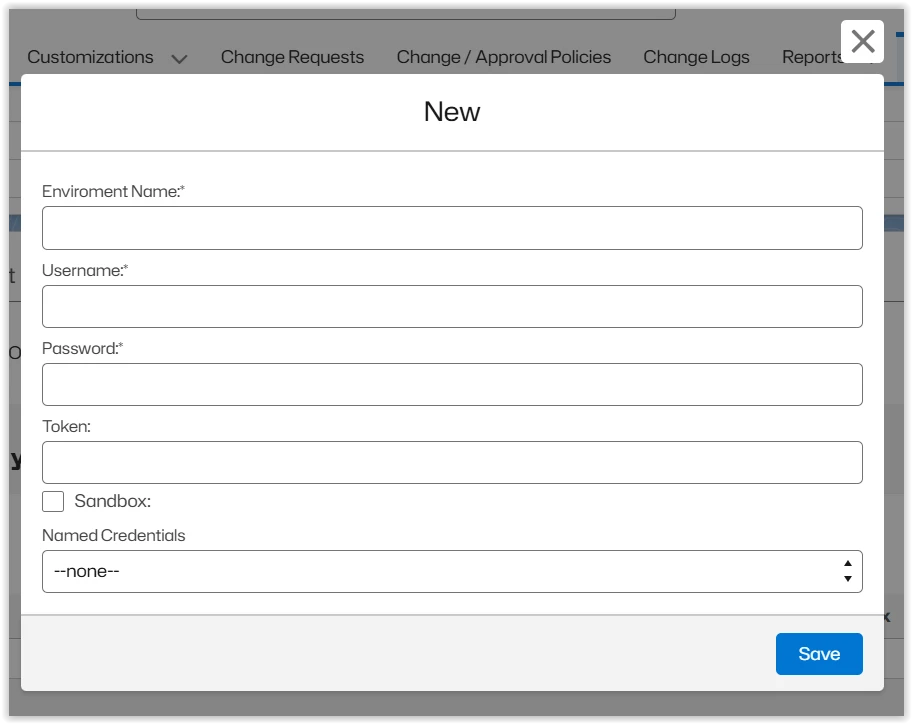

    Orgs Credentials
  3. Click New to enter new credentials. For existing credentials, you can click Edit to modify the credential, Delete to remove it, or the credential name to sync your credentials.
    New org credentials
  4. Click Save.
